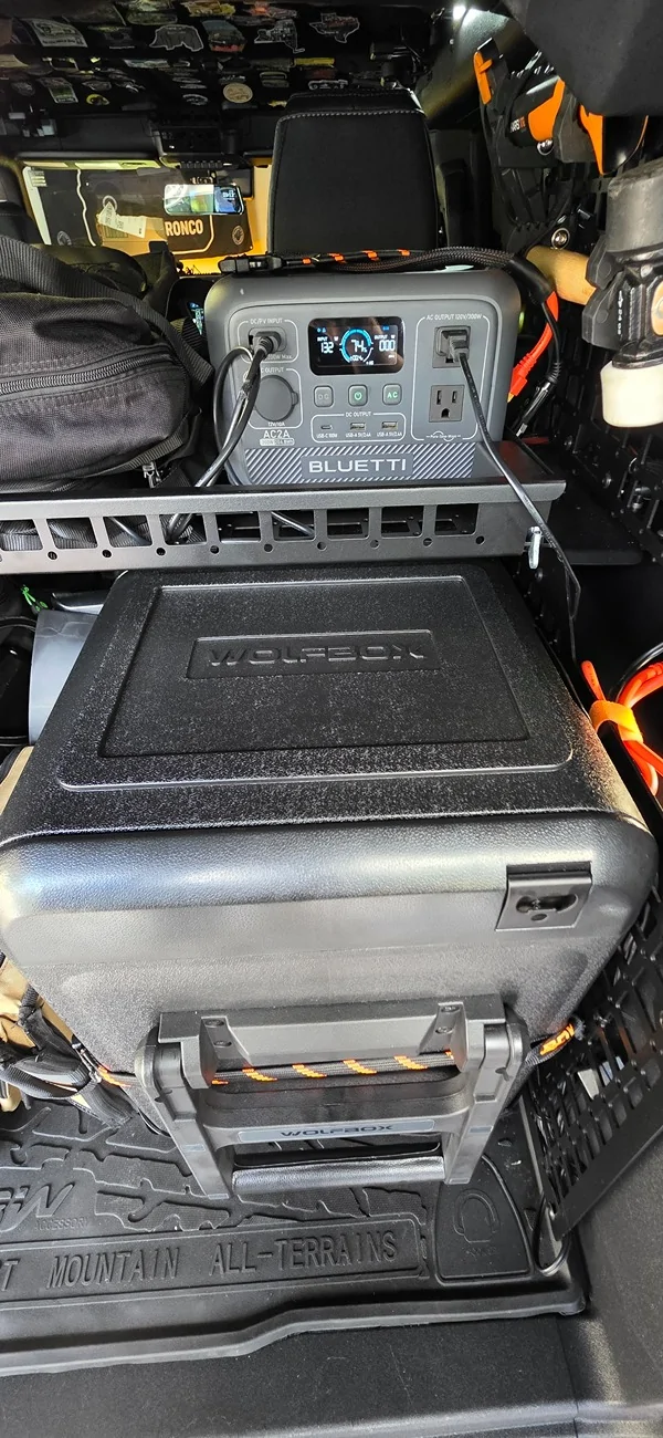

I run a Wolfbox fridge paired with a Bluetti setup. If you’re using the Wolfbox rearview cam system, the fridge integrates right into their app, which is pretty slick. The Bluetti has its own app as well, so you can monitor power, draw, and battery status independently.
For longer trips, I keep both a small and large Bluetti on board. The big unit stays fully charged as a standby for camp, and the smaller Bluetti stays plugged into the truck’s 12V to power the fridge while driving. I also keep a DC inverter on hand to recharge if needed, and so far the setup has been rock solid. For quick runs around town, the small Bluetti plugged into the 12V is all I need.

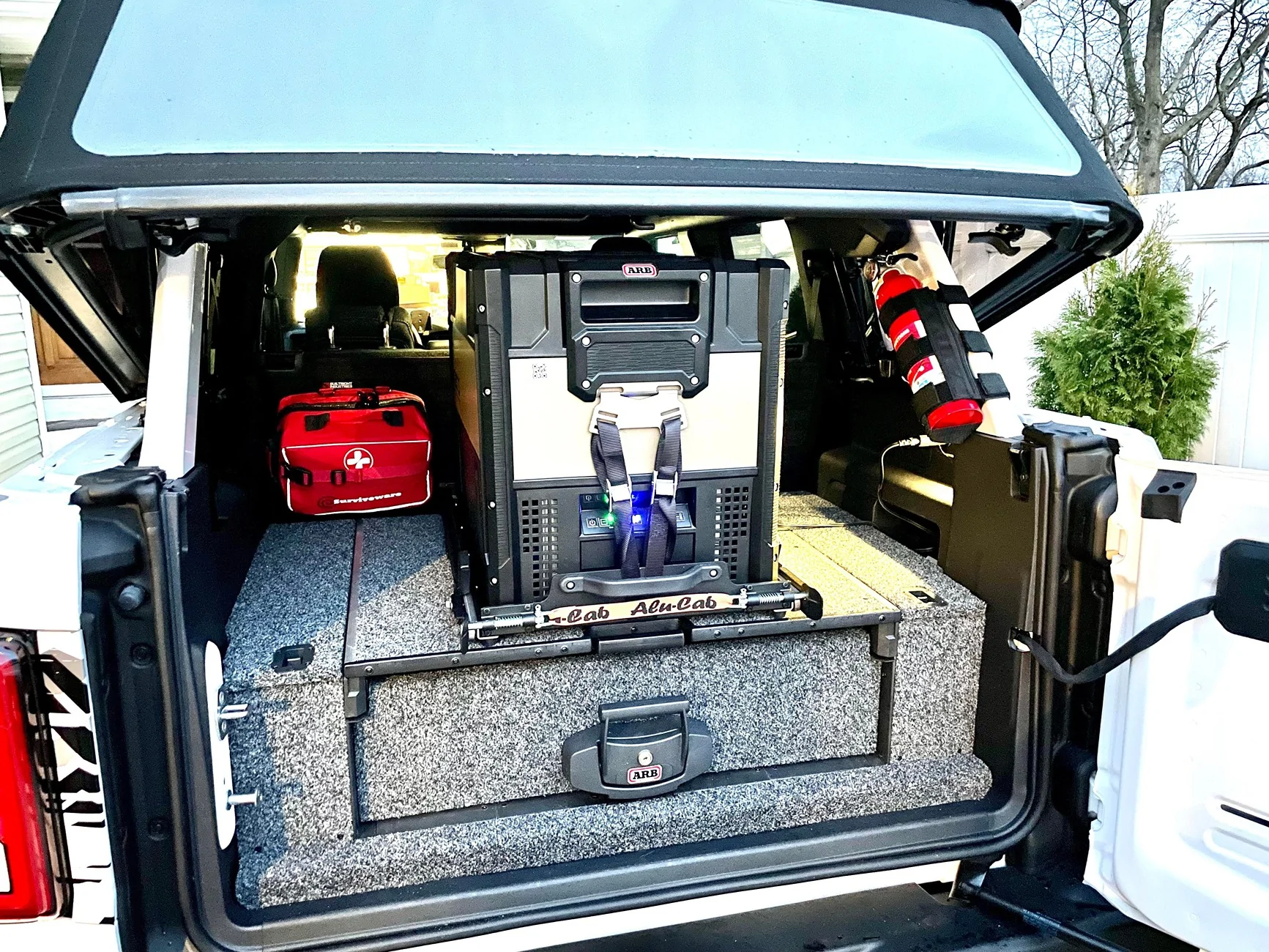

Go with the ARB Fridge/Freezers: https://www.4x4truckleds.com/other-truck-accessories/fridges-freezers/
I ran one in my Bronco they are fantastic. They operate on 12VDC or 120VAC. There is an included 120VAC plug so you can bring your fridge/freezer in with you if you stay at a hotel or want to pack it up the night before and power it inside overnight. Or you can power it with the included 12VDC plug that has a cig plug on the end, which plugs in right in the rear of the bronco.
I actually connected my 12V cig plug to a Bluetti portable battery bank. And then the Bluetti portable was plugged into the broncos cig plug. This way my bluetti powered the fridge 24/7 and when I was driving the bluetti was being charged. I also had a solar panel kit i'd use when I was parked to also charge the bluetti when I was not driving.
