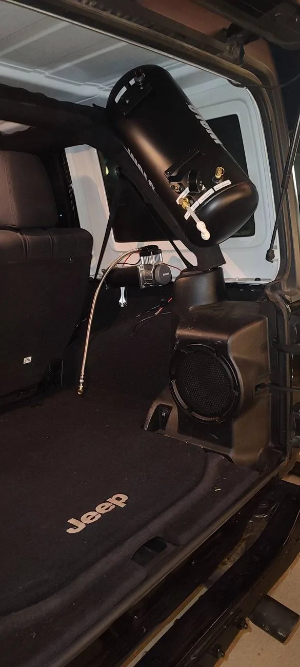

I just got my Bronco back in February, but I had a Jeep with an OBA system for about 7 years. I started with this ( https://a.co/d/0C52pSO ) but I separated the pump from the reservoir. I kept the pump in the cargo area and custom mounted the tank on the roll bar. If I had it to do again I would definitely mount it under the hood though as it is loud when running. I would say this pump is the bare minimum to pump up a set of 37s.
I upgraded the pump to the Smittybilt 5cfm model and it was perfect for 37s. My issue with the Smittybilt is the non-standard metric threads and the j-spec quick connects. Also the "cooling fins" are plastic. Anyway if you have the know-how, the Smittybilt is a more capable compressor than the Wolo I linked above, but it has its shortcomings. Now that I'm not running 37s, I am working on a mount for the Wolo pump and looking to hide a one gallon tank on the inside of the frame rail. Probably this one: https://a.co/d/cWcR6TH
This was my Jeeps setup and having the air tank on the roll bar was pretty cool. Got asked all the time if it was nitrous lol... but using an old blue NOS bottle might be fun. Part of me is tempted to do a similar tank mount and just relocate the pump under the hood
Ford Bronco Looking for budget compressor and inflator&deflator combo 20201126_202826

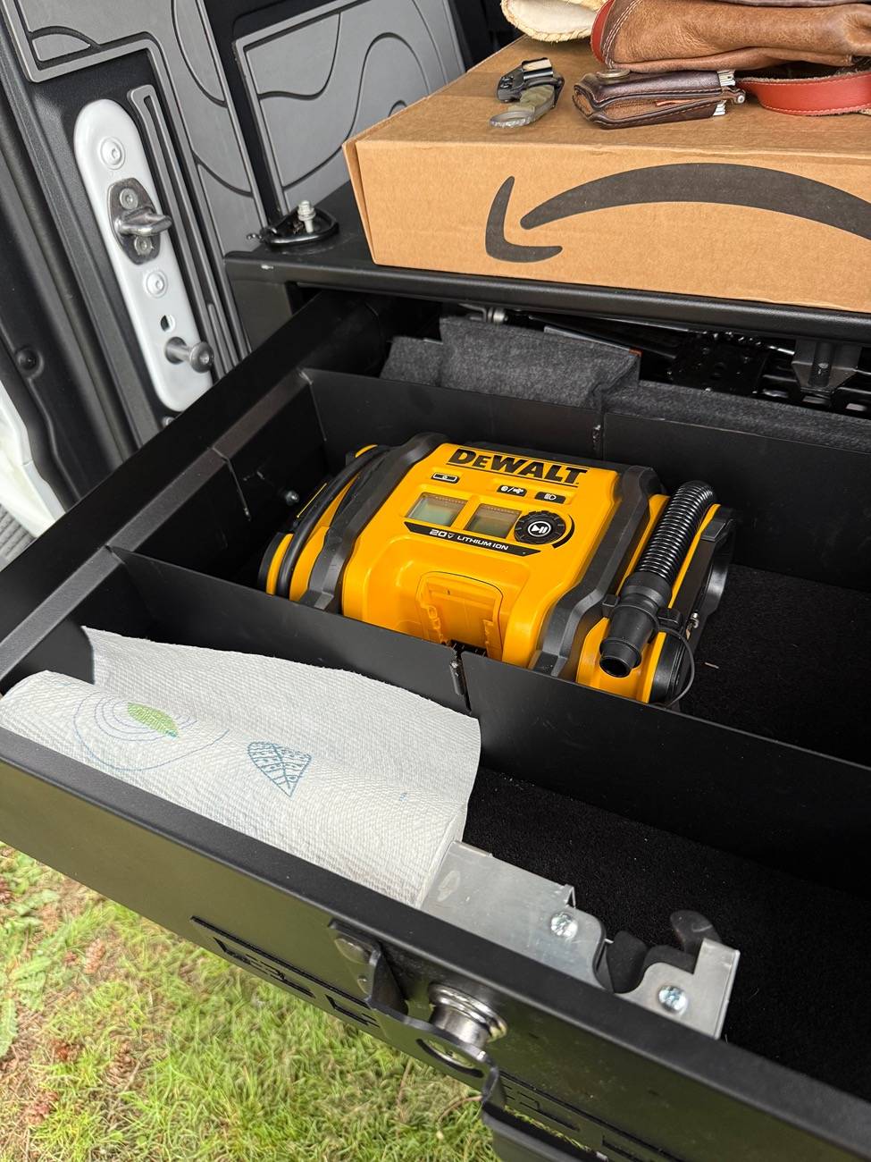

I think the choice if you do battery powered is somewhat up to your needs. My personal opinion of battery pack tools I generally think Milwaukee is best, but I already had some dewalt stuff so I’ve stuck with the brand for the interchangeability of batteries to all my different tools.
Sure, like others have said, battery powered isn’t going to stand up to a dedicated system. But it doesn’t sound like you’re running beadlocks and airing down to single digit psi. I would think a battery powered would do the trick, and you have the convenience of using it around the house, or taking it in other vehicles on trips. Just some food for thought. The dewalt I can set the pressure I want and let it inflate and auto stop. Has the ability to run off battery or a power cord. Attachments for vehicle, multiple bike, as well as high volume hose for filling things like rafts/air mattresses, which is great for me for camping/fishing.

Yea I’m definite not an off roading maniac, I am debating between the Milwaukee and the dewalt one, but seem capable and the dewalt does have tha vantage of auto stop. Do u just keep it in the trunk or do u have like a dedicated mount on a molle plate somewhere?
