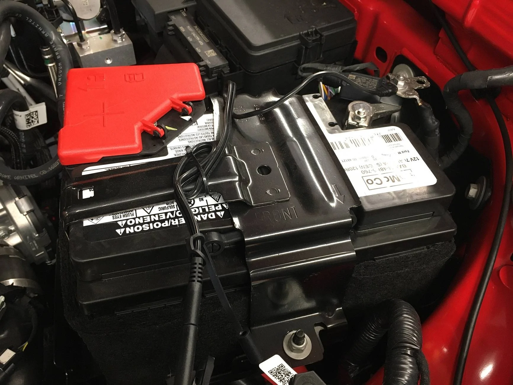

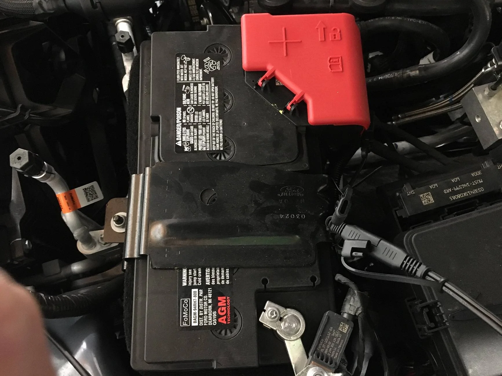

I have two 2024 Broncos with mid-packages.
That means they both have an inverter and AC 110V/400W outlet at the rear of the center console, paired with an inverter under the console.
However, the trucks have different batteries, and different hold-down straps. Why?
I can understand Ford having two battery suppliers (I assume they do). But not requiring different hold-down straps.
The simpler strap atop the larger battery, per Ford parts, is for Broncos with inverters.
Both trucks have inverters, and yet one has a smaller battery, and a hold-down strap with a tack-welded side piece limiting how far the battery can be mounted towards the engine.
This smaller battery's hold-down is listed for Bronco's without an inverter, though I have an inverter.

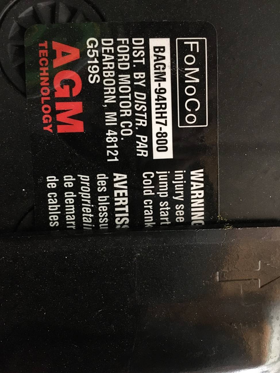

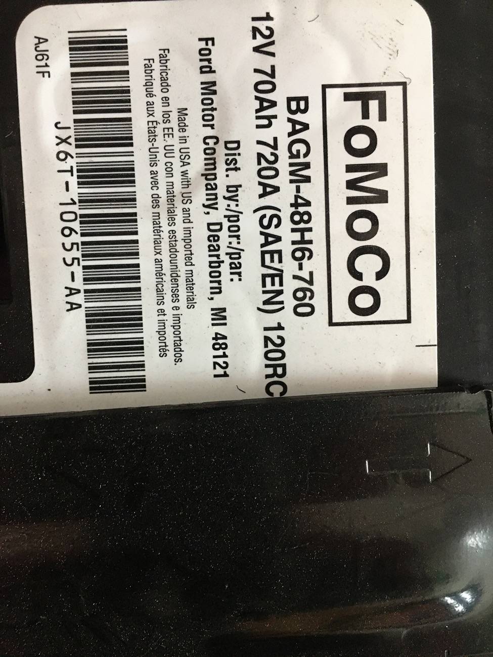

BAGM-48H6-760 AGM?, 70AH/760amp, LxWxH 10.84 x 6.825 x 7.41
BAGM-94RH7-800 AGM, 80AH/800amp, LxWxH 12.285 x 6.825 x 7.41
Without power inverter - https://www.fordpartspros.com/oem-parts/ford-hold-down-clamp-mb3z10a666a
With power inverter - https://www.fordpartspros.com/oem-parts/ford-hold-down-clamp-mb3z10718a
(Battery tray MB3Z-10732-A is same for both)
Given both trucks are mid's with inverters, I don't understand why both trucks don't have the larger 800 amp battery.

Everglades has the larger 800 amp.
I can't locate the tag on the alternators (to confirm same or different) due to there being so many other parts crowding around it.
The 800 amp battery looks like a higher quality product.
The 760 amp is off-gassing. Acid fumes are clearly present.

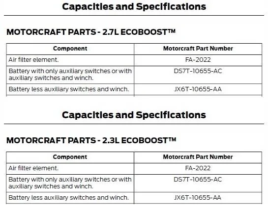

Does the heritage have the auxiliary up fitter switches? I believe the Everglades comes with them. It’s an option on the heritage. Could it be possible the up fitter switches is the call for the larger battery? Just guessing.

From the Owners manual, the battery is different if you have the aux switches or the aux switches and a winch vs neither of them.

If that’s true, even as an add-on option, the auxiliary switches were already a bargain, they are REALLY a good deal if you get the bigger battery with them.
