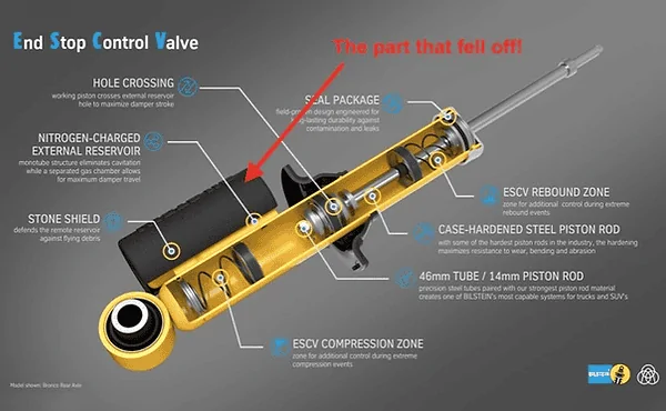

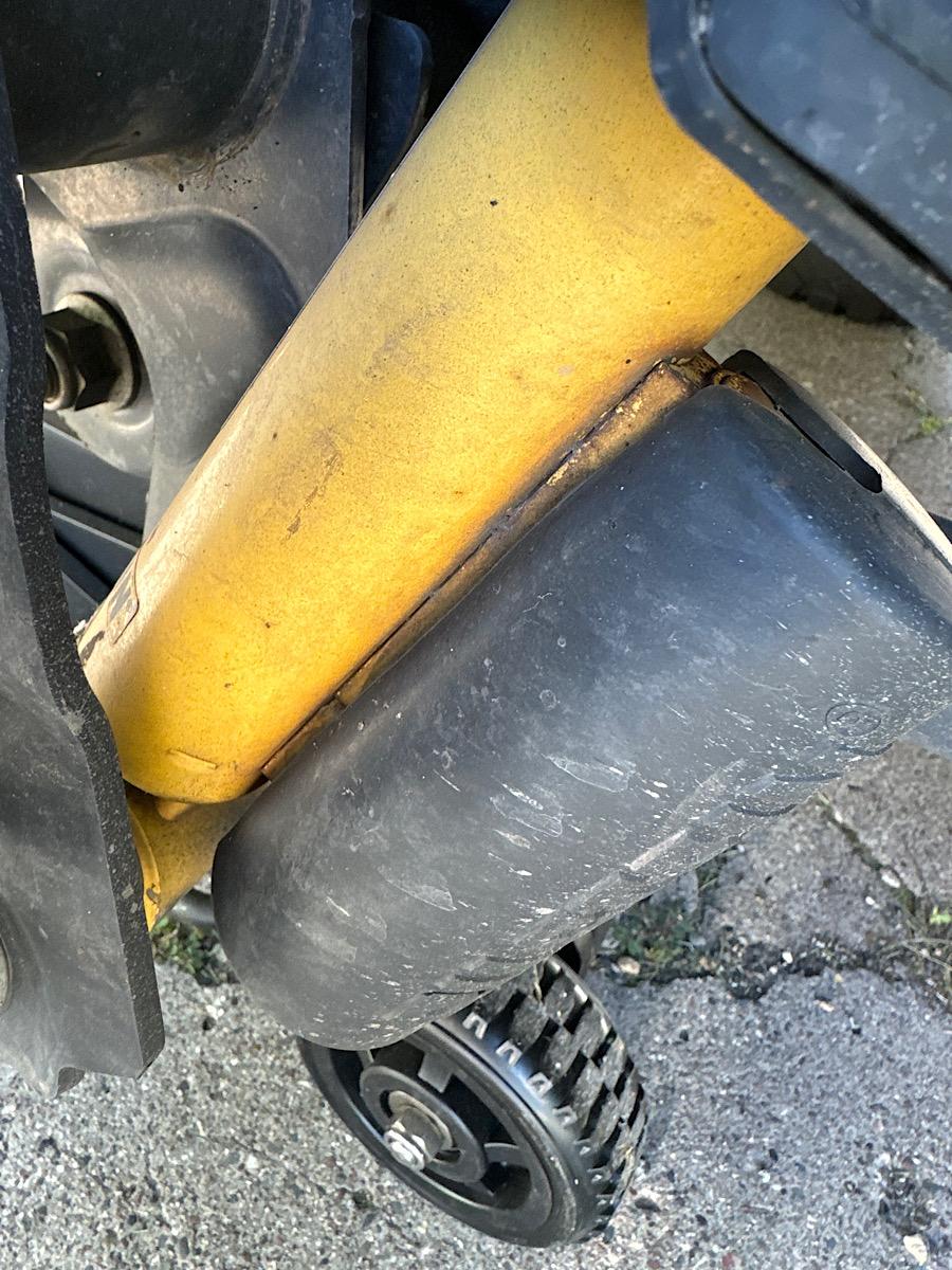

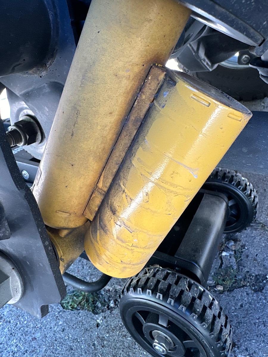

Both technically incorrect.
The black piece saying "BILSTEIN" is a plastic sleeve that covers the reservoir. Probably protects from small rock strikes but I bet it also traps moisture exacerbating the issue.
This is my '23 bought late July 2023. So only one MN winter on them, and I am religious about winter carwashes that spray the underbody off from salt and grime during the winter months.
Already rusting in the gap bewteen rezi and shock body. I spray some oil on them to try and prolong the inevitable.
I'd ditch the plastic and put a metal hose clamp around the shock and reservoirs.
