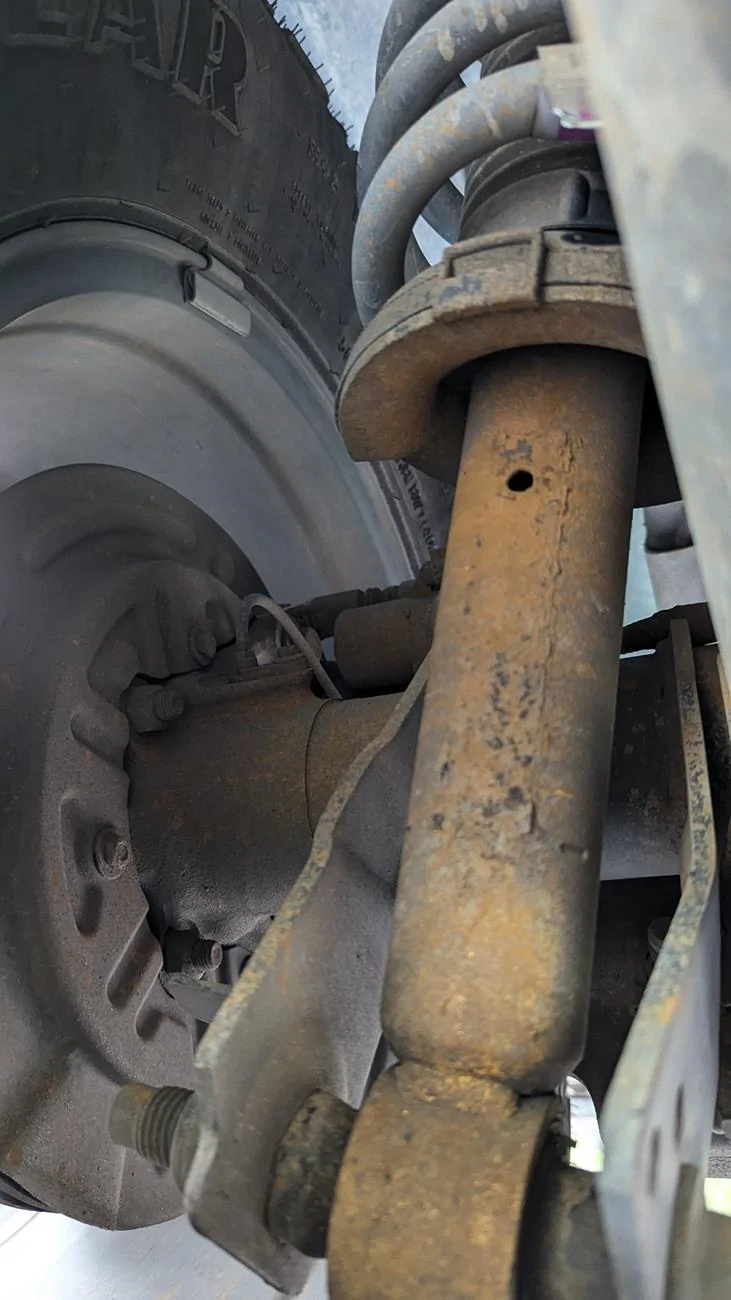

I tried to find the exact quote for a "shock replacement" (the dealership suggested keeping the rest of the original equipment like spring, top hat etc) but it was a hard copy, I remember roughly $650-$700. As I have a similar nasty original shock (image attached) and expect the other to join it soon I started shopping around.

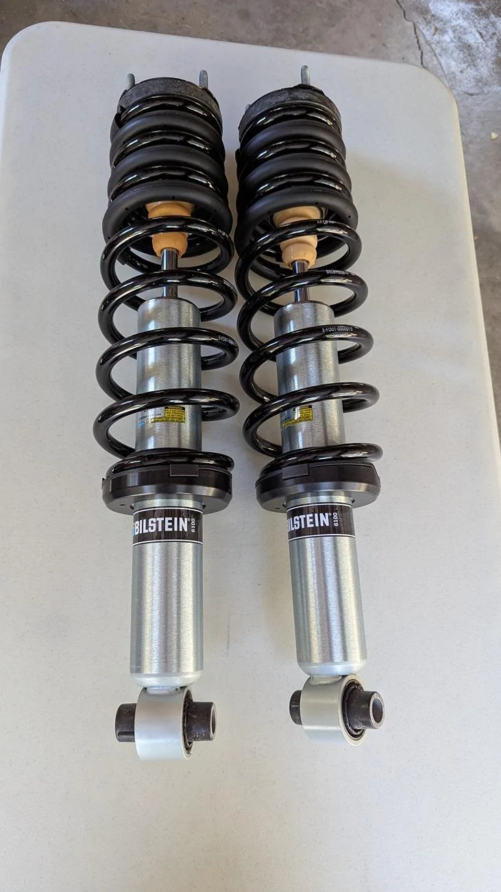

I landed on Bilstein 6112s in a pre-assembled strut (I don't want to mess with springs) from Shock Surplus. The parts landed at $826 and assembly at $350, however my hope is the upgrade will be noticeable and it will buy some more time before the next squeak arrives.
The "$650-$700" was for parts & labor of switching out the springs, etc?
I assume the "assembly at $350" was for install on to the vehicle, as 6112's came pre-assembled, correct? And was that just for the rear, or all 4? Im guessing just rear based off the price.
I'm thinking about getting the FP upgrade rather than just replacing with the same part that will likely have the same problem.

It's a WT? So 21/22? There is an issue with the reservoirs rusting and falling off these years (I don't think 23's are as affected, and of course the Fox's that also come in WT's 22/23). It's been reported multiple times. They're not great shocks. Recommend the Bilstein 6100's if you're not too put off by it (most seem to blame Ford's probably chintzy design specs and lack of quality corrosion protection, since Bilstein makes a lot of good shocks).
I am sorry, I see the confusion with my awful English and rambling. Two Items;
  • The "$650-$700" was from the dealership quote. Included parts (1-new Shock and a few bolts) and the labor to install. To address only the problem of one destroyed rear shock.
  • The $826 and $350 discussion was related to what I got from Shock Surplus [Rear Pair]
    • $826; Bilstein 6112 Strut & Spring Rear Pair for 2021-2024 Ford Bronco 4 DR 4WD w/0.3-2.8" lift
    • $350; ASSEMBLY CC1 (0.3") × 1 [So I can install on my own as one complete Strut]

The Bilstein 6100's (6112's for non-Sas) or the Eiback Pro Truck 2.0 I think are fairly straight forward installs (the 6100's keep the geometry the same AFAIU). Of course there's a lot of other options, but these are what I'd look at when going with new shocks and wasn't going bonkers (8100s or Kings/ADS).

As FYI, I replaced my Hitachis with Ford Performance "tunned" Bilstseins kit after a first desert trip and very happy with them. They are not on the soft side but provide a solid platform when you feel to push them a bit.
