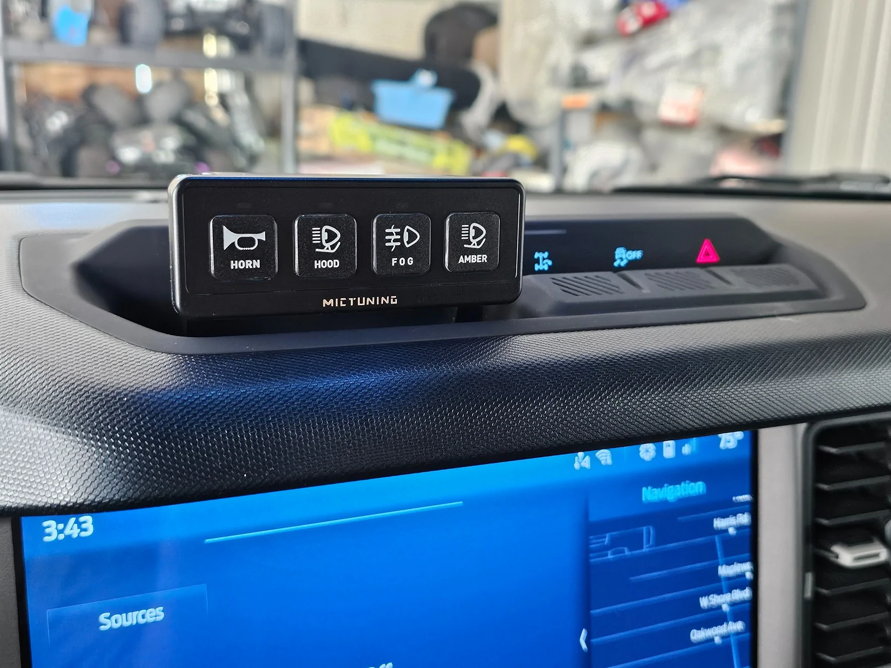

I went with a wireless 4 switch pod after having 3 switches dangle for a couple years. Like you I have a OBX Lux non-squatch and no aux or hero switches.
This came from MICTUNINIlG
BA40/BA60 Wireless Switch Panel 4 Gang/6 Gang, Up to 164FT Range, 12V https://share.google/qKsOhem3SI96vQFF0
Ford Bronco Before I put a hole in the dash somewhere..... 1000018004

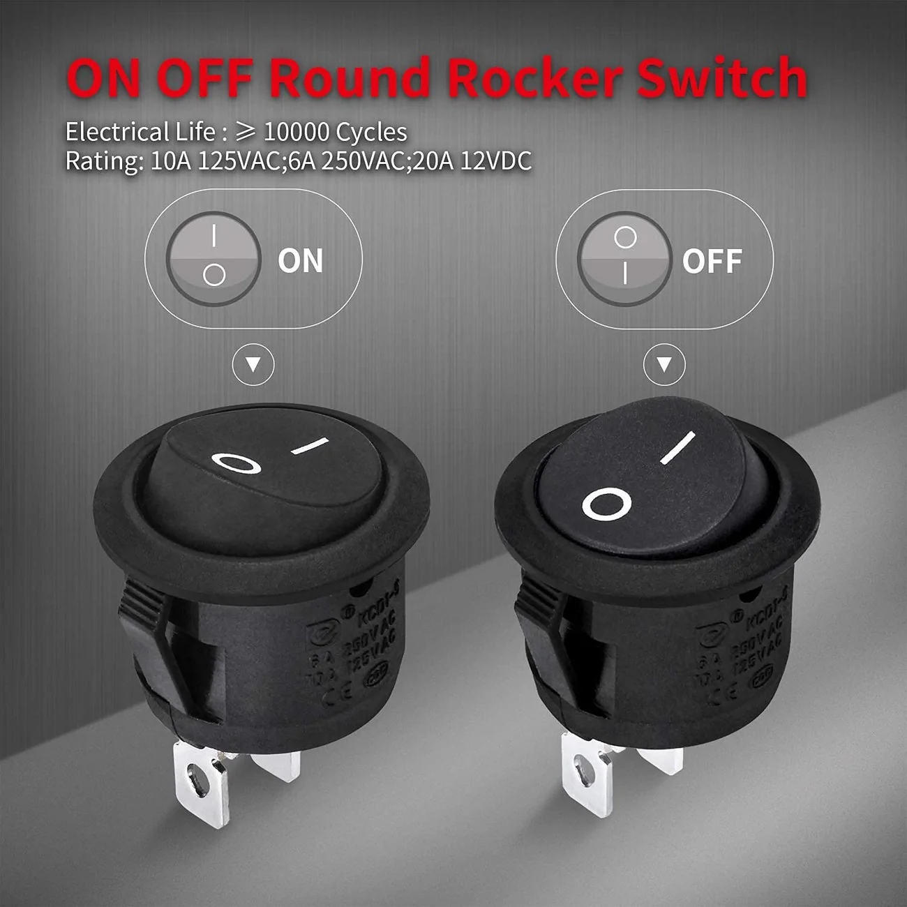

I think something like this mounted near your headlight switch will be unobtrusive, easily accessed, and not too out-of-place when seen. Bonus: this is a very low-cost solution.
Ford Bronco Before I put a hole in the dash somewhere..... IMG_3809
Yea, it requires a hole, but any option that doesn't is going to be something that has a very add-on look, or will cost as much as the OEM switches. The above switches are just a few dollars.
