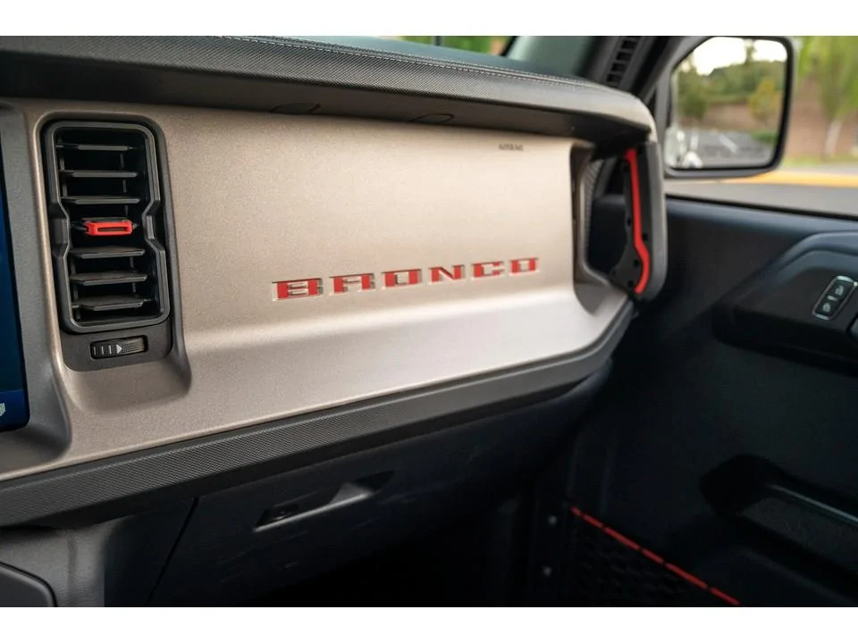

Anyone know whats behind this dashboard blank panel ?
How much clearance there is and how much access there is to the backside?

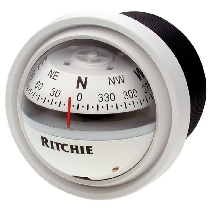

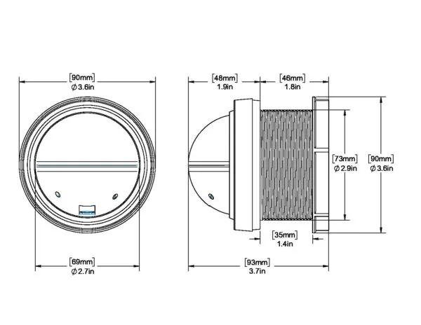

Im thinking of drilling a big hole and mounting a compass - but its around 2"+ deep on the back.

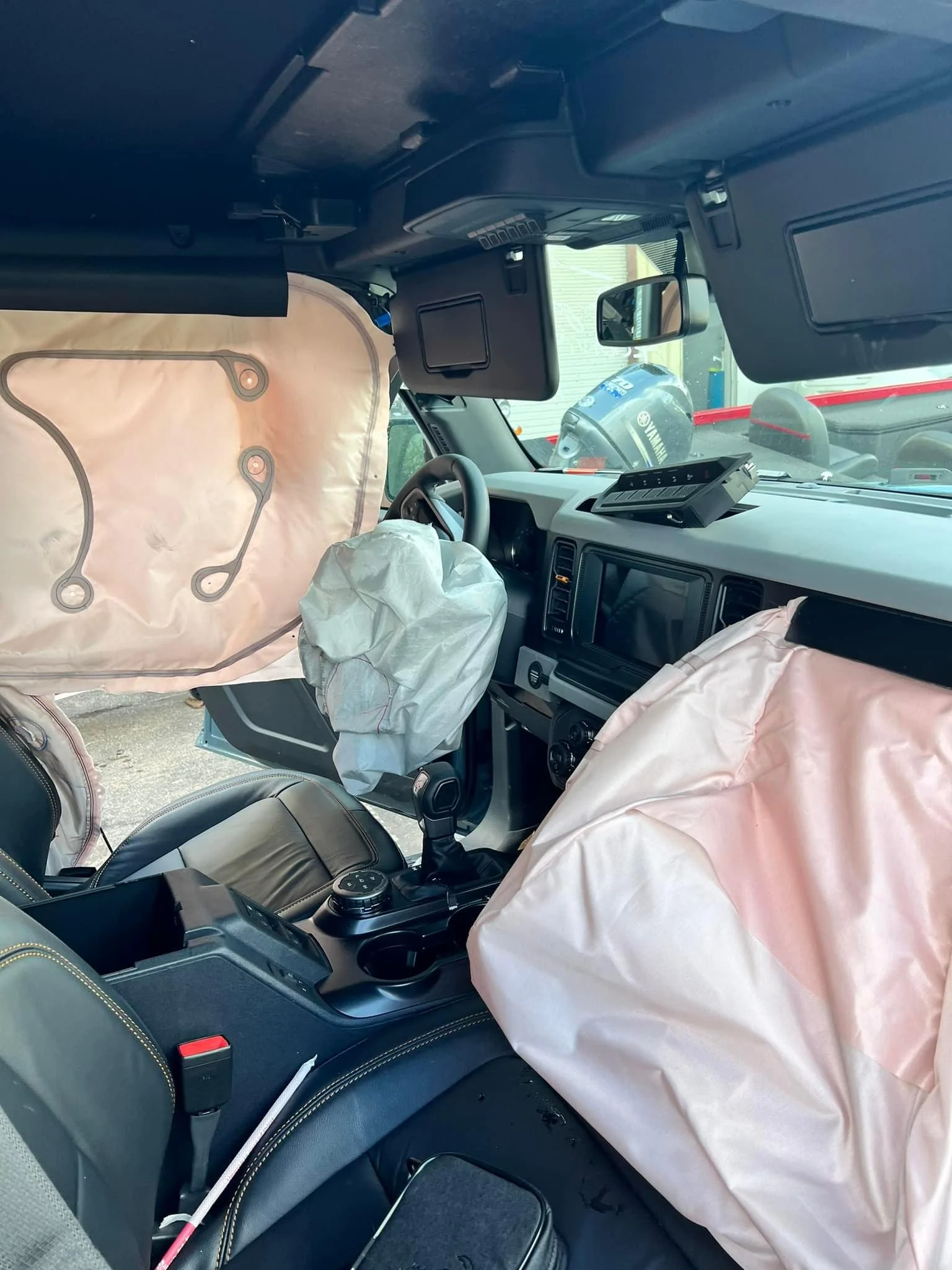

crap - for sure? I thought they were in the A Pillars
100% for sure. Look in the upper right corner of that panel. It says "Air Bag". You also have them in the pillars.

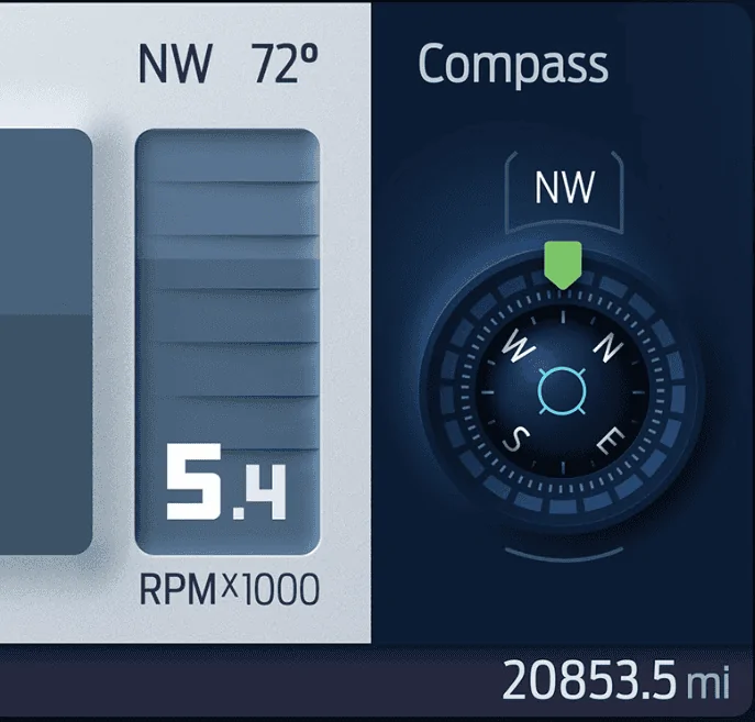

Why??? when the Bronco has this....
Come on man, this forum is chock full of people who don't like them new fangled computer things. Sometimes I think the bronco should come with tin foil hats :)
