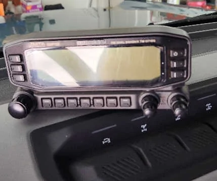

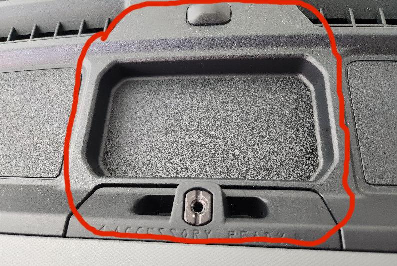

I need to run a Cat5 cable from my radio control on the dash to the main unit on the passenger side console. Where can I drill on the dash to run this cable?
Any help would be appreciated. Rick

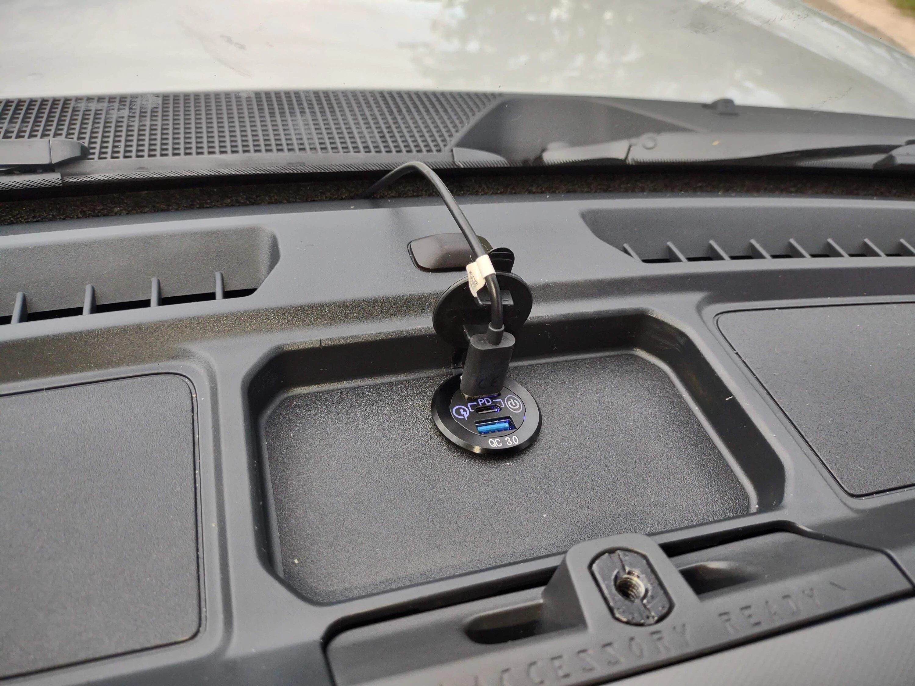

That whole area underneath is hollow if u don’t have the lux package speaker there. I’ve done several USB hub installs, I usually just drill in the middle

If you want to see what you're doing before you drill, I'd suggest unscrewing the accessory mount panel and prying out the hero switch panel. You'll then be able to shine a flashlight under the tray you're drilling into to verify you aren't going to hit anything.

I loosened the top So I could see the underside, then hand drilled it with a tapered hole bit. It cut easy by hand. There isn't to much to getbin the way, but it was hard to feed the wires.
