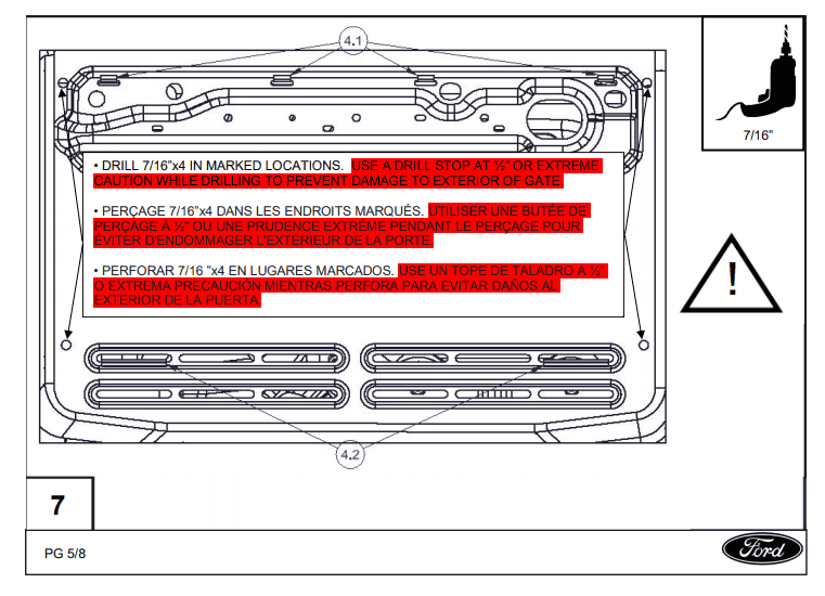

Are the taped holes already in the tailgate? Or is drilling required? If drilling is required, it is really easy to slip and hit the next wall behind the surface you are drilling.

I noticed this at a Florida dealer. It appears that the screws may be a bit long on the tailgate table install.

When I saw previous reports of this issue I figured it was the drilling step, or using an impact to set the screws.

Shorter screws or washers. Regardless, yet another fuck up from Ford.

I'm just wondering if it was the screw or did the drill bit hit the tailgate, I used to customize vans and trucks in the 70s and I've seen screws do this but I also saw this from drilling holes and hitting the skins of roofs with the drill bits 😉
