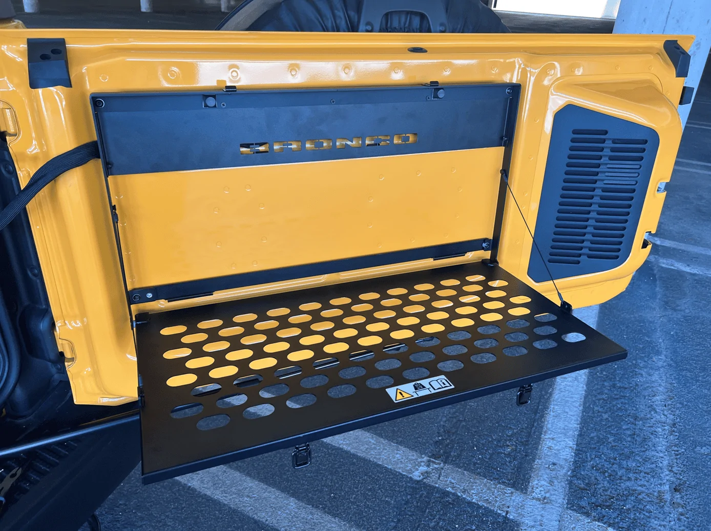

I used the jack nuts that came with the table for mine and they did fine. Made sure to torque them only to what was specified (6.3 lb ft) and turned out great.
Man drilling the holes was nerve racking. I took my time, quadruple checked each one, test fit after each one too to make sure it was all good.
Ford Bronco Tailgate table install 1654459251082
It is odd how Ford designed this as an accessory spot where we would remove the stock trim piece, yet cheaped out on the paint. In person you can see some of the unpainted area through the Bronco cut out.
I'm thinking of getting some vinyl in a color that either matches cyber orange or badlands orange to put behind the cutout and back it with a thin plastic piece or some scrap aluminum...

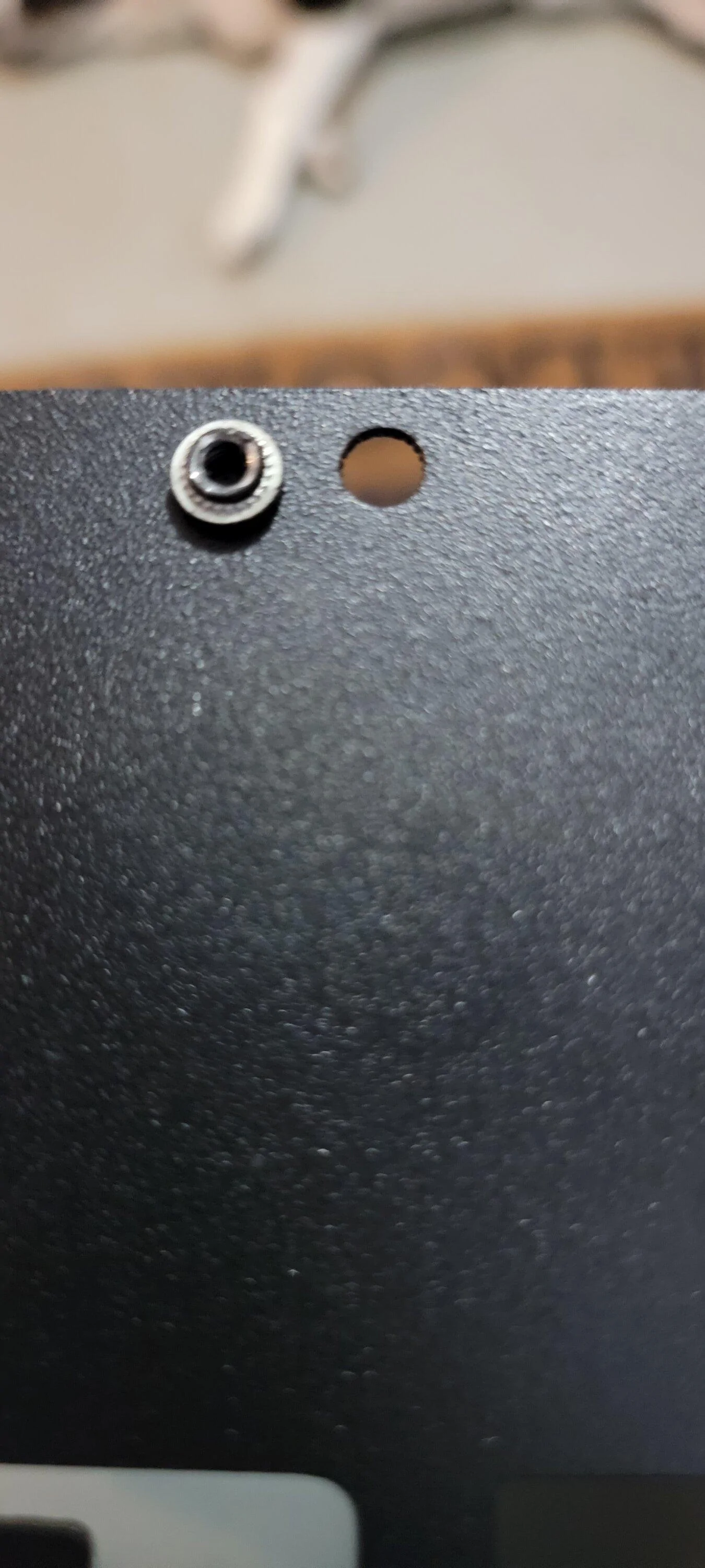

Sorry to dig up an old thread, but working on this install and ran into a snag. The supplied screws that are supposed to hold the frame to the Bronco top piece don't seem to fit into the nuts that are pre-installed on the Bronco top piece. Has anyone else run into this? Supposed to be the same screws that hold thr sides of the frame on with the lock washers.
