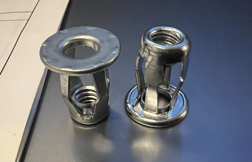

Any recommendations on how I fix this?
I overtightened the inner thread and it separated from the housing. Not sure if I can take out the housing and replace because its fully expanded, wish the instructions were a bit more clear that this could happen...
Don't want to resort to super glue. As everyone else has been saying, why the heck didn't Ford put some BRONCO bolts back here? I mean if there were any place to put them...
I had to drill mine out and get better ones from amazon....

I had this problem with one of mine, I ended up drilling all four of them out and replacing them with Metal Magery Steel Large Flange Short Jack Nuts from Amazon 1/4"-20 https://www.amazon.com/gp/product/B09HZBNPBF/ref=ppx_yo_dt_b_asin_title_o00_s00?ie=UTF8&psc=1
They seem a little beefier than the originals and I made dang sure I didn't over tighten the bolts.

Dang it, I sure wish I'd read this thread before I attempted install today. The same thing happened to me.
What size drill bit did you use to drill them out? Also, are the replacements 1/4" or 6/32"?
After this debacle, I hustled down to Home Depot to buy a torque wrench and socket hex set. This flippin' table is going to end up costing me double once I'm done with it. At least I'll have more tools.

I ended up ordering some of those from Amazon. They get here tomorrow, so hopefully I can finish this dang install.
I'd sure like to know how you drilled out the old ones. I tried that but the jack nut just spun in the hole. I had to mangle mine with some tin snips and needle nose pliers until I got the flange off. I was able to pull some of the rest out through the hole, but a lot of it just dropped into the door. Hopefully it's wedged in the insulation tight enough that it's not going to rattle around.
This is seriously turning out to be one of the more annoying installs I've ever done. I'm starting to regret ever attempting it now.

Finally finished the tailgate install... kinda. Installed the new jack nut received from Amazon today (fit perfectly) and finished with the rest of the table. Unfortunately, my right bottom bolt is just spinning which prevents me from tightening the table enough to keep the hinges fully secured. I'm going to have to remove everything and replace the other jack nut it looks like.
I swear, I've done I don't know how many upgrades to my Jeep from lights to new tops to tailgate table, side steps, etc., and nothing was as hard as this %&*@ table! If I hadn't already drilled the holes in my tailgate, I'd just throw this thing in the trash.

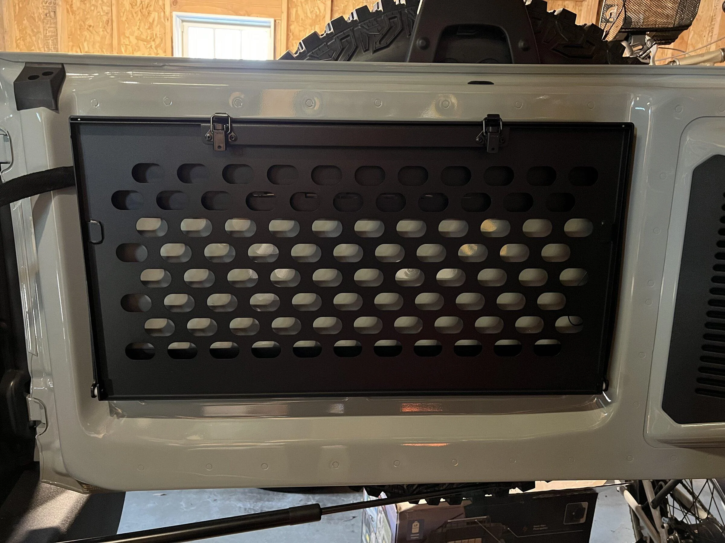

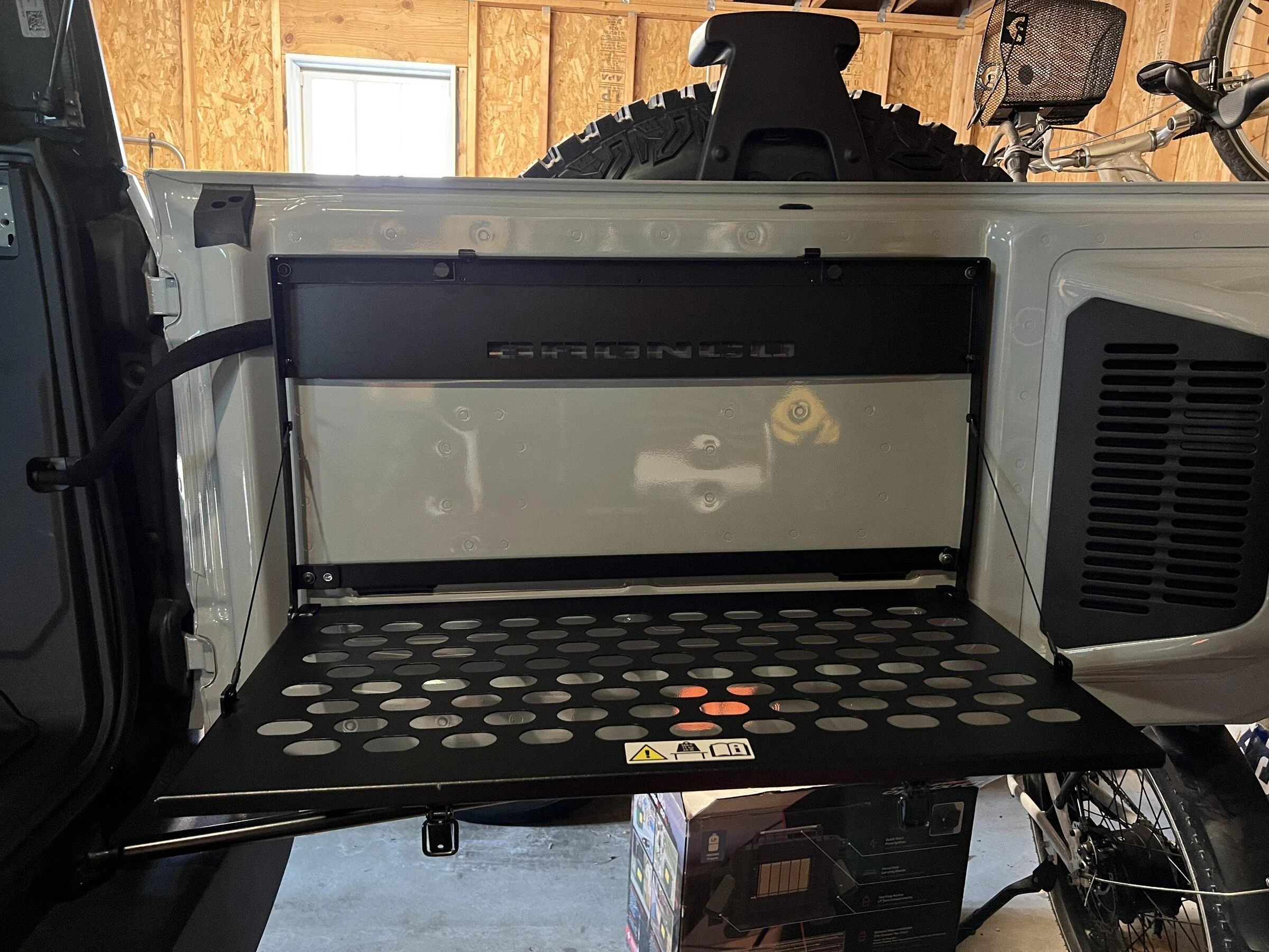

Well, I finished the install on mine but had to replace two of my jacknuts with the sturdier Hillman ones I bought off Amazon. Would've replace the other two, but they weren't broken and I didn't want to risk more debris falling down inside the door.
Now that I have the table installed, it's okay, but I'm not thrilled. For one thing, I'm not sure how sturdy it is with a 25 lb capacity. Also, the fitment wasn't quite right on mine -- once the metal brackets were installed in the tabs, the frame wasn't in perfect alignment so it resulted in one of the side brackets being somewhat bowed once everything was was mounted (you can see this if you look closely on the right side in the pictures). And then there's the crappy jacknuts. Not to mention the incomplete and sloppy paint job that Ford hid behind the plastic trim and which is now exposed through the BRONCO letter cutouts in the table mount.
Now that it's in, I'd rate it about 2.5 out of 5. Definitely a 1 out of 5 on installation. "Accessory Ready" my ass!
At least I'm not hearing any rattling when I drive, but I need to take it over some rougher terrain just to be sure.

I ended up replacing all the jacknuts on mine, a BIG difference. Anyone contemplating installing this just toss the factory jacknuts and buy the Hillmans. Save yourself the trouble and rattle.

Had the same prob with the jack-nuts as the rest of you guys. Ended up skipping the amazon jack-nuts and bought a set of 1/4"-20 riv-nuts. Seems much sturdier.

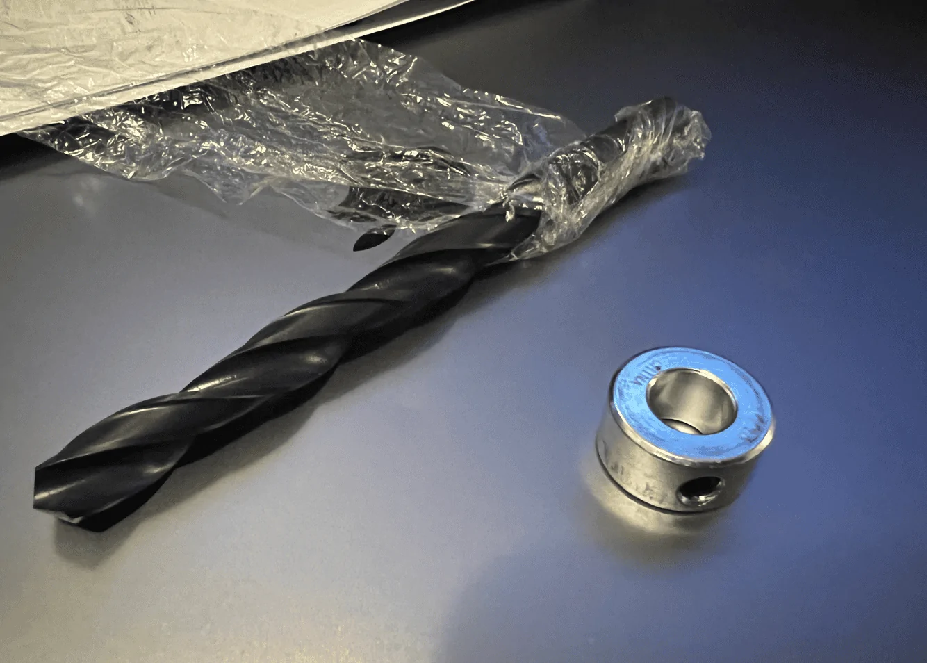

I just got a table today. A little bit has changed since the video at the beginning of the post.
The kit now includes a drill bit and drill stop.
Not sure if anything else is different. They might have updated the instructions on applying the rubber strips.
Do the jack nuts look the same?
