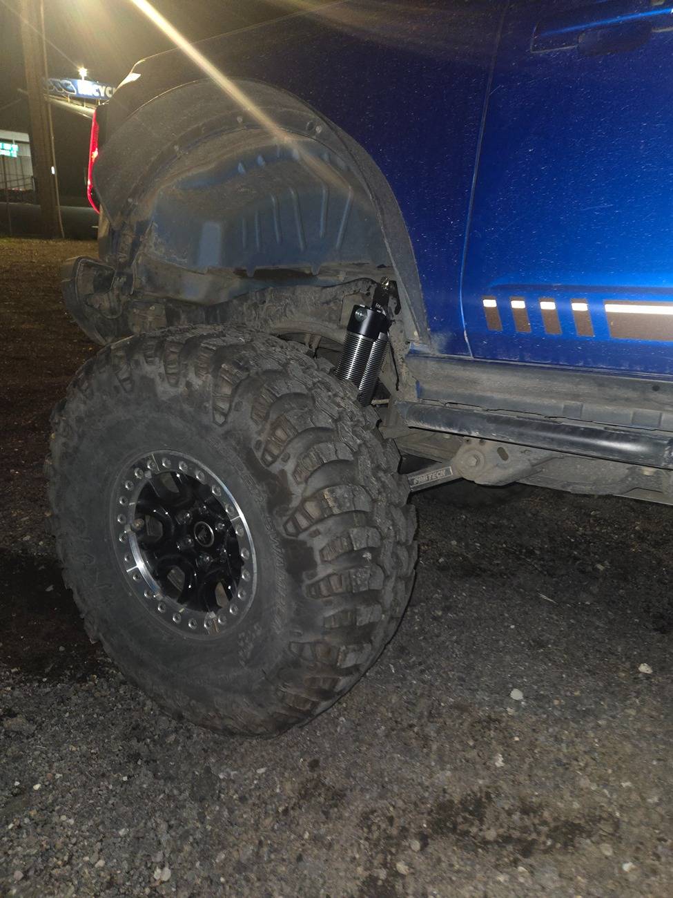

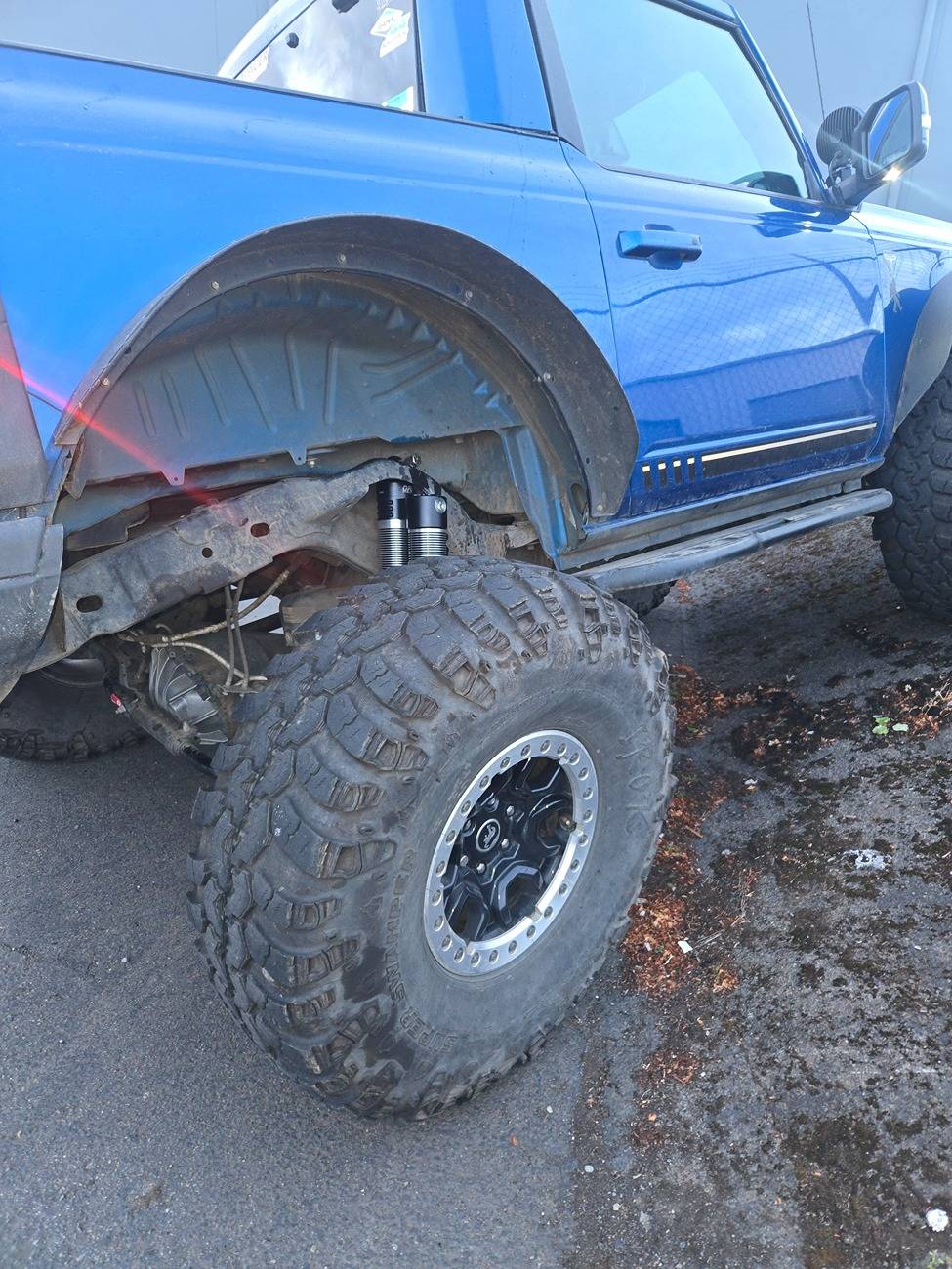

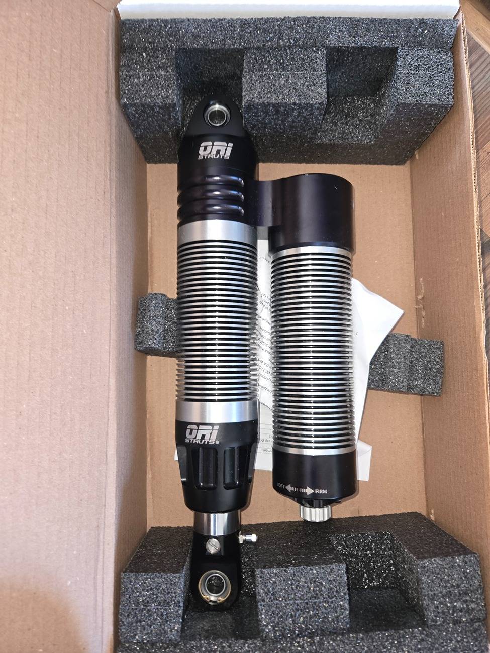

Here's what I'm doing, mine are on the recall list...And they have minor rust....so I called Ford customer service line, and explained my rear struts are junk, and Im tired of waiting for this "remedy" and I DONT need a lawsuit for my reservors falling off and killing someone, So Ford AGREED to open a case and gave me a case number to use later....I also told them I was buying aftermarket Struts and would be sending them a bill for the rear replacement ones (I bought new ORI struts $1600 EACH) and Ford agreed to reimburse the value of the original struts whenever the "remedy" becomes available. So at least I'll get something back someday...So happy about this!
