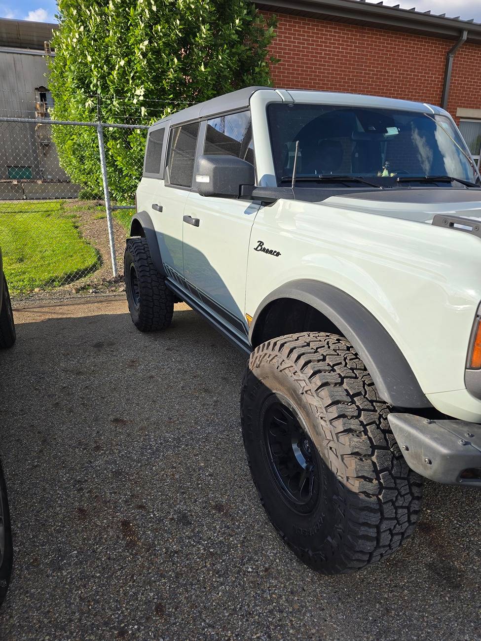

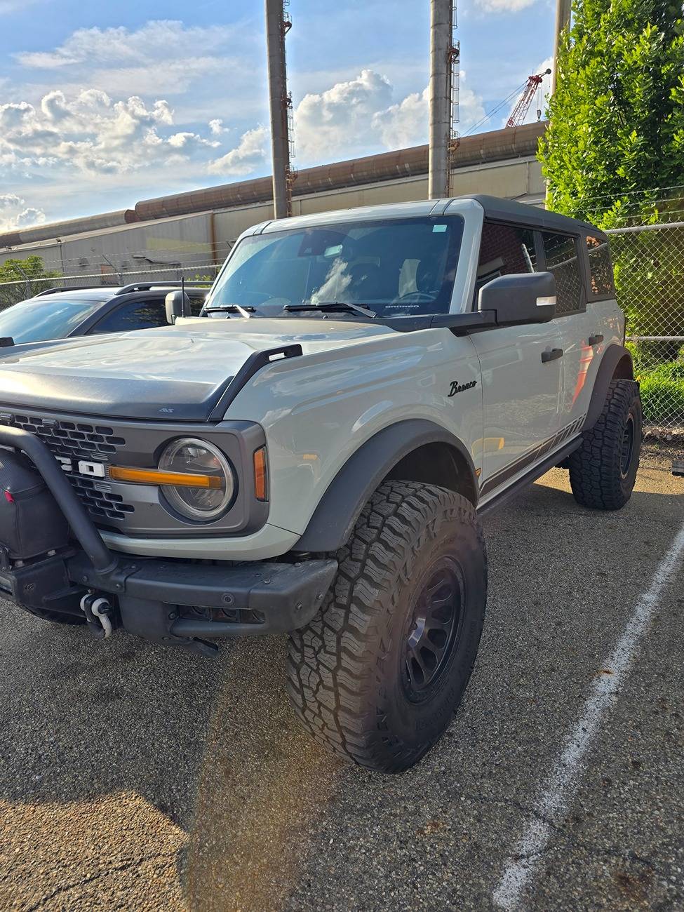

Update:
After talks with the dealership and the Ford help center, we have a resolution, I think.
The bronco was determined to be unsafe to drive, and Ford agreed to reimburse me for the repairs. They overnighted the parts, and it was fixed the next day.
When I picked it up, the service writer told me to bring in the receipt once the recall is open, and we’ll submit it and try to get reimbursed.
Try? I’m not 100% confident that it’ll happen. He said these were the upgraded struts, and they came with a 2 year warranty.
$1200.00 later, at least it’s back to normal.
I considered upgrading, but I can later if I decide to. Right now I’m just glad to have it back.
