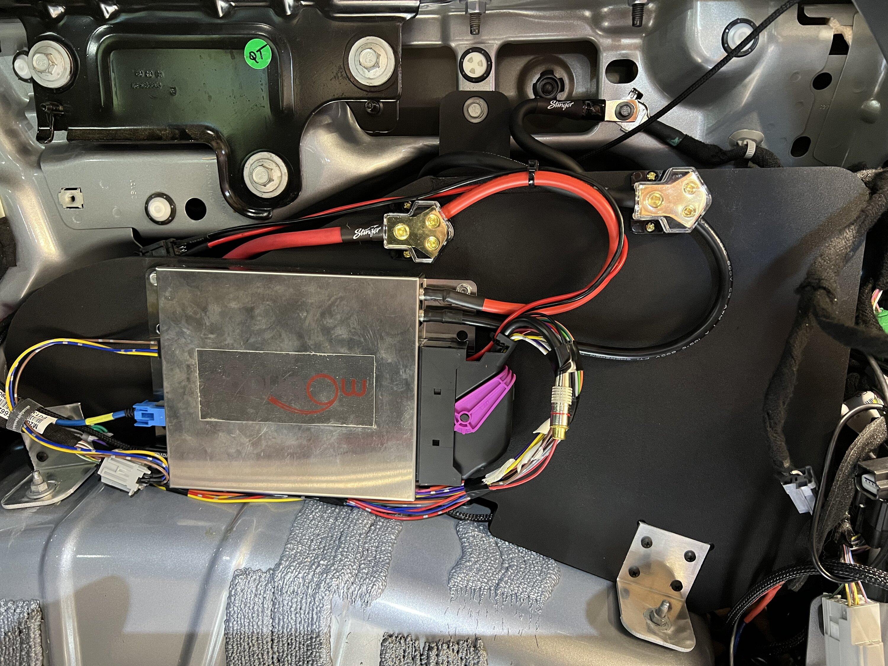

If anyone has put in a Kick Key for a sub, to Fraser's point, you are 90% of the way there for a full mobridge install. Basically, you need a power wire from the battery to the rear passenger side, you unplug the 3 connections to the OEM B&O amp, and those plug into the Mobridge harness (in the pic on the left its the grey plug (connect to the speakers), blue (the A2B input signal), and a black up near the top partially behind the board (the OEM power/ground wires), you add a ground cable, and the only additional thing is you bring a set of wires from the headunit down the passenger side (do the amp power down the drivers side) those drive the rear pods and the center channel. I also took out the oem sub enclosure (which the oem amp is attached to) and use an MTI amp rack that fits perfectly in the spot. You can see from my pic that I'm not a pro either at installing this stuff (a pro would probably laugh at how mine looks!!) but it is straight forward!! And I did mine without the mobridge premade kit - which now it should make it even easier!!!

I had a Kicker Key 500.1 prior to the Mobridge (amp/dsp) and I just took it out as the 2 channels to run the sub on the mobridge is powerful enough to drive my 12" stinger tailgate sub and just as configurable with crossover point and gain. I assume when you installed the key amp to the sub, you just cut the oem harness off and you used that as the high level inputs into the amp. So just solder those wires (or however you feel comfortable connecting wires) to the speaker wire you have going to the sub (almost like you are physically taking the amp out between the input and output of the speaker wires. When you plug in the mobridge harness, it will give you the signal to the sub thru the oem wire which then you'll have connected to your sub. Hopefully this makes sense, but I was in the same place prior to upgrading....
