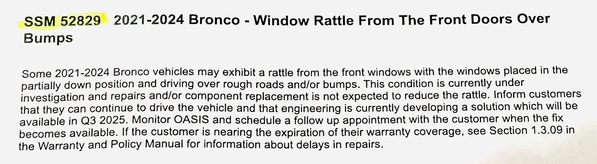

My ā€˜23 is in for an oil change right now, and my driver window rattles horribly as well, so I asked to have them address it. Got the same answer being discussed here. It’s a known issue, but Ford hasn’t released anything yet for the fix.
UPDATE: The service tech gave me the following official write up from Ford that also refers to Q3 2025 for a fix from Ford Engineering…

Thanks for the update on this! Another year of not cracking the windows open! LOL. All the way up or down. I have a '21 Badlands. Is this an issue with all years or just earlier ones, say '21 and '22?
It’s the design… yes all years affected.

My driver side window wobbles horribly, took it in earlier in the year. Dealer acknowledged issue but stated they per Ford guidance they will not do anything about it because there is an engineerig fix coming in Q4. Anyone heard anything about the timing of this?

My last service at Ford last week, they said Q3 of 2025 should be replaced as recall/warrenty

No Updates from Ford yet, I checked yesterday.
