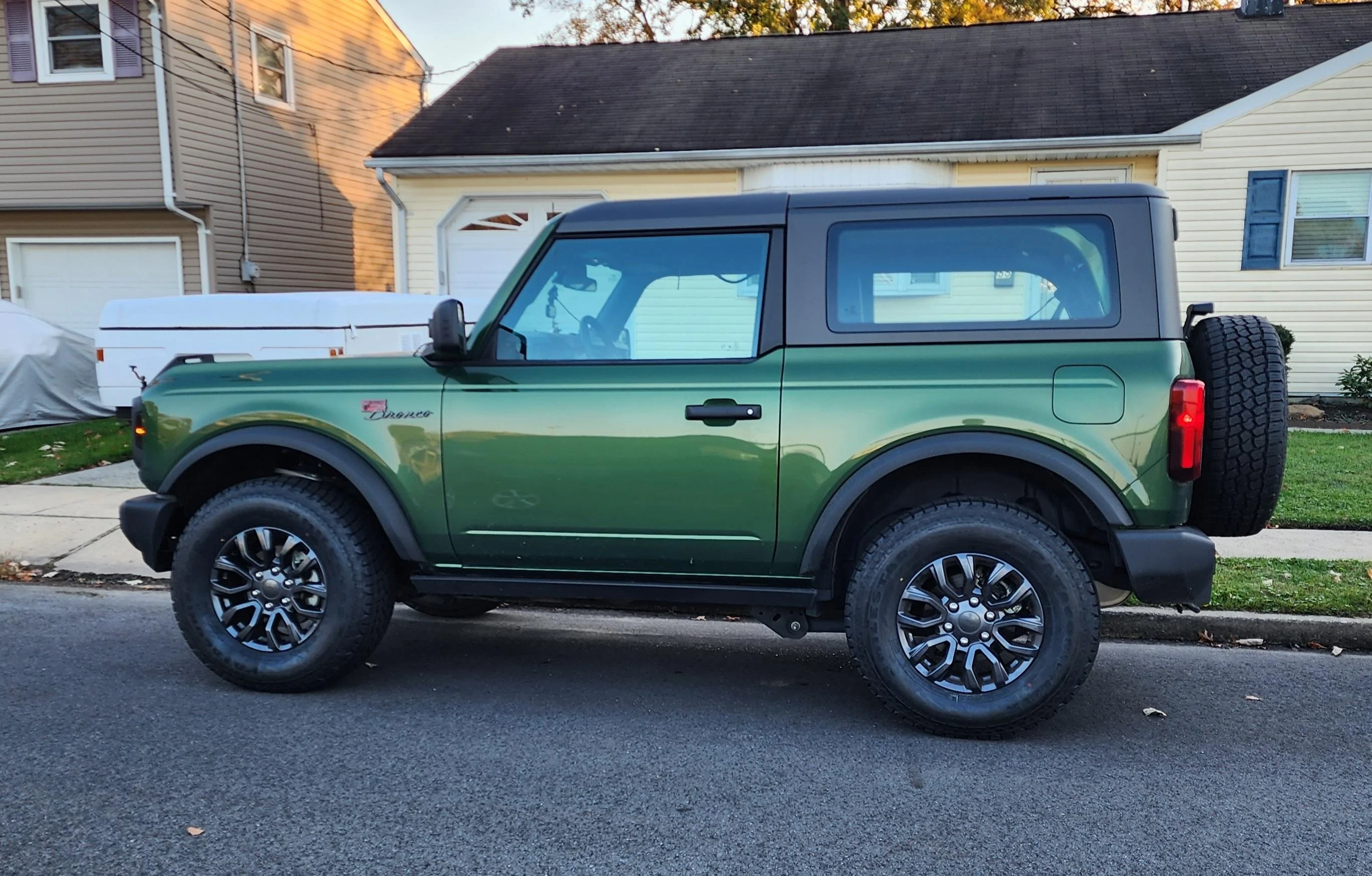

do you think Falken wildpeaks A/T3w. 275/70/17 is a good option ?
I am running those in a 265. No lift. Quiet for on road and hasn't given me trouble off road. Not too heavy of a tire either. And mine is a daily driver too doesn't get on many trails but I saw a mud hole the other day and decided to take advantage.

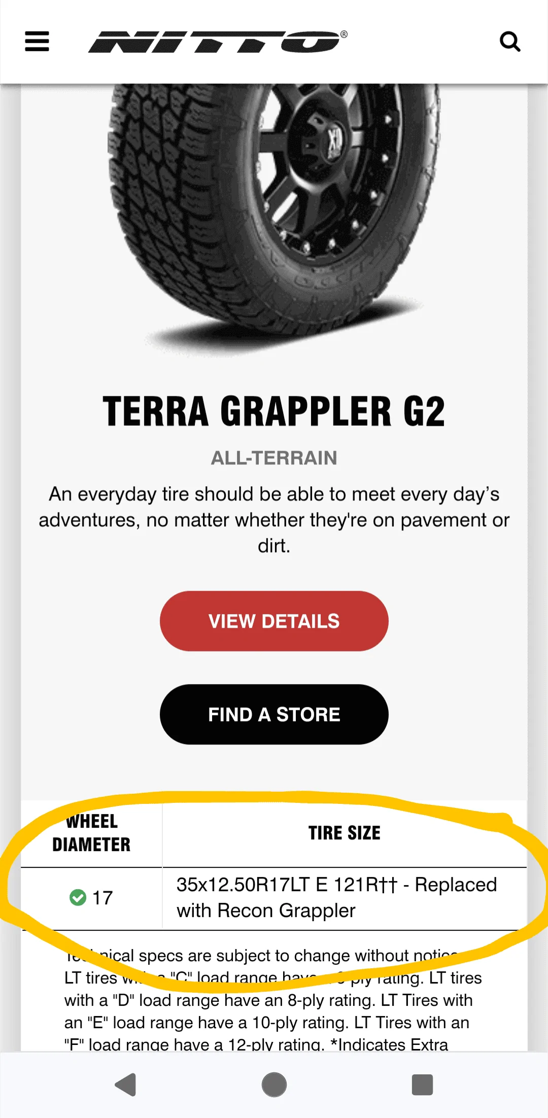

They don’t make them any more?
I had them on my JKU and am on my 2nd set for my F150. When I had to replace my truck tires last year the only place I could find them was on eBay. They may still make some sizes but seems like the Recons have officially replaced them.

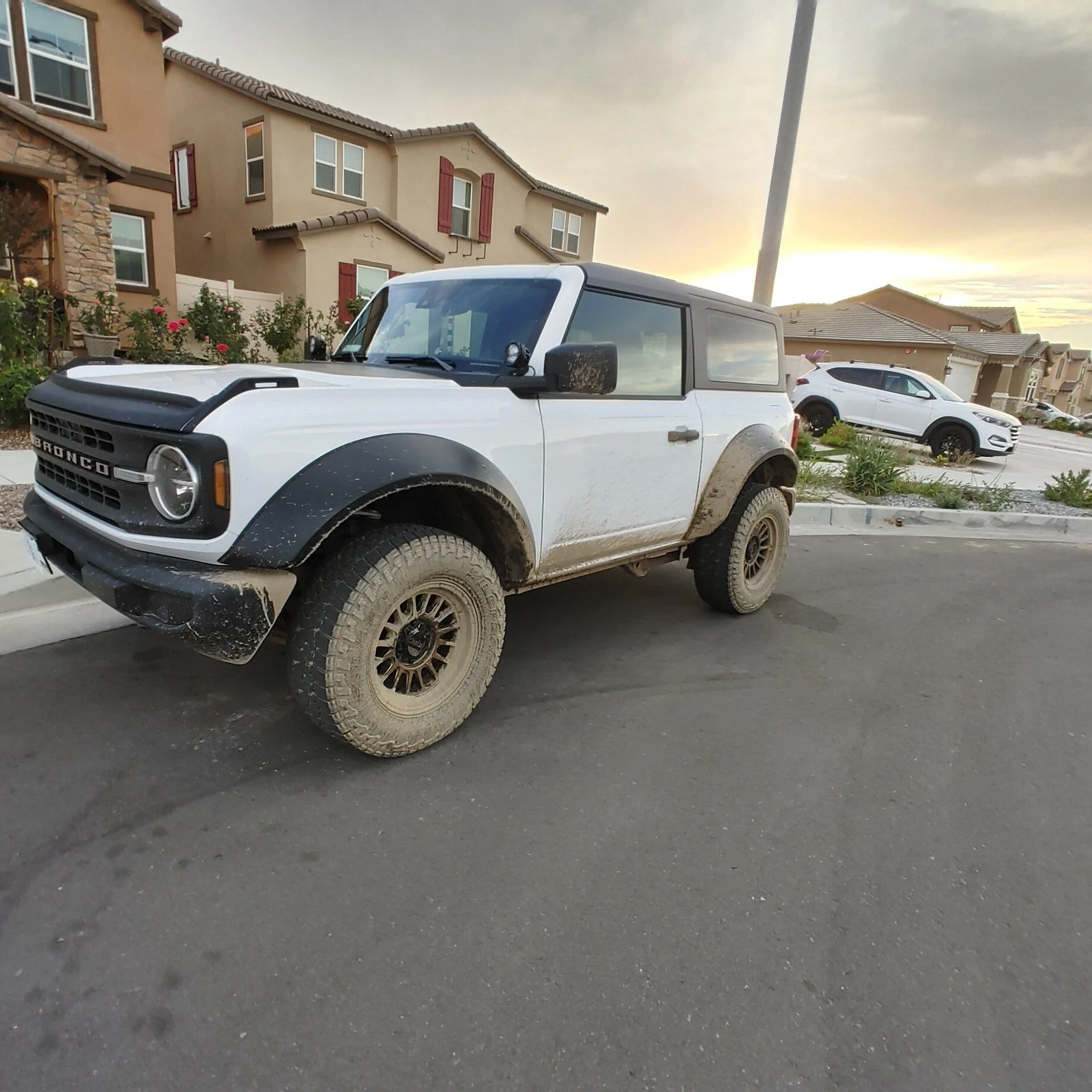

For what it's worth, I picked up a set of Milestar Patagonia's 285 70 17. No lift or offset and the don't rub full stop. I haven't taken them on the trail yet but I had read about them in a motortrend article about overlanding. So far so good though, not much road noise but the handling is a little stiffer... here's a link to the article...
I'm also running the Patagonia XT's. Mine are 275/80-17, looks great on the steelies. Maybe a little narrow for some of the other wheels.
I've ran them off road a good bit, mostly trails and a little mud, no rocks. I've been really happy with them. On road I think they havd slightly less traction than the stock Grabbers, a little squealing if I get on it will turning in 2wd. Other than that the road manners are fine.
