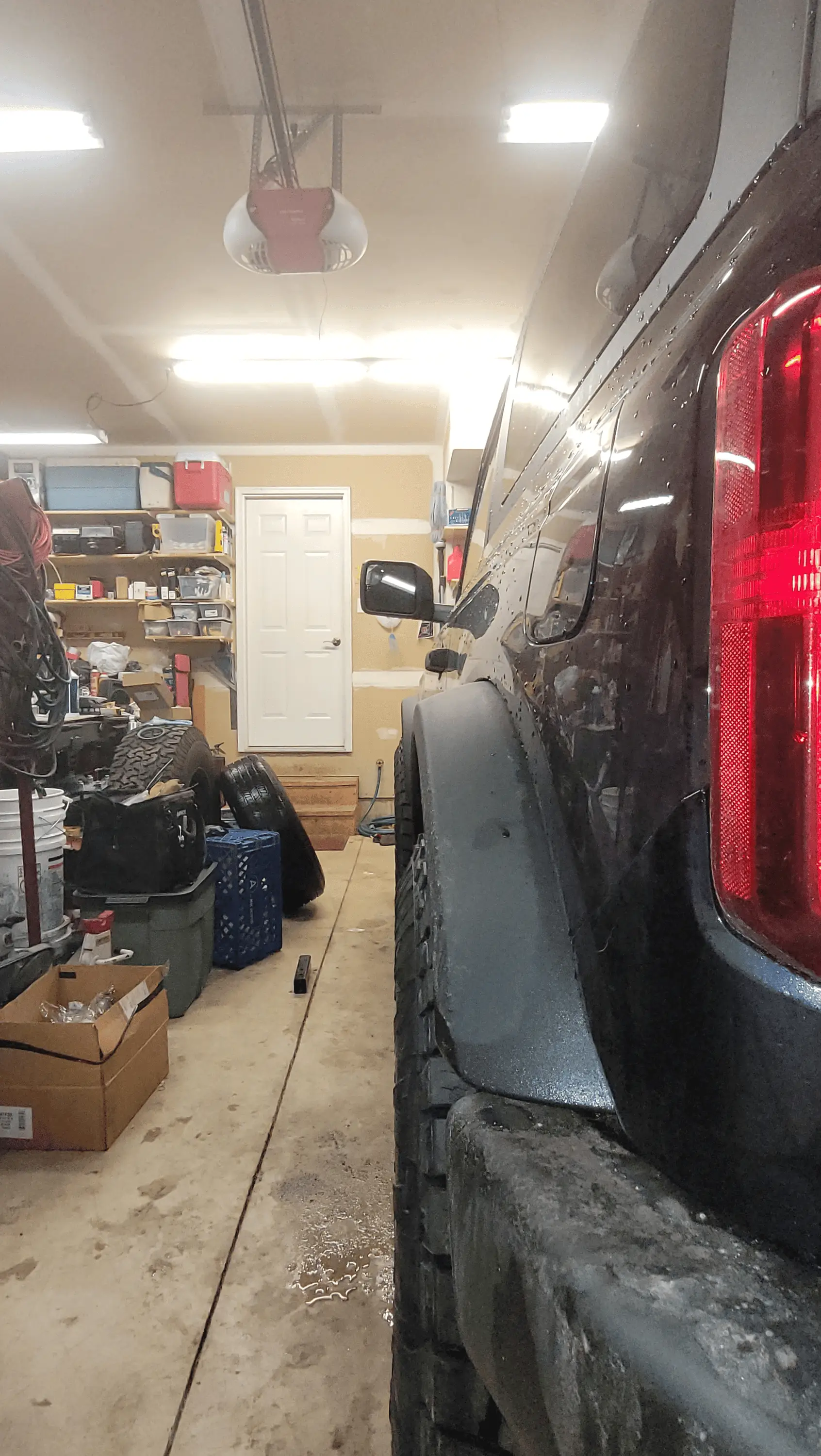

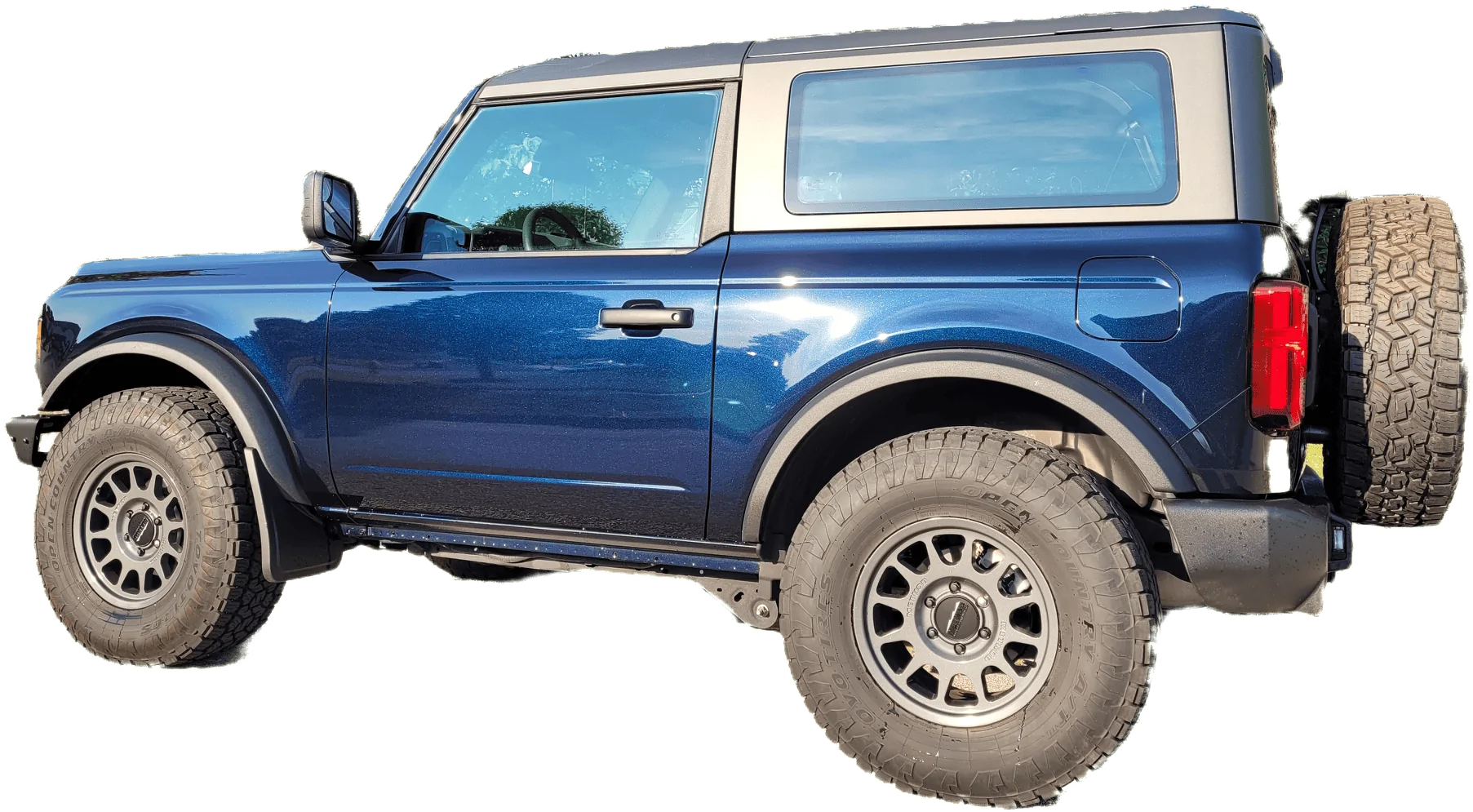

I have 35" tires on my standard suspension Base, so, no lift needed ... BUT ... at 35" it may be best to get wheels that push the tire out farther, as the SASQUATCH wheels do.
It is called offset.
Obx, base, .... all non-Squatch basically are +55mm offset.
Squatch is +30mm.
My Method wheels are +35 and they fit the 35 x 11.5's very well to the Bronco.
