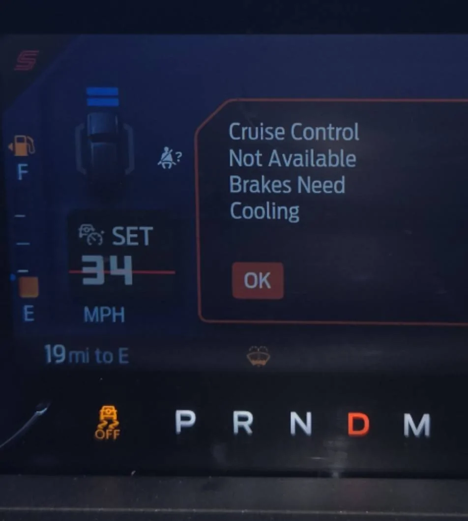

I have 2 words...Traction control.
The slippery mode DOES have a different algorithm than the other modes for determining "slip". In fact, I'll venture to say that bit is the most sensitive mode to use, It notices slip more than the other modes. With my BIG MEATS and slow sharp turns ( in slippery mode) I can FEEL AND HEAR the Traction control trying to "figure out" why the tires are spinning at completely different speeds. It's sounds and feels similar to TTA being active.
I have ALOT of personal testing with all the modes...for example I'll select a mode and then send it into a loose gravel corner WAY HARDER than I could ever keep contoll of, without the computer assisting, and to my complete amazement ( and relief) the Traction control has the ability to manage a sideways full slide, generating G forces that would NEVER be possible w/o Traction/stability controll. 99% will never understand how well this works because they don't trust the system well enough to actually test it!
While testing at way to high of speeds on loose gravel, my dash lights up.with this...yep the brakes have temperature sensors ( or an algorithm to calculate heat)
Additionally, I noticed the sport mode and slippery mode have different levels of 'assistance'...especially when accelerating out of the slippery corner while in full drift.
