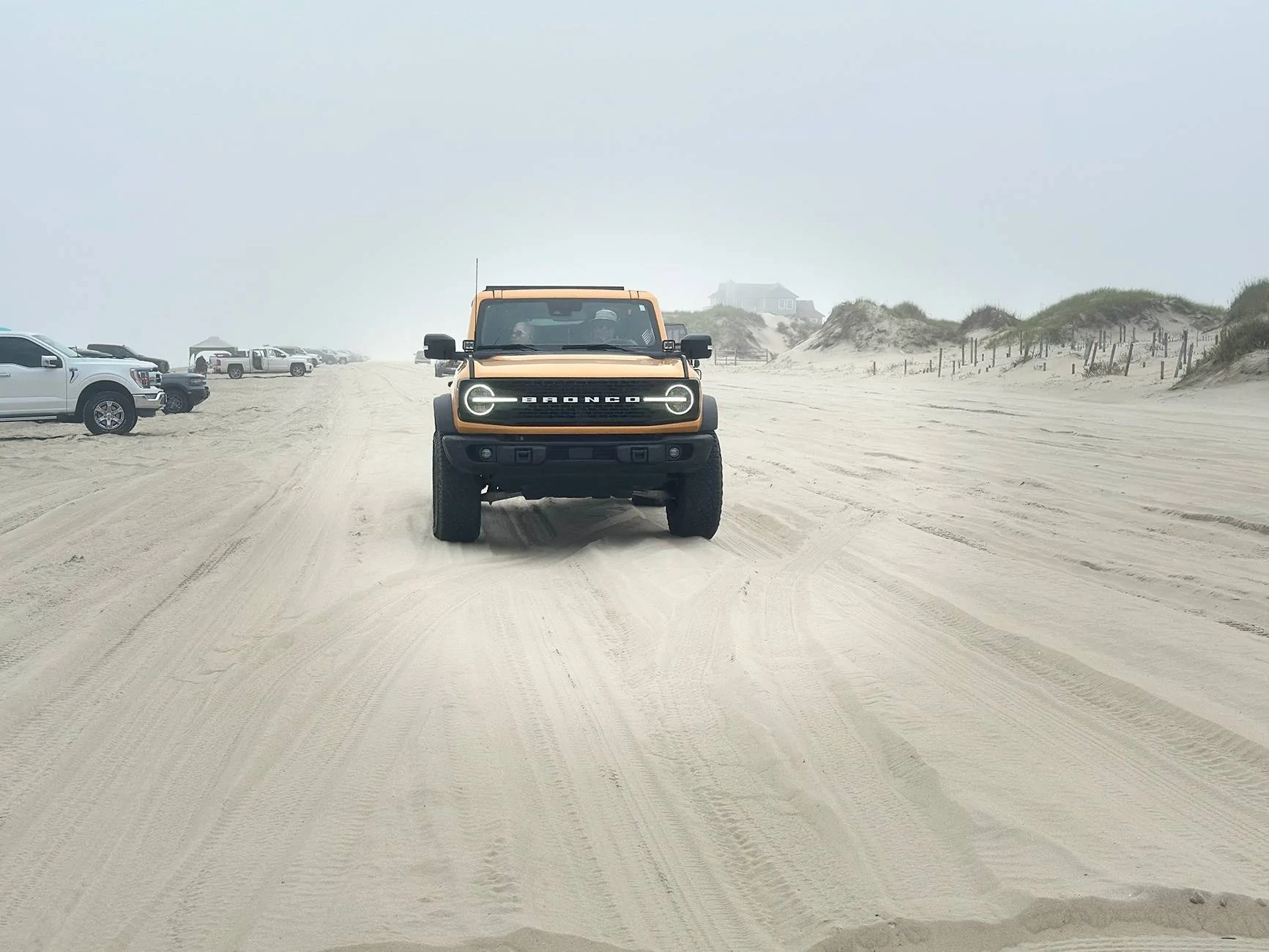

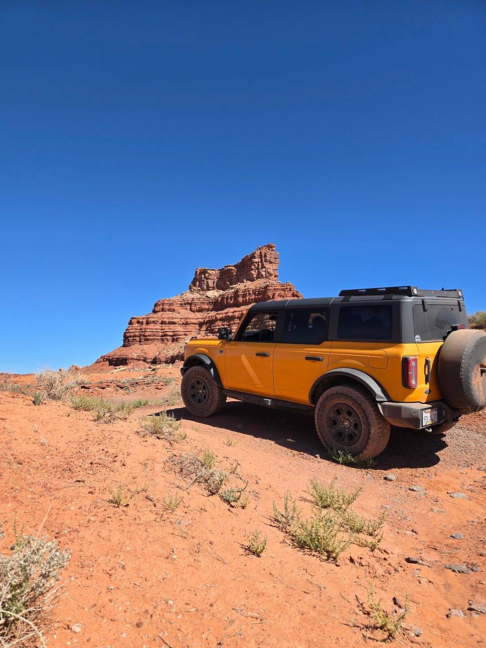

I recently drove coast to coast and back, used my sports mode 50% of time during my travel in heavy rain and dry weather, on off road and highways and never felt any unusual indications of any problem while in 4A. 7,500 miles
