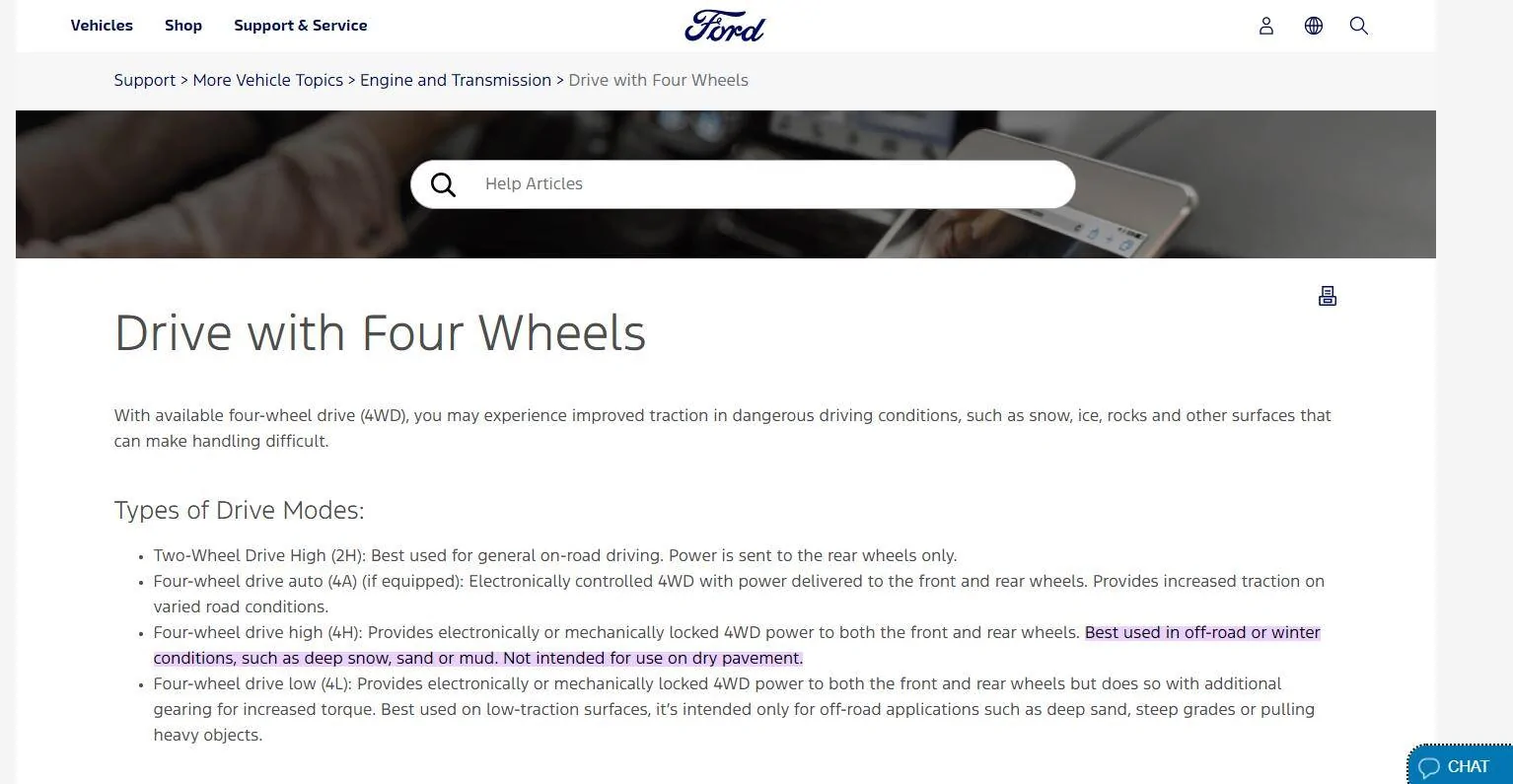

I am not a tranmission nerd but when Ford has documentation like this:

They are leaving themselves wide open to warranty litigation by not saying 4A is not intended for use on dry pavement. They clearly do so for 4H, which makes total sense.

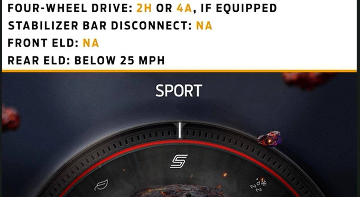

Conversely they don't come out and explicitly say that it is OK to use 4A 100% of the time (I have looked), but every instance, like the above screenshot, it is implied that 4A can be used for on-road driving.
In their own videos, they do clearly state the 4A can be used in Sport mode with no disclaimers

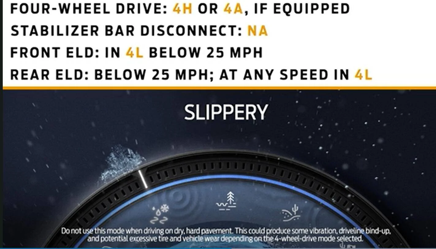

But for Slippery mode, there is a clear disclaimer (at the bottom) to not use on dry pavement
Ford Bronco 4A issues. ford says this is normal? 1728018526083-7d
Same for Mud mode.

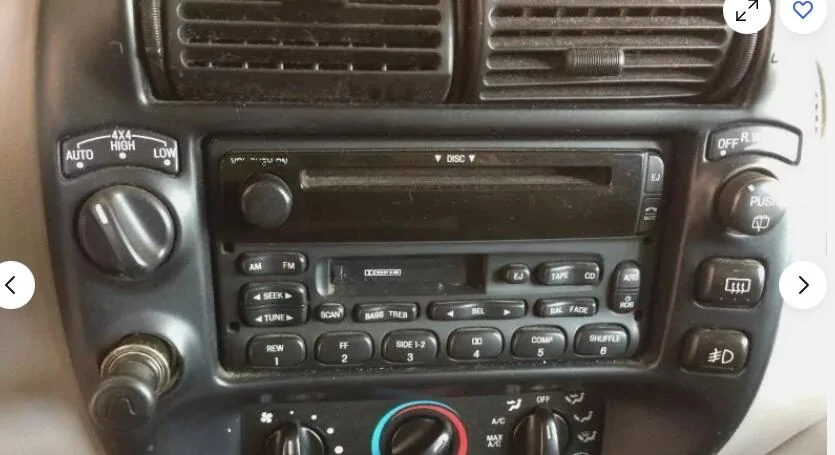

Yes, we had the 4WD '98 Explorer XLT. It had a 4A (Auto) option on the dashboard dial.
