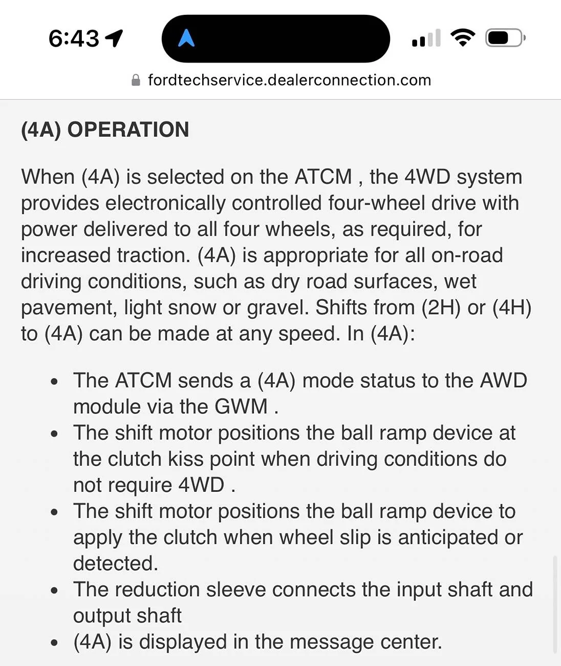

Only point I am making is that I have yet to see FORD DOCUMENTATION that clearly states you can run 4A on pavement all the time.
Once again, there has already been FORD DOCUMENTATION stating it is appropriate for all road conditions posted multiple times on this forum.
See the very first paragraph on post 34. This is posted in the factory workshop manual and also all other training material because it’s exactly what Ford teaches its technicians.
All road conditions means you can use it 100% of the time whether it’s dry pavement, wet pavement, gravel, etc.
don’t get me wrong, I am on your side on this. But post number 34 does not reference the Ford documentation it came from.
I am curious what owners manual or other official Ford document that text came from
Regardless,I will be using 4A all the time when I am driving. 😀
It’s copied directly out of the factory workshop manual.
