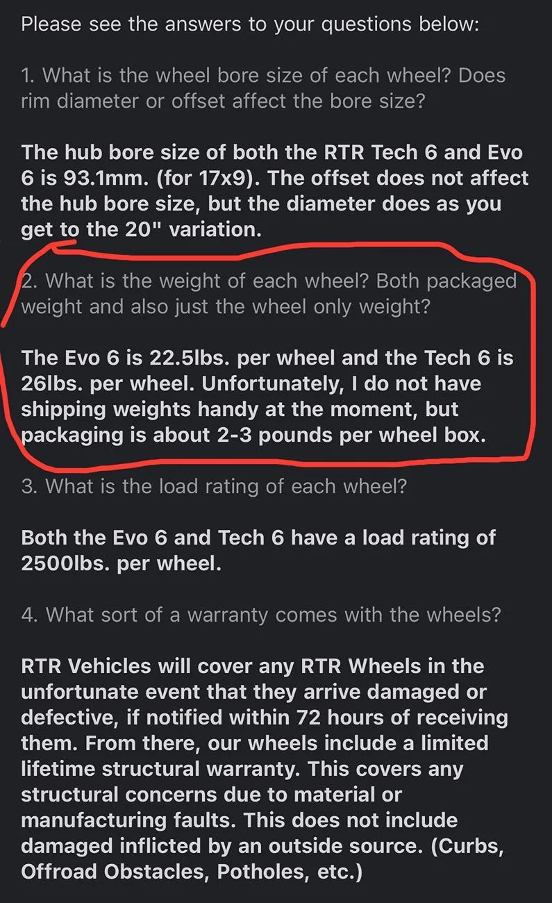

I am also considering RTR wheels. And was also curious about weight. My personal preference is hubcentric and light weight when possible. Below is RTR’s email response from customer service.
I've looked at the RTR's and they're nice at 22.5lbs, but they're not bead grips. I'm not actually a big fan of the Method styles (I prefer Black Rhinos), but I think they look good enough and they have that bead grip tech, which is what I'm after.
Spot on. Mine are 22.6 lbs with TPMS installed.
I air down to 18-20 and haven't had any de-beading.
A good bridge between these and beadlocks, are the Method Bead Grips. They weight maybe 25-28 lbs and are very tough offroad.
The Methods are excellent wheels, in fact Ford Performance sells them.
The 703's I'm looking at are 25.5lbs, so yeah, not much difference. Having the bead grip makes that little bit of unsprung weight worth it. The only thing I don't like about the bead grips is that they are hard to get the tires off and they often end up destoying them.
