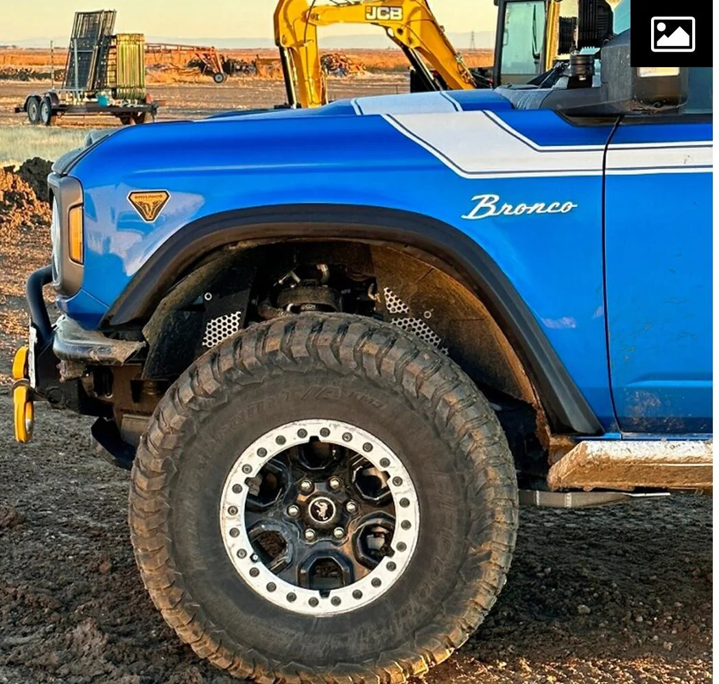

That’s a really good way to put it. I had no intentions on lifting the Bronco as I hate what lift kits typically do to a vehicle. We went out wheeling with a two-door bronck and got high centered pretty bad. Girlie asked what could be done to overcome this, and I gave her the simple answer of bigger tires. The entire time we’ve been together she has never once asked for a material thing, so when she said she wants to run 40’s it was all over. Ordered the portals and steering rack a couple days later.

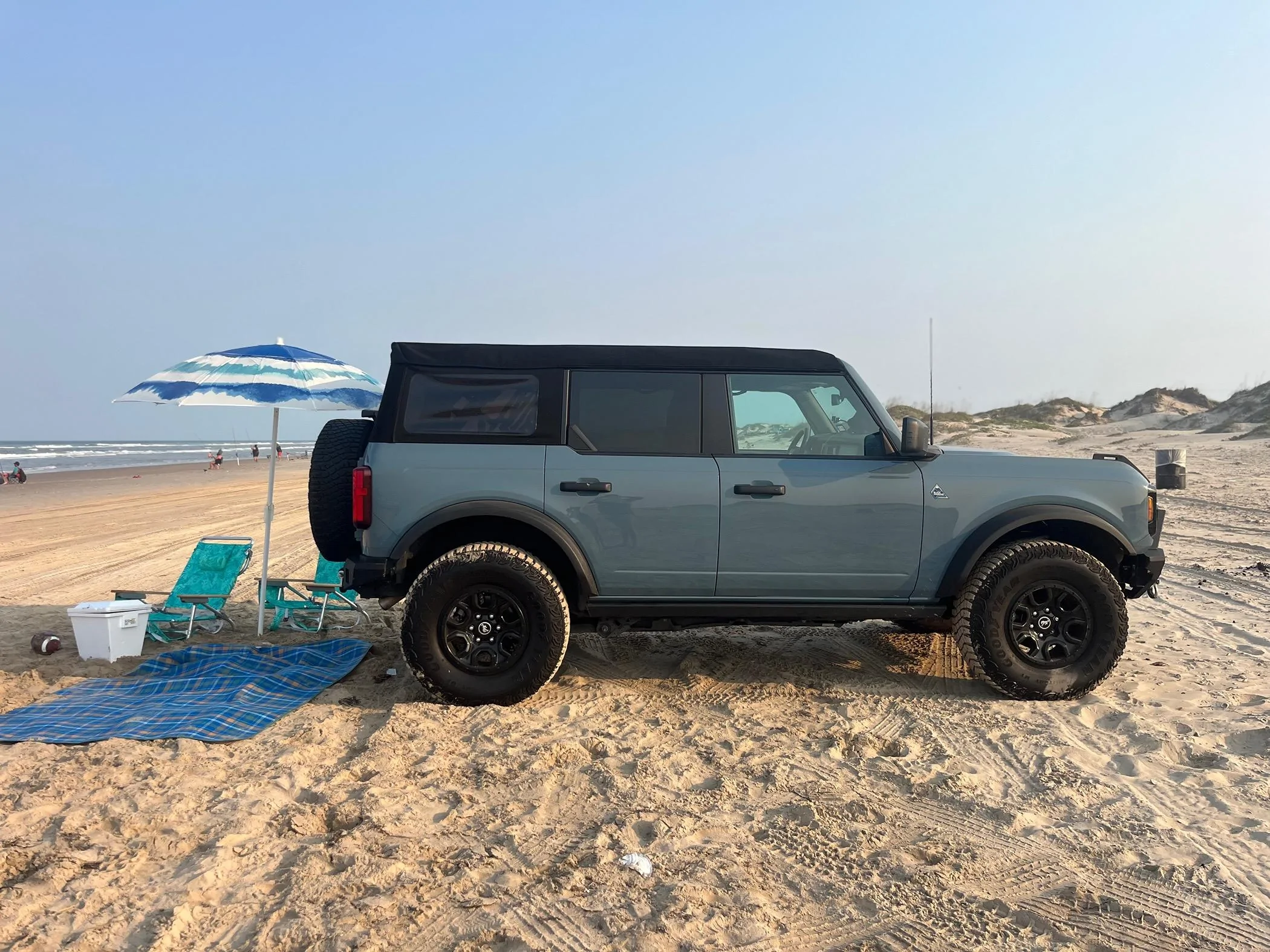

Lol, honestly I have considered many possibilities and I am trying to make the best decision for what I need it for…the 37s look great to me but I do have to jump in on 35s currently. Hubby says not to size up because of everything else I need to consider but ultimately he says I can get anything I want.
I did consider the 16” wheel as well but am concerned that I may be limited with tire options/availability. I’m definitely changing out my wheels soon but have agreed to change tires until I’ve worn these out.
Immediate upcoming mods are switching out my fender flares and adding steps.
Regarding the lift…do you have recommendations on a 1-2” lift that would be compatible with the Sasquatch package? I thought I read that they have to remove it to put in a lift?
I’d like to have a good solid picture of what I’m getting myself into if I do decide to go bigger and this thread has answered so many of my questions!

OP, lots of information all over the place on this thread, so I will try to provide some clarity.
If that is your Bronco in the picture you posted it looks to be an OBX with the Sasquatch package, if that is the case, you have the 4.7 gearing. The 2.3 paired with that gear ratio is a good combo for 37's. No need to regear or try and find lighter wheels or 16" rims. As someone mentioned though, you will need about 2" of additional lift to clear the bigger tires.
For your stated use case, beach days, you don't have to worry about a steering rack or beefier tie-rods or even braces. The stock units will be fine. However, it is worth buying an inner spare tie-rod and keeping it with your recovery gear or in your Bronco as cheap insurance. There are plenty of people, myself included, that wheel rocky obstacles on stock equipment and do just fine.
Since you do seem to like the beach, an air compressor and other basic recovery gear (shovel, snatch rope, shackles, etc) will probably be a good idea. If you are not traveling on hard pack sand, you will want to air down those tires to increase the contact patch and avoid getting stuck. Airing down the tires to 15psi will be enough. Then, before you hit the road again, use that air compressor to fill those 37's back up to 32-35psi.

Thank you very much for this information! I have purchased an air compressor and have a shovel already in my rig but I will add the additional recommended items as well!

Judging that OP isn't an offroader and doesn't know what a steering rack is, I'd say leave it stock.
