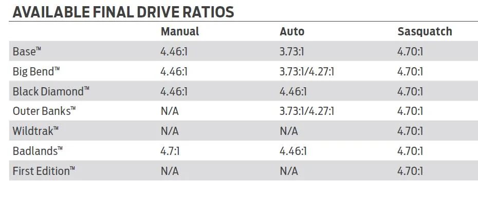

So... how would I know what my Bronco was geared to? I'm the second owner and It's an Outer Banks, non-Sas
Beachin 74
Jun 22, 2020
1,065
2,859
Delaware
If you have a rear locker switch on top of the dashboard you have 4.27. If you don't have a rear locker, you have 3.73.

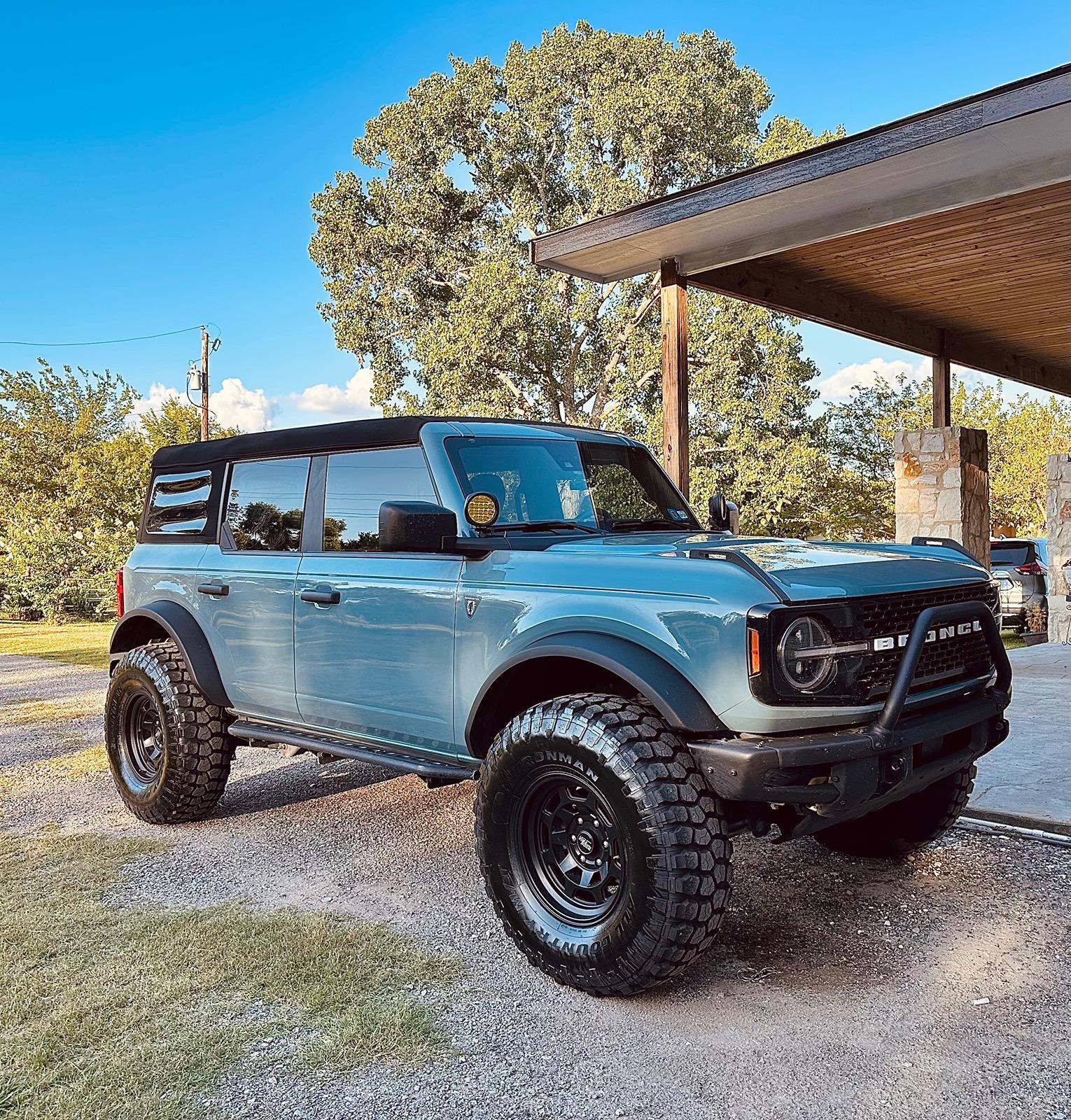

37’s, -12 offset - Sasquatch + Eibach lift springs.
Ford Bronco 37s on a 2.3L? IMG_3119

Thanks for sharing @LOSTXGOLD There you go, @BroncGal
same color and everything. I love the internet.
Since your original post was about engine/power/tire diameter, and since my opinion differs slightly from the consensus in this thread, I'll give you my experience.
I have the 2.3 with the 7 speed manual transmission. I have a non-sas badlands so I have the 4.7 rear end. I can't speak to the 10 speed auto and the low gears, but I can tell you that I like the way my rig drives better on stock 33s than it does on the 35x13.5s I have on it. For capability reasons, I'd never go backwards. And they look great too. But I sometimes switch the stockies back on (like when I'm bringing it in for warranty work on the front end). And I am always bummed about how much more juice it has out of the hole with the smaller tires.
I often think about re-doing the suspension and going 37s. And sometimes 40s. But given my experience from 33s to 35s, I would definitely re-gear if I went to 37s. Like I wrote, I know that is different than much of the feedback on this thread.
Just to give you the other side, people will argue that the raptor comes on 37s and it has 4.7 axles. -but it does have a much more powerful engine.
And I also think I have read that moving to a bigger final drive ratio than 4.7 might be more challenging than swapping in some gears. There are definitely threads on this forum on that topic.
But looking at lostxgold's pic above, how can you not? Fun fun. 37s are the new 35s.

I will say, it has lost its agility. I do like the way the 35’s felt vs the 37’s.
Personally it feels slightly slower. Which makes sense, because of the heavy 37’s.
I do like the look better than the 35’s, so it just depends on personal preference.
I’ll try to find lighter 37’s the next go around.
Did you add the lift springs for the clearance? Do you know how much of a lift it gave?
What load rating do yours have? Based on the recommendations here I have been looking at C and D.
Yes, I added the lift springs for clearance to fit the 37’s.
I’ll double check on the load rating, it might be F. Which was an accident. There was load D, and F.
It added a lift of: Front: +2.3" Rear: +1.6"
