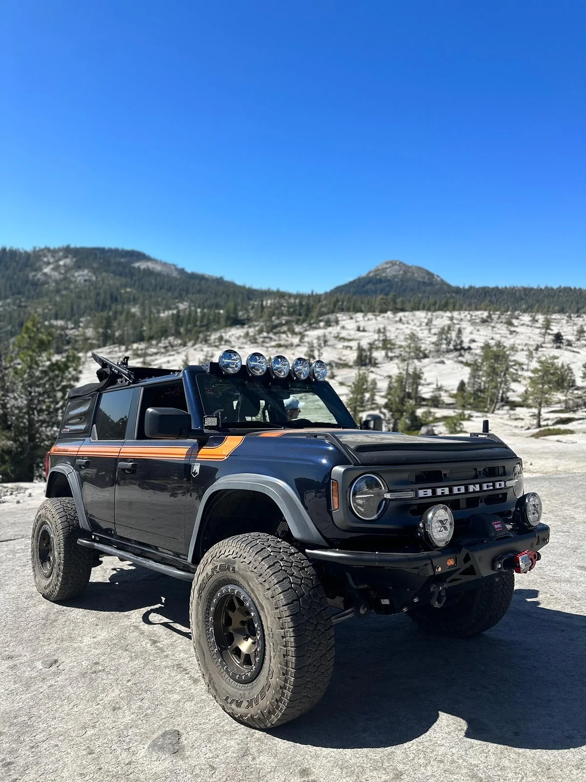

@Johnny Rebel has 37s with a 2.3 and ford performance tune... its a nice combo
Indeed I do. Mine is a 2 DR Big Bend non-Sasquatch with the 2.3 and 3.73 rear end.
I installed King coilovers and the Ford Performance tune along with 37" BFG KM3's and couldn't be happier with the performance. The trick is to drive it in Sport Mode (I added this through ForScan). Sport Mode keeps the transmission from ever shifting into 9th or 10th gear, so it effectively like an electronic re-gear of the rear axle.
At highway speeds (75-80 mph), I usually get around 15-16 mpg. At slower speeds, it only gets better.
Hope that helps.

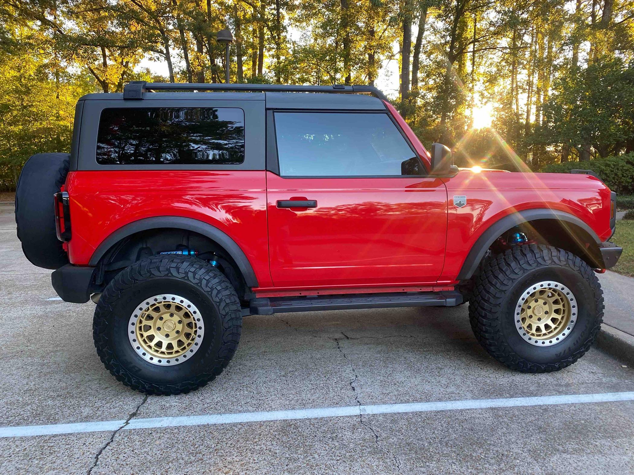

People that say the 2.3 doesn’t do well with 37’s are probably driving a Jeep on 37’s with less HP ;)
But yes, gearing is everything. I’ve been happy with my stock 4.7 gears on 37’s for 30,000 miles on em. 2.3 engine with auto transmission here. Rubicon 2x, Moab 2x, Mojave, hundreds of unnamed trails and no worries.
That being said, 37’s is a lot to bite off and if you’re just going to the beach it might be more trouble and money then it’s worth for you if you’re happy now.
