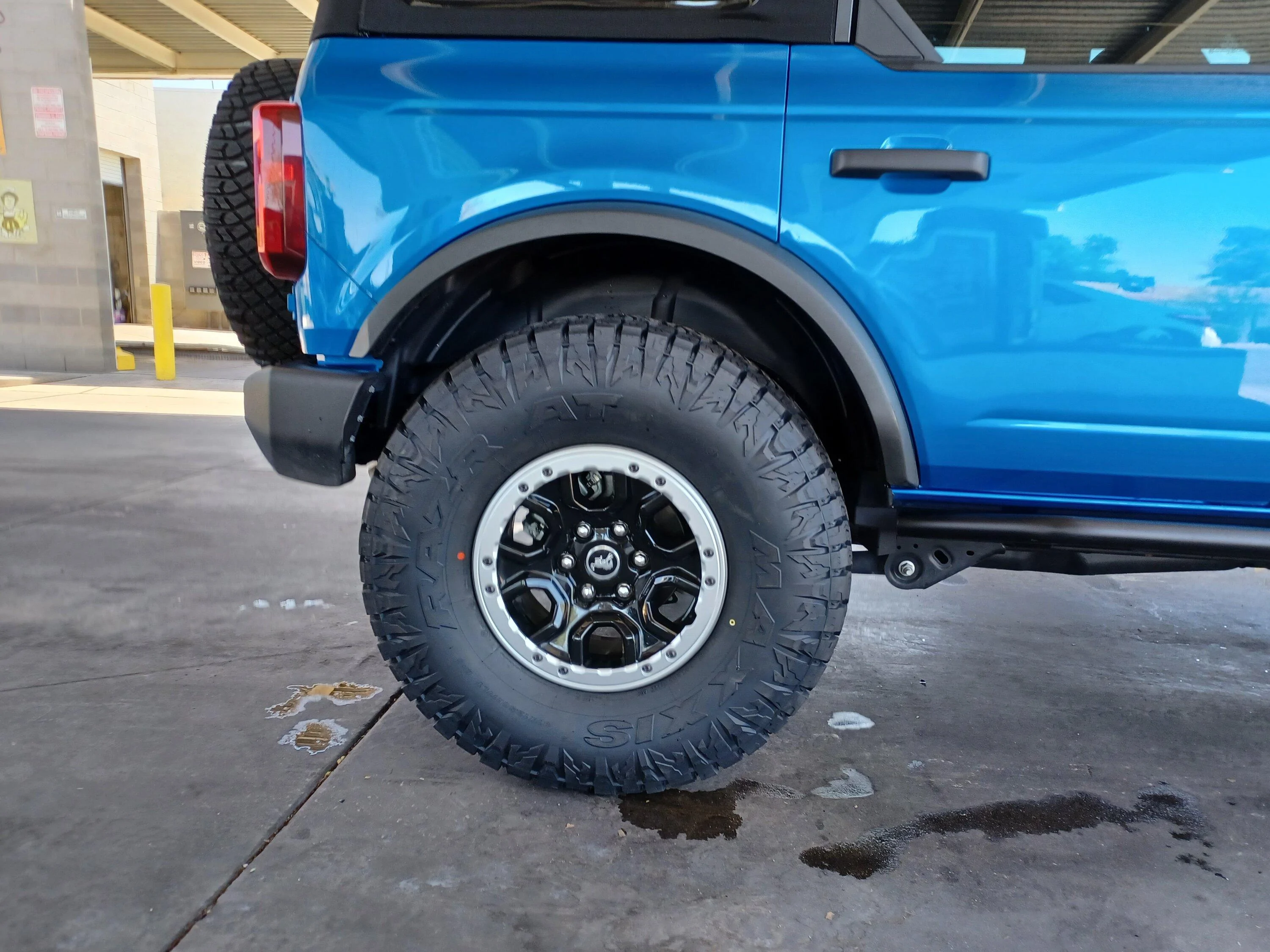

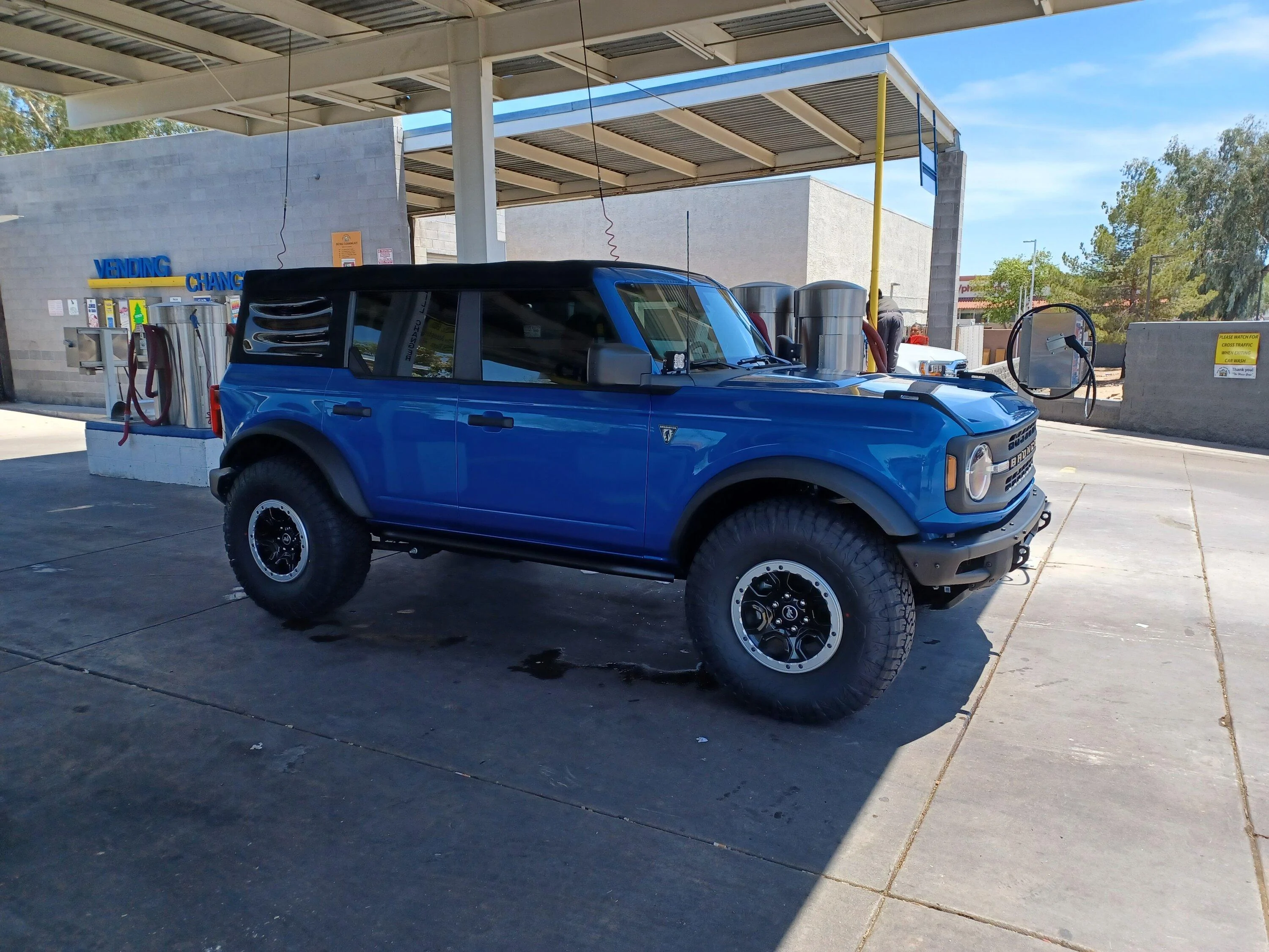

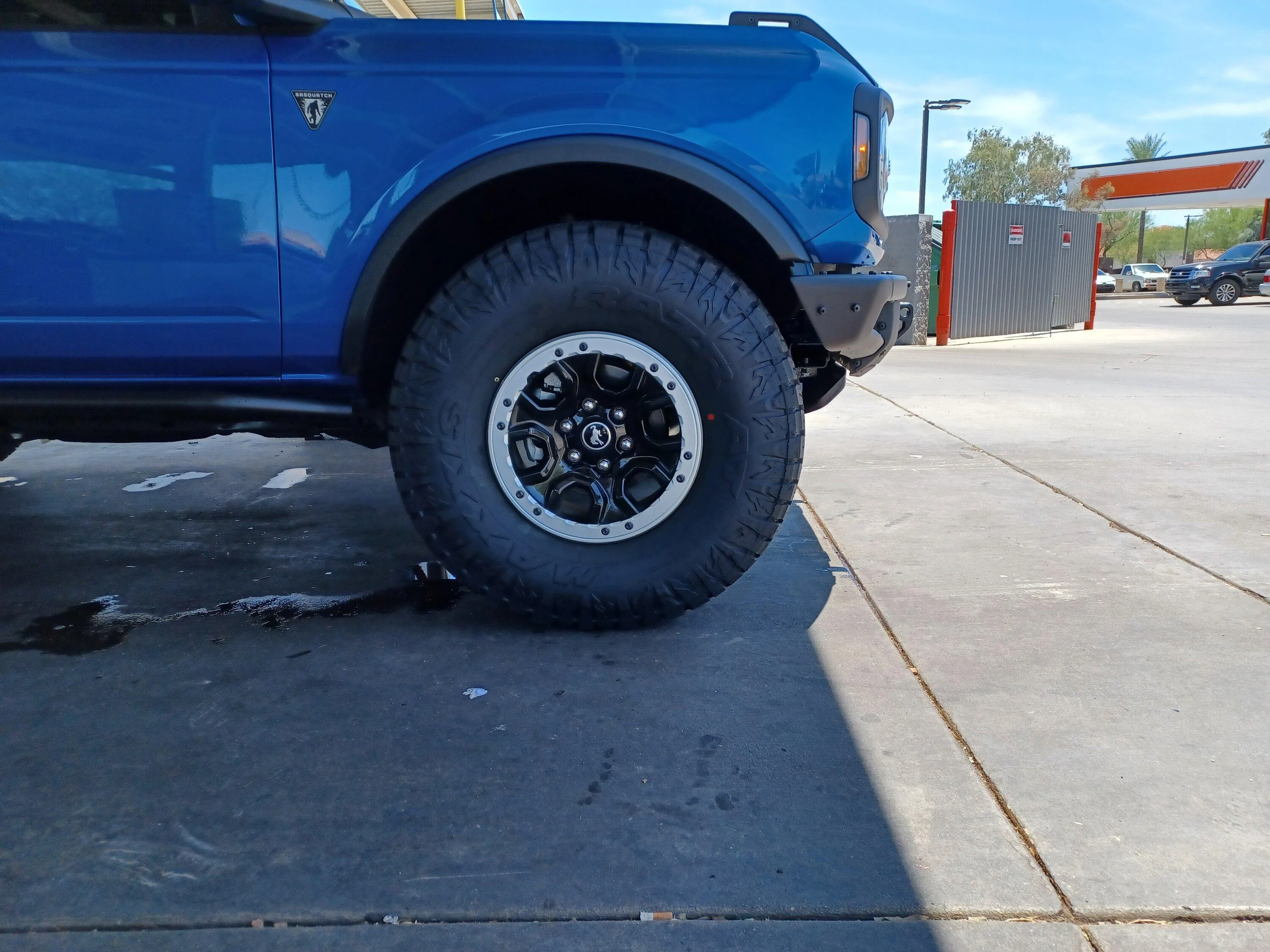

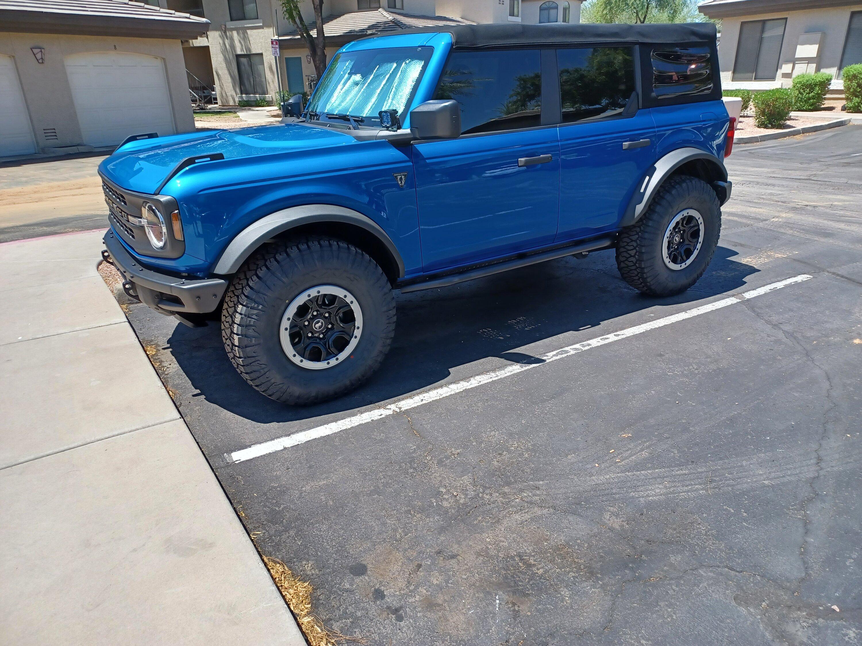

There are other threads with 37s on stock Sasquatch. I did it on stock suspension and wheels. Mine has no rub, or interference.
This will depend on tire manufacturer, as some are a little taller/wider then others. I have Maxxis RAZR a/t. 37/12.50 17. I love them so far. Mine measure about 36in at 39 lbs
Also what wheel you use will make a huge difference. The stock offset has rubbed a little on others broncos with 37s ( different tires)
I have a 1" level kit I will put on at some point. I do offroad, but it is way to hot at the moment in AZ. This fall I will be hitting trails.
Measuring at flares I gained about an inch front and back.
I would do it again in a heart beat.

Should clarify no rubbing interference on road, normal driving. I know I may have some off road, but I will clearance for it. I like a low center of gravity off road. It's worth the trade off for me

That is a great looking Bronco.
How are 37's holding up long term?
