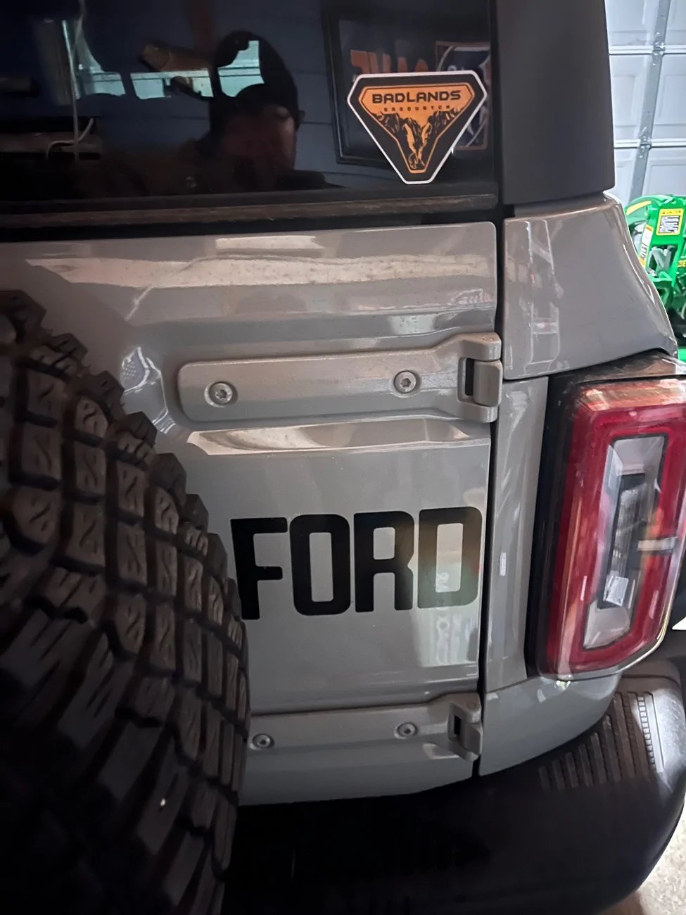

Hi
Just joined the group and wanted to ask if any of you had your spare 37 on the factory spare tire carrier without any reinforcement? I’m looking to upgrade mine to 37 and want to put spare 37 on original spare carrier without reinforcement. I only will be using Bronco for daily driver, hunting blind and fishing hole . No real off roading, wanted your opinion if you had time.
thanks
Adam

Going be honest with you I’d still get a reinforcement of some sort. Even tho you’re just daily driving your still likely to hit bumps of some sort not worth potentially damaging the tailgate or hinges but that my 2 cent. Happy thanksgiving 🦃

Wanted to try keeping my FORD decal if I do reinforcement if at all possible. Will have to shop around I guess.
Turn Offroad re-enforcement will still let that show. May be easier to just replace it though. The TOR kit is nice and one of the strongest available but costs more than the standard plates do

Hell my upgrade to 35's was enough to have my tailgate popping. I have a big bend Non SAS so it had the weaker spare carrier. I ended up going the costly method and got the Expedition One rear bumper with swing out carrier. Maybe you could get away with the stock carrier if your Bronco came with SAS and you find really light tires. I know there are a couple out there that weigh about the same as the SAS stock 35" but the stock tires are already really light.

Thanks, yes it’s the Sasquatch package, I’ve noticed tailgate max weight allowed on other forums was 135lbs, so I’ll see what tire and wheel weigh.

I have a 37" and steel wheels on mine with no extra support. About 109lbs, no noises or problems. I wheel it hard and just about jump it when the opportunity is there.
