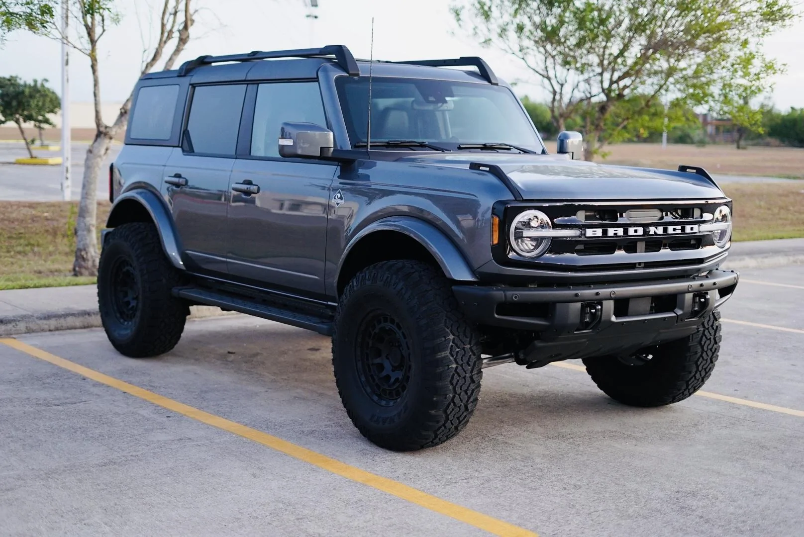

Can this kit fit 37" tires on an outer banks? The rims which I already bought are 17x 8.5 zero offset.
It says 35" but I'm sure they're not talking about removing the crash bars.
Yes. I’ve got an OBX non-SAS on 37s with 0 offset. No issues. Runs great, looks awesome.

Thanks ! Not bad ! Slightly rougher but my tires are a lot more aggressive than stock, they’re also E load so there’s that, and they’re overinflated. I’m going to drop the pressure to 35psi to see if there’s a difference. I actually just got My OBX and this setup last week so still getting used to it but very happy I went with 37s. Only regret I have now is I wish I had gone with a bigger lift instead of the 3” ICON.

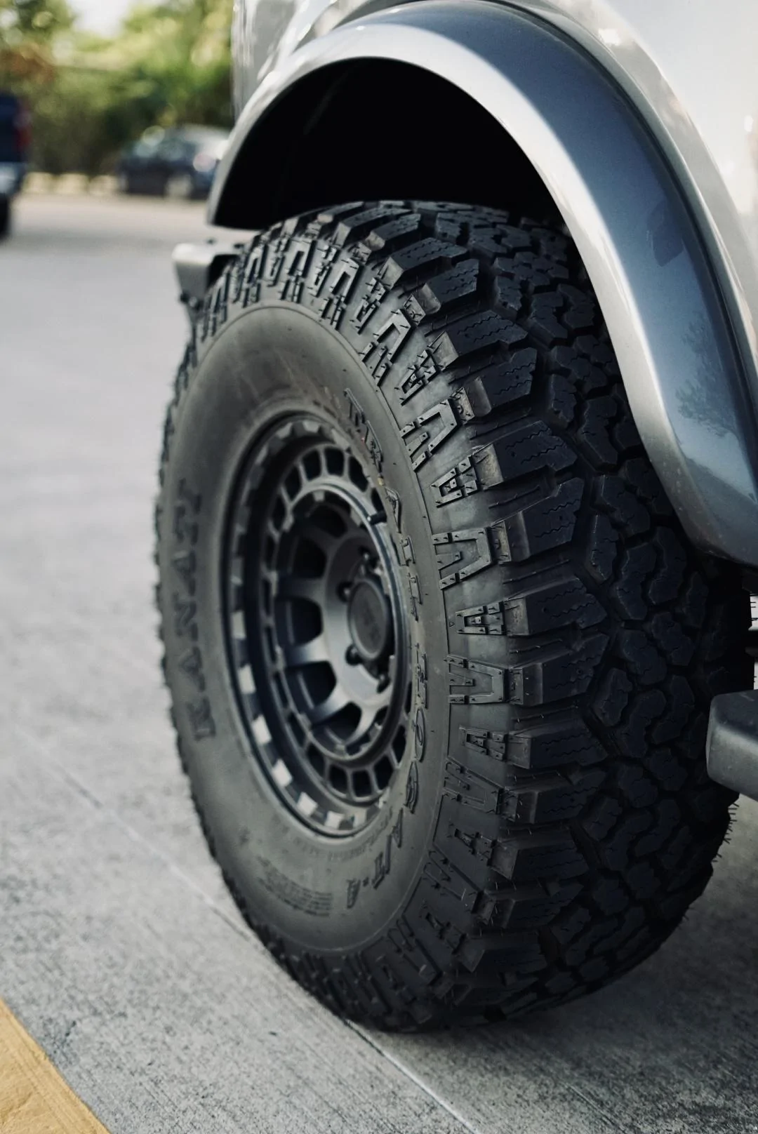

No rub under normal driving. There’s a really small and quick rub on the back of the front tires on the side steps when braking hard and turning. But that can be fixed. I’ll be removing those stupid steps soon. 3” ICON Spacer Lift. I went with a 0 offset because I understood it would be the best offset without too much poke and without rubbing on the crash bars or in the back of the wheel wells. +12 might rub a little on the front part of the crash bars but you can always do the JKS Tire Clearance Kit.

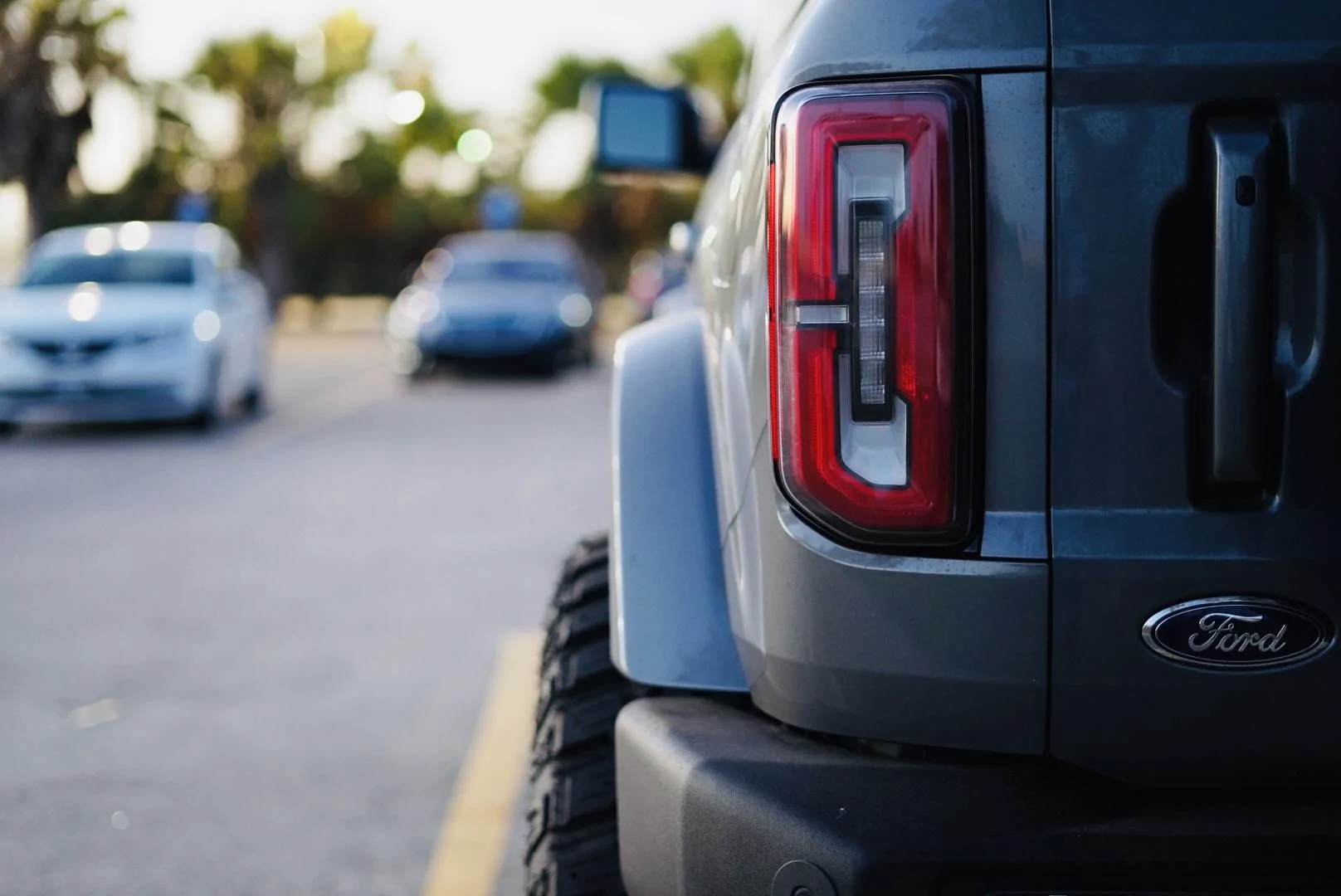

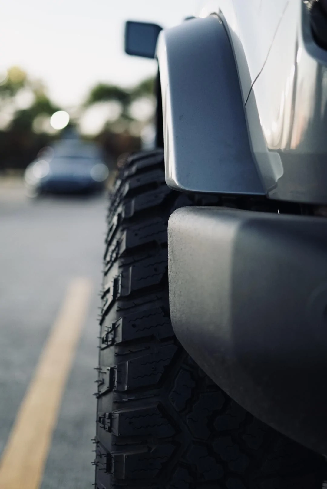

Here are some pics of the poke.

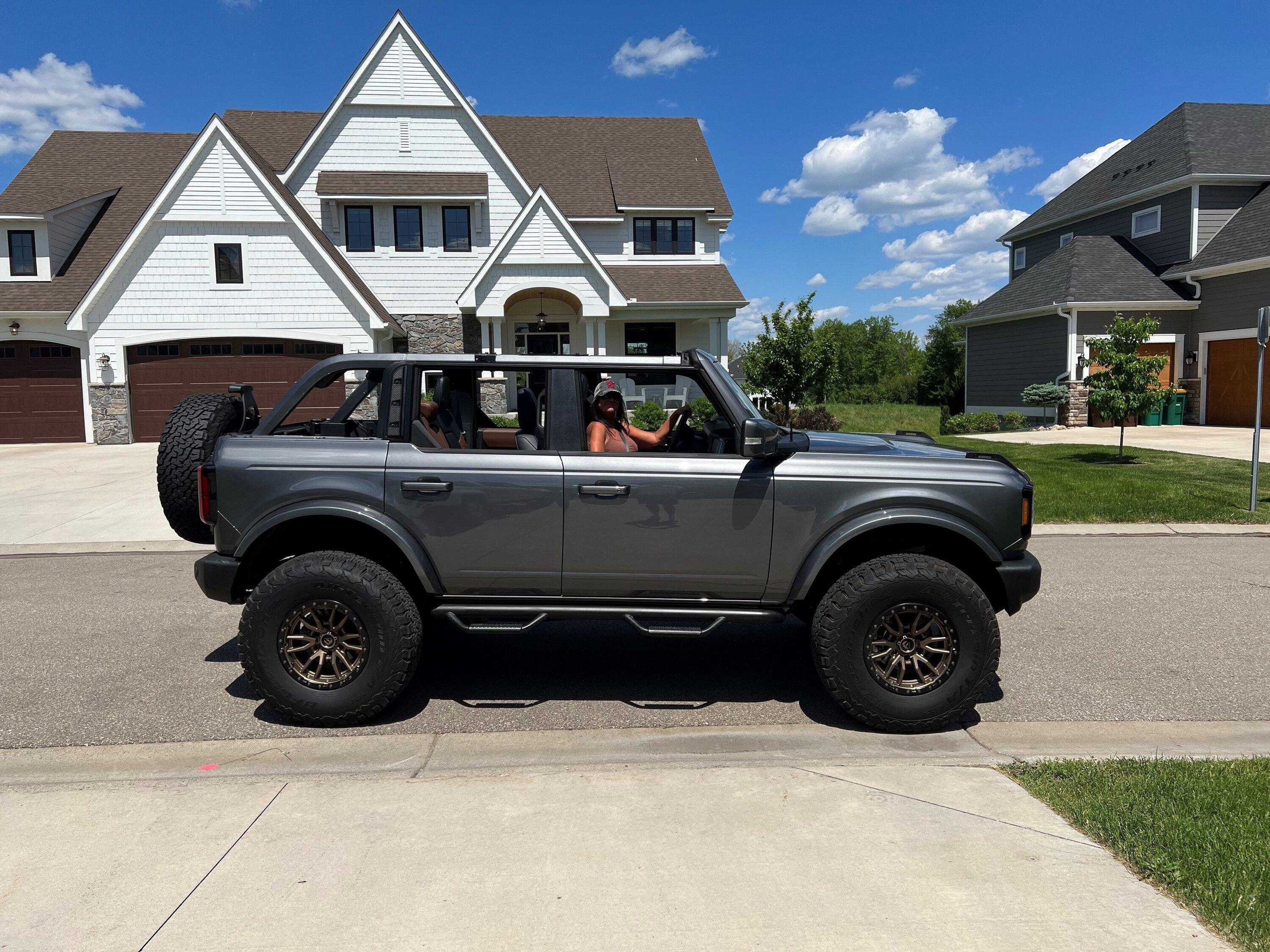

I've got a 2.3 OBX with 4.27 Final Drive on K02 37x12.5R17. 3.5 Inch Rough Country lift. Crash Bars removed. No rubbing, plenty of power and I think it rides great. I never drove the stock set-up, I had the dealer install everything before I took delivery. This definitely a "Mall Crawler". I am getting 20MPG which is every mile ever driven not just highway MPG. I will say that the stock third brake light is not tall enough. The Rough Country brake light extension was added. Fuel Rebels 6 are -12 Offset and 34lbs. The K02's are 66lbs. So, I'm at an even 100lbs.

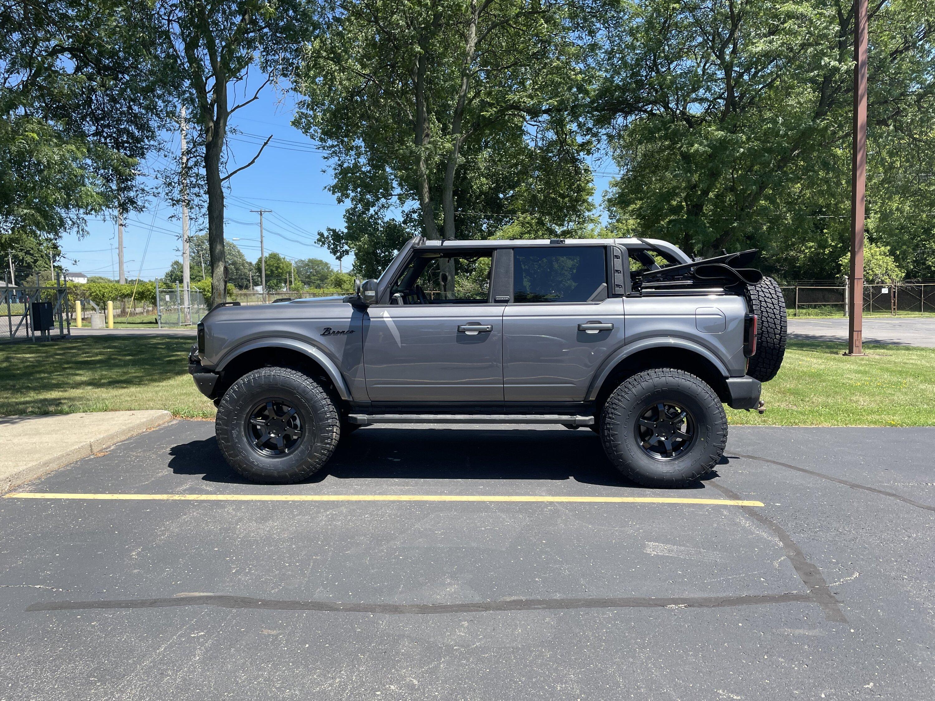

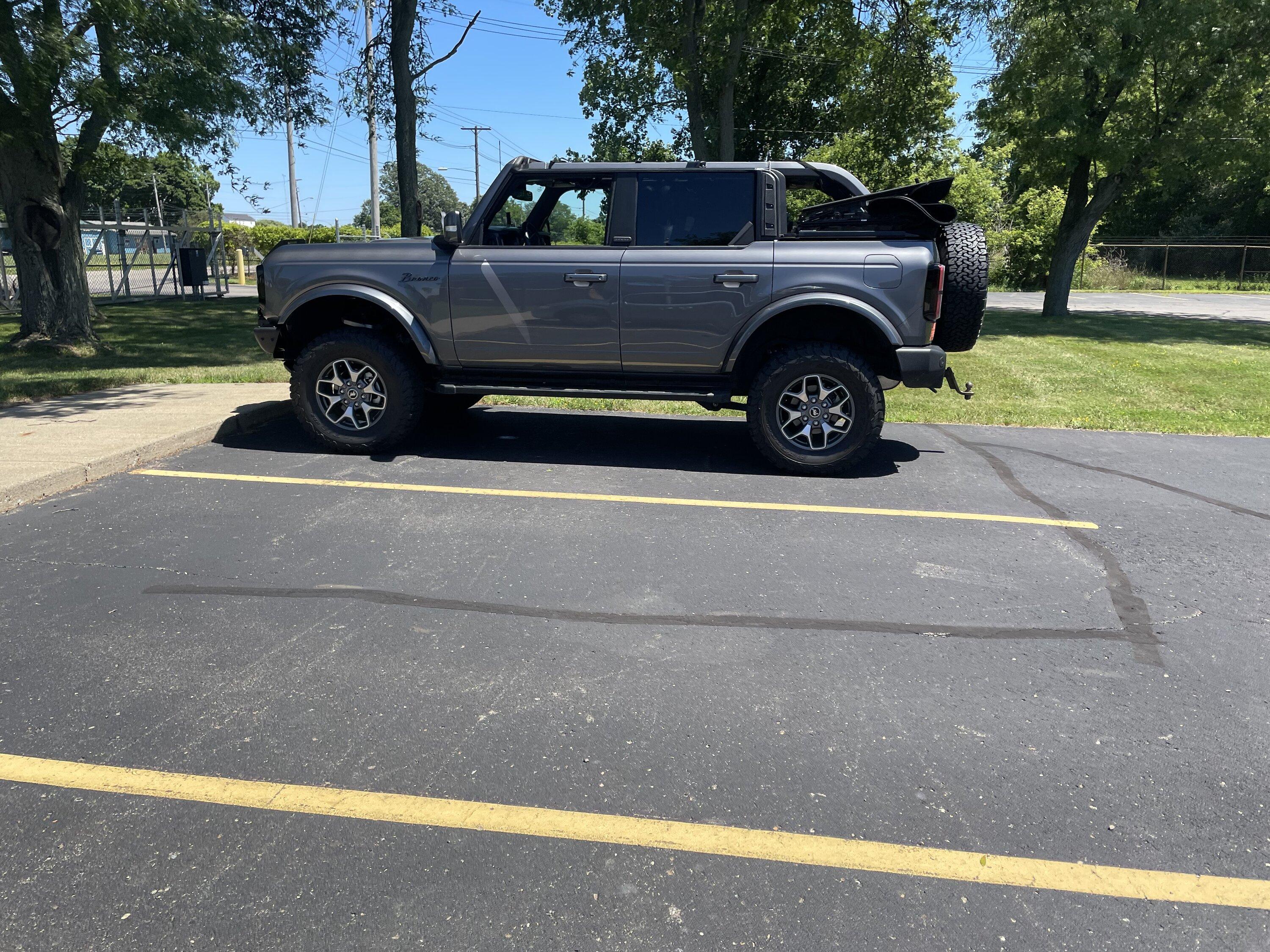

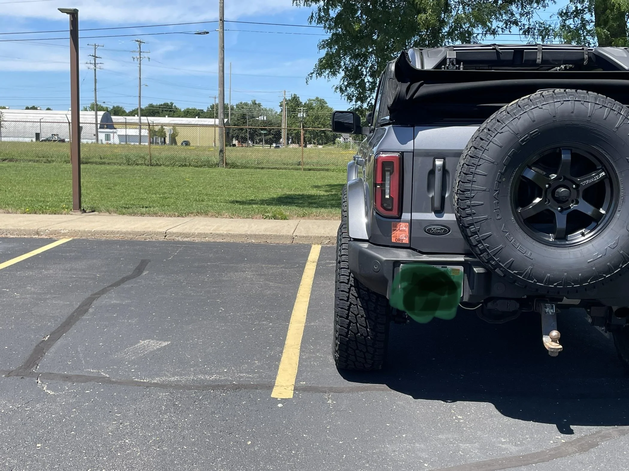

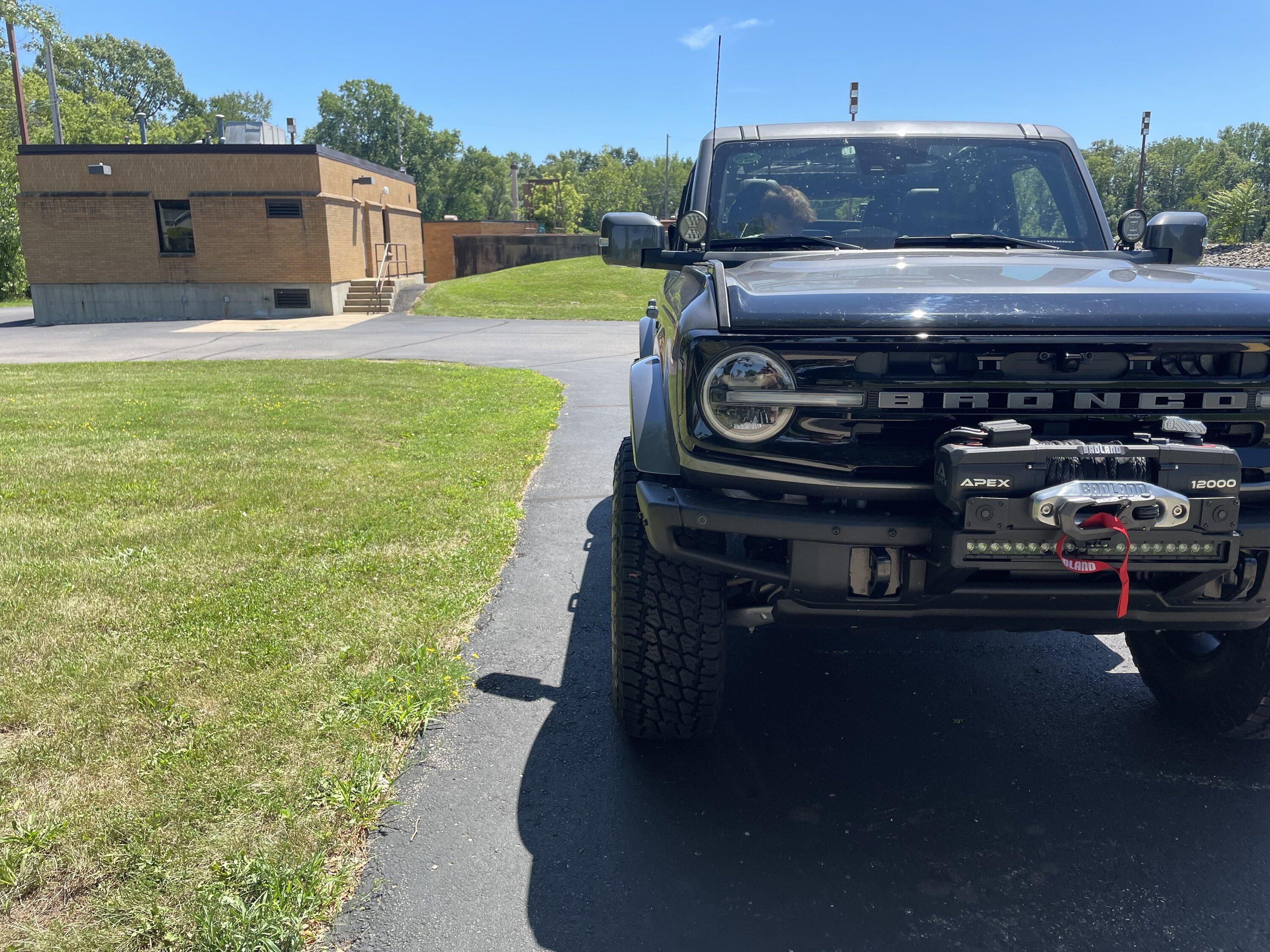

Got mine on today even tho the company forgot to send the lug nuts 🤦🤦. They fit well no rub. I may need to trim the crash bar mounts in back if they run when compressed. I’ll find out this weekend. I may also shorted the step bar by an inch. Not much poke which is what I wanted. I could have went with a little more aggressive tire in the pictures I thought these were close to the bfg A/T KO2 but they are quite a bit tamer. Oh well as long as they get me thru the Michigan trails and sand dunes I’ll be happy. Before and after
