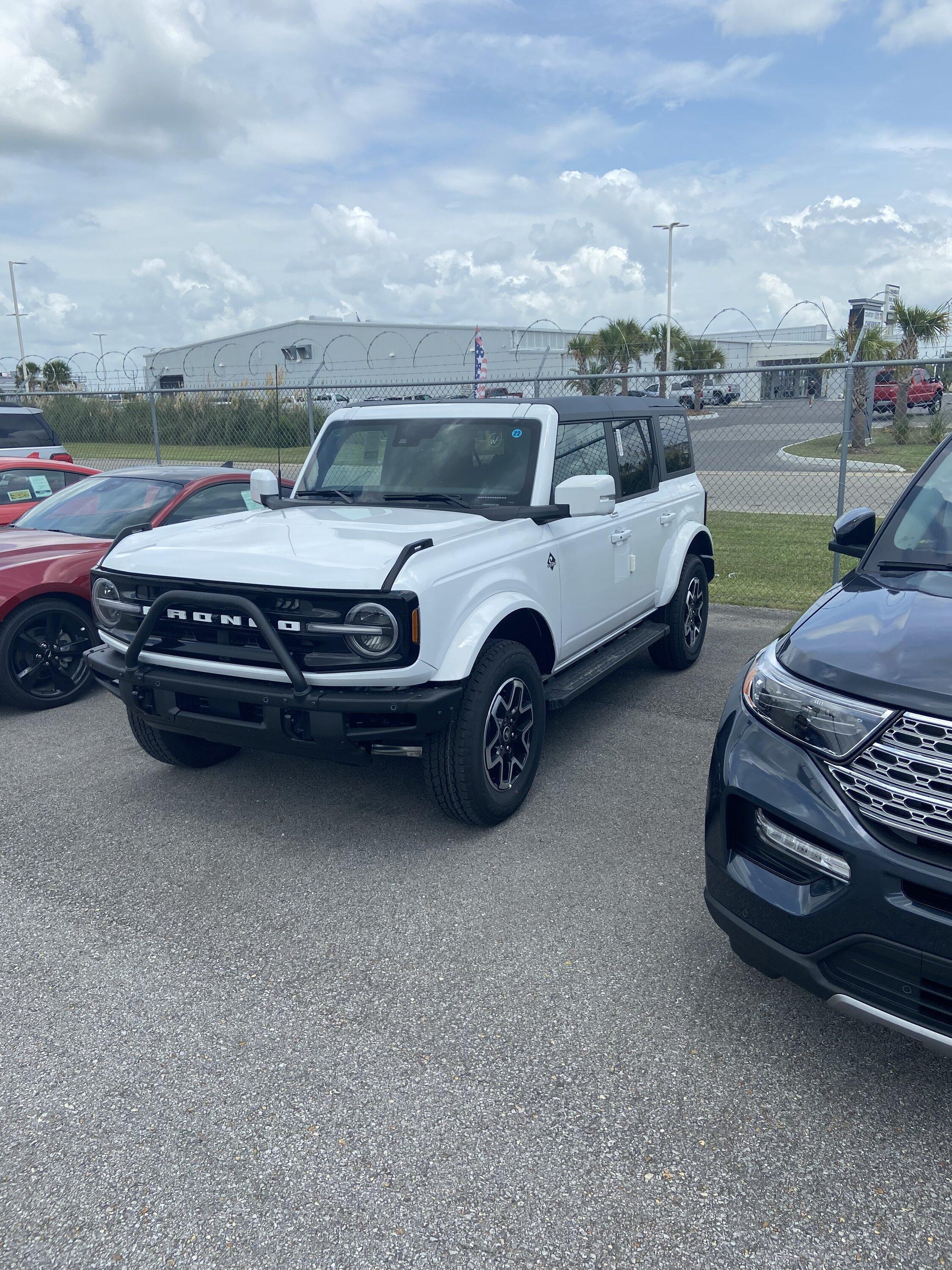

Bronco in! Upgrade pics in a month

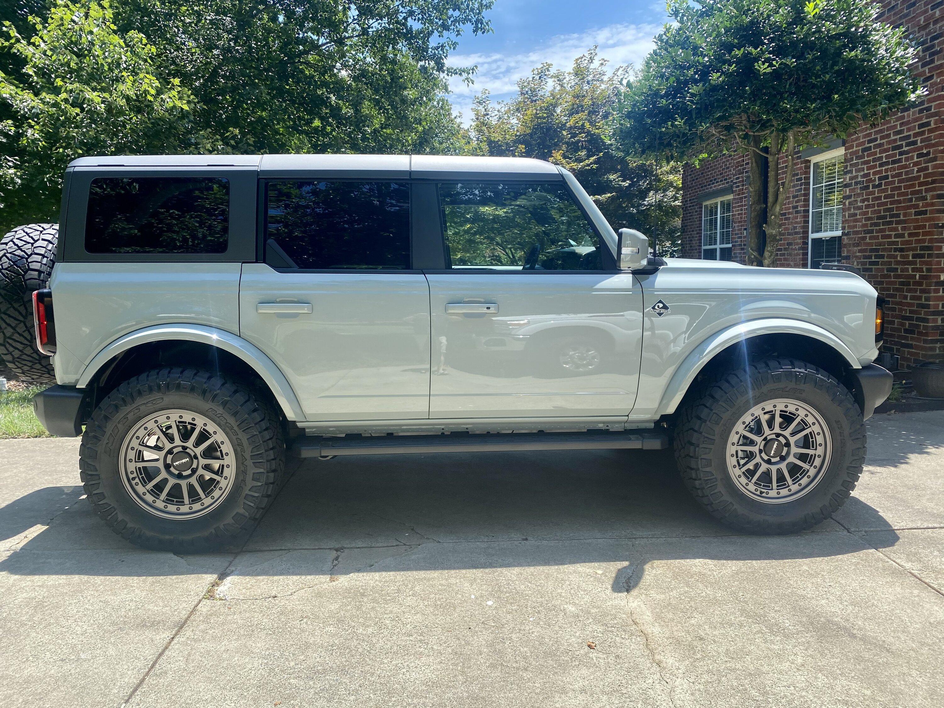

I am using geolandar x-at. City ride feels same as stock sasquatch
I also use the Geolander x-at tires. They are a great ride!

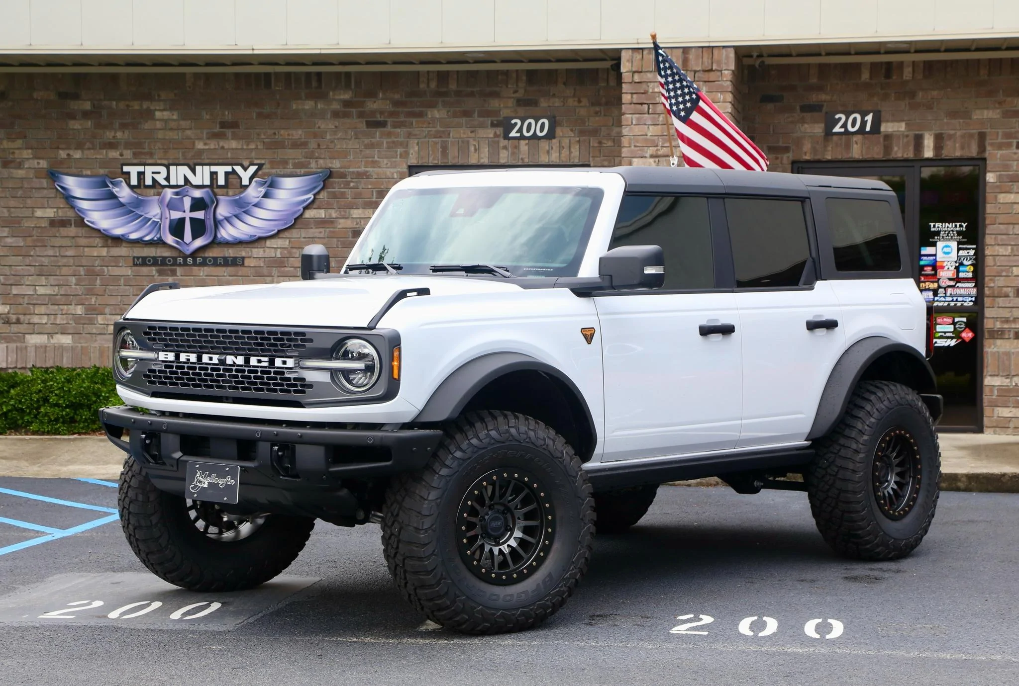

im running 37x12.5 on 8.5" wide 0mm offset with 3" lift. havent felt any rubbing anywhere. youll be fine
