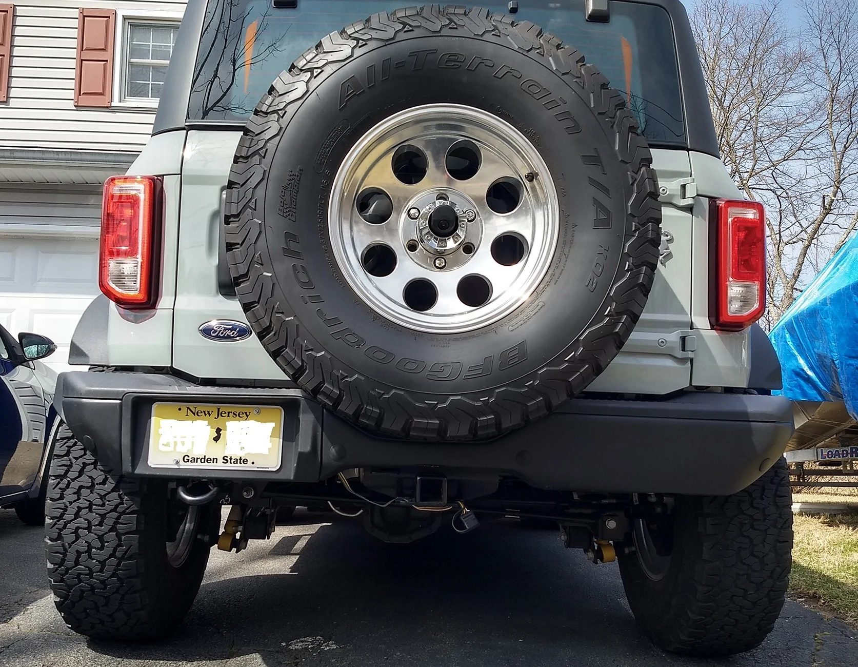

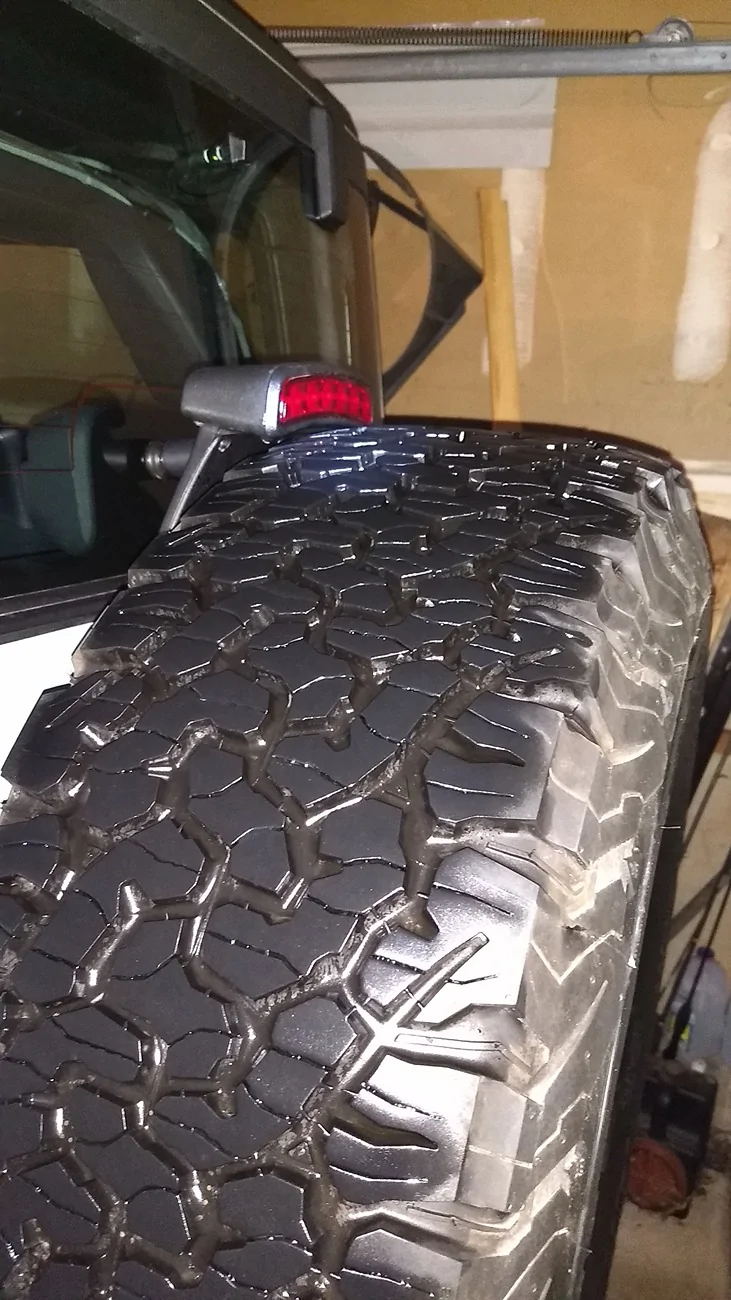

I've had no problems with the KO2 37x12.5x17 C rated tires I have. They aren't much heavier than the stock Goodyears (maybe 9 lbs) and they run small so closer to a 36. The spare fits without a bracket to lift the 3rd brake as well. If you go with aftermarket wheels, they will probably be lighter than the stock Sas wheels so you might even be within 4-6 lbs of stock with a C rated 37.
Edit: It looks like the stock Sas wheels are around 35-36 lbs and the ProComp wheels I have are around 24 lbs so the 9-10 lb increase in tire weight over the stock Goodyears is netted out by the 11-12 lbs of weight savings with the wheel. So in my situation there is no change in the wheel/tire weight vs stock Sas. A true 37 tire in D, E or F rating will probably weigh 8+ lbs or more.

Just joined the group and wanted to ask if any of you had your spare 37 on the factory spare tire carrier without any reinforcement? I’m looking to upgrade mine to 37 and want to put spare 37 on original spare carrier without reinforcement. I only will be using Bronco for daily driver, hunting blind and fishing hole . No real off roading, wanted your opinion if you had time.
thanks
Adam
Your scoop at first look assumed you had a bronco Raptor, but no. We have two bronco Raptors, daily drivers, stock tire size is 37s. We have had no issues with the 37 spare on the back, with the exception aftermarket wheels did produce a larger gap between tire and 3rd brake light. I think all bronco body parts have the same durability and functionality no matter the Trim. I think your good to go 37 all around.
