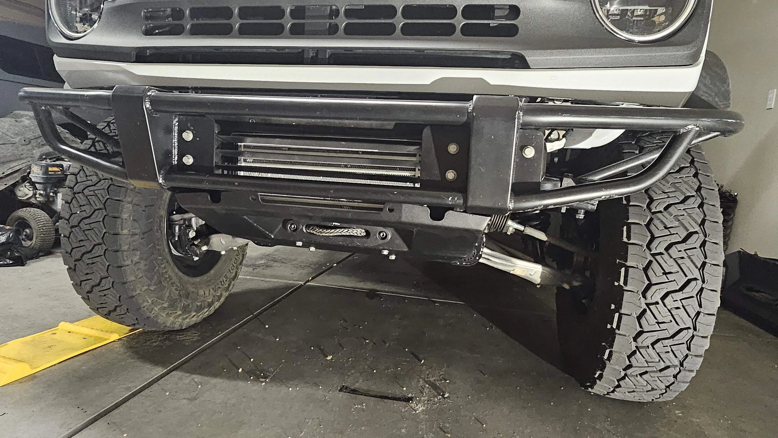

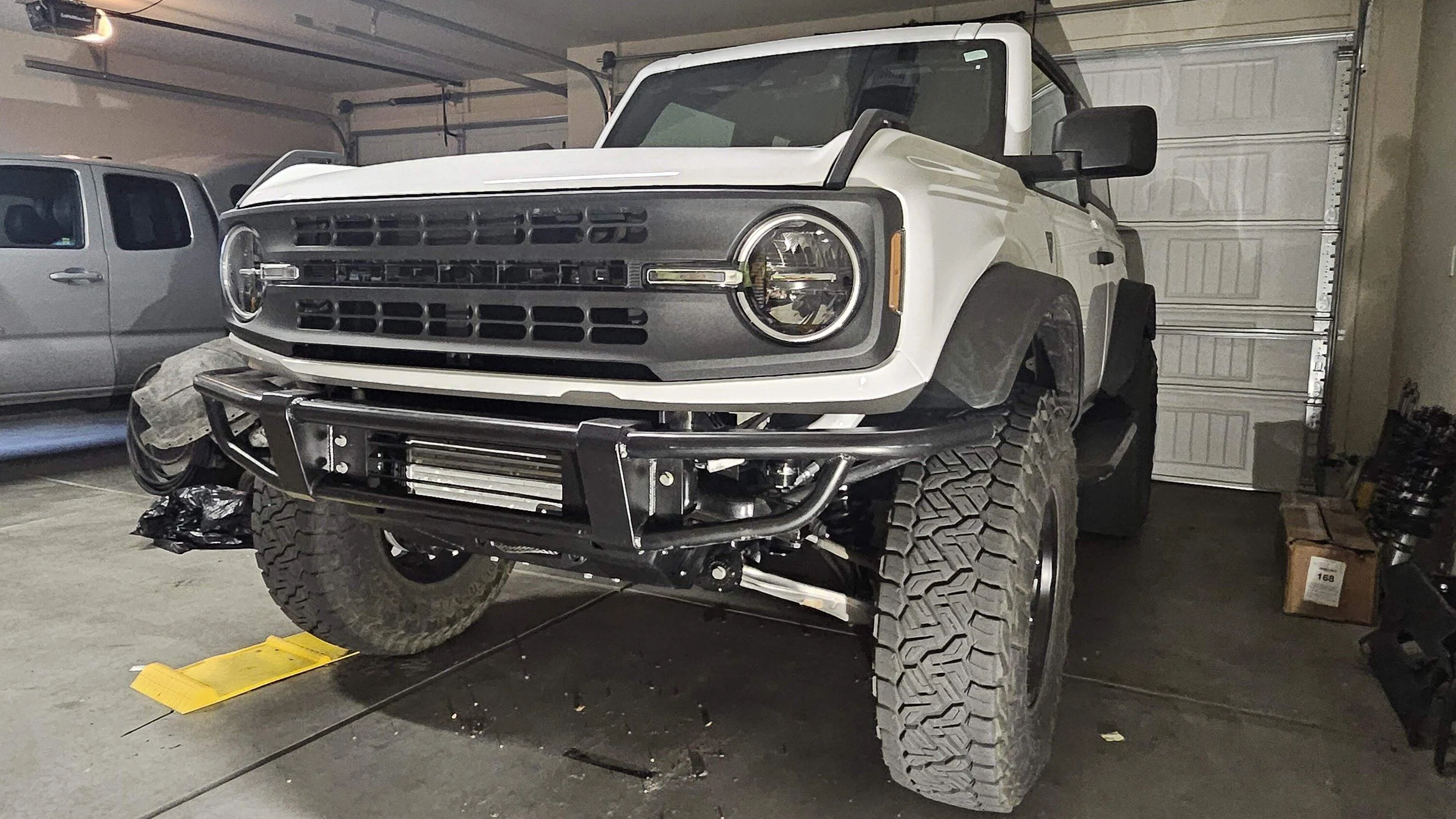

Any front and side view pics? Do you have a winch or aftermarket front bumper? Thanks.
Custom fabricated front/rear bumpers. Hidden winch.

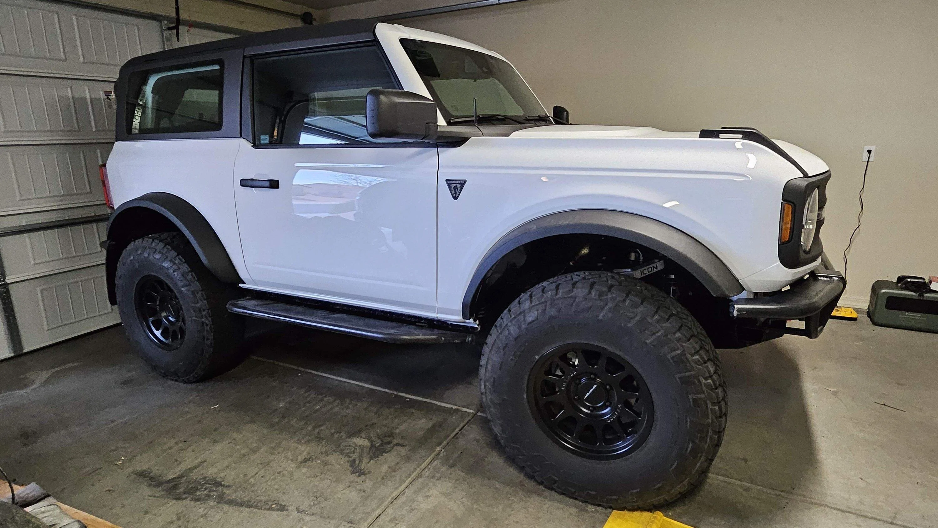

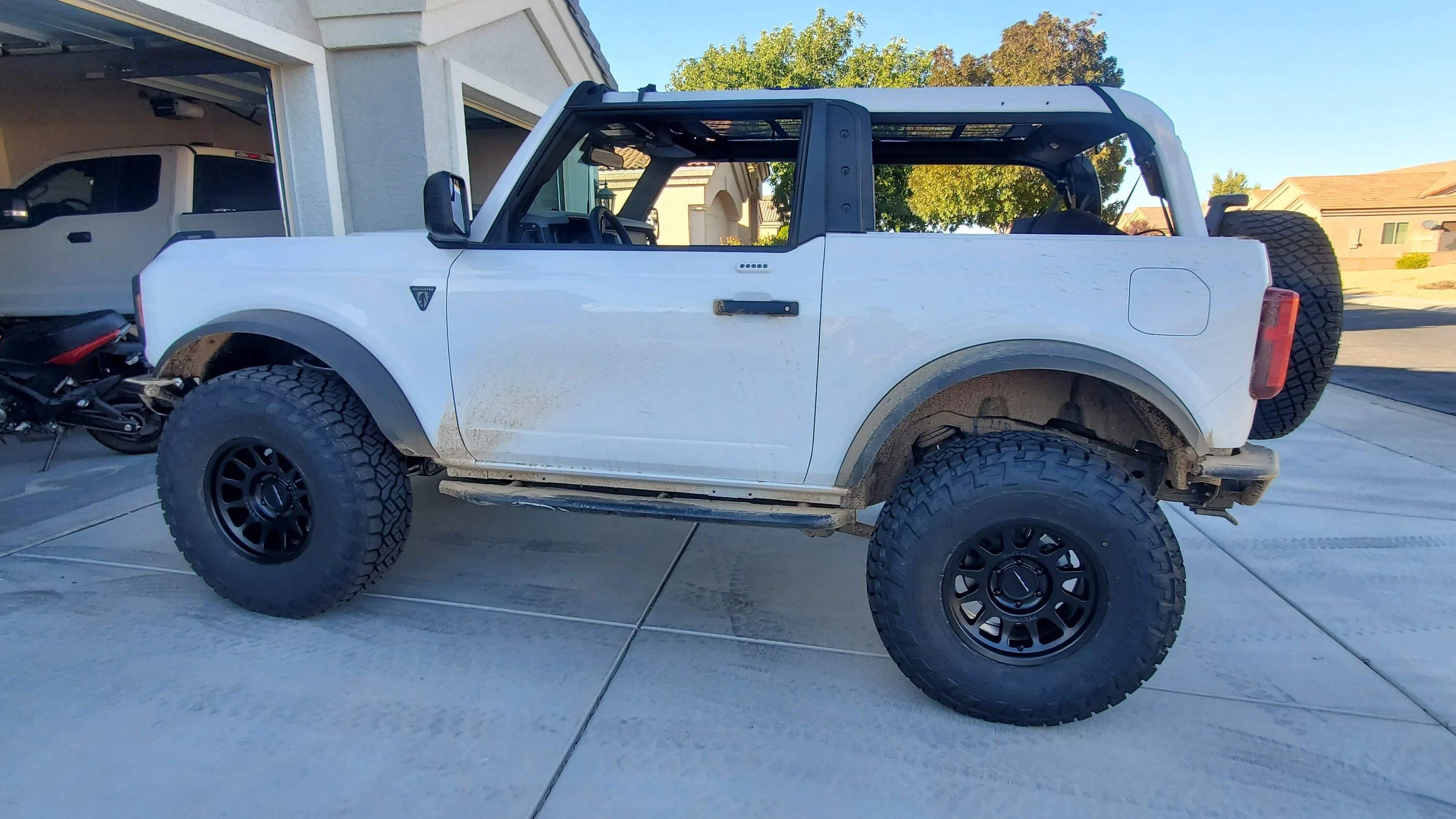

Narrow 37s fit much easier. Nitto Recon Grappler 37x11.5R17. Running Method 17x.8.5 - 0 offset. Only rubbed at top of fender (due to chopped shock bumpstop).
Tire tread measures the exact same as the factory Sasquatch tread width.

You may need wheel spacer (stock wheels) or 17x8.5 with zero offset to help with inner (frame clearance). It may rub the top of the fender at full compression depending - think hitting a large bump or jumping. I have plenty of clearance otherwise.
I figured these tires would be incredibly popular for the Jeep and Bronco world. Extremely ideal in many regards. Less width is much less stress on wheel bearings, steering, ball joints and just less mass for braking/acceleration.

Thanks! Was looking to see how your front end sits with the Icons and a winch. Which Icon set up did you use?​
Icon CDEV - Billet Upper Control Arms - Welded lower control arm tabs with cam plates: lower cams locked in at zero degrees (to avoid CV axle overextension).
Currently have 2.5" extension travel from ride height (in front). Will see how they settle. I'd like to have them set about 3" extension travel from ride height. If we went portals I'd lower the front to 4-4.5" extension travel from ride height (which would be ideal for CV and tie rod angles).
Front bumper has louvers to direct air into the intercooler and removed the active flaps (terrible for air flow). Also removed the radiator active flaps. Massive difference in engine operating temperature (stays around 200 degrees or less). Front bumper is crazy light weight - similar or less than the plastic factory bumper.
Lobo hidden winch mount - haven't tested it on the rocks yet. Destroyed the RC hidden mount after 3-4 trails.

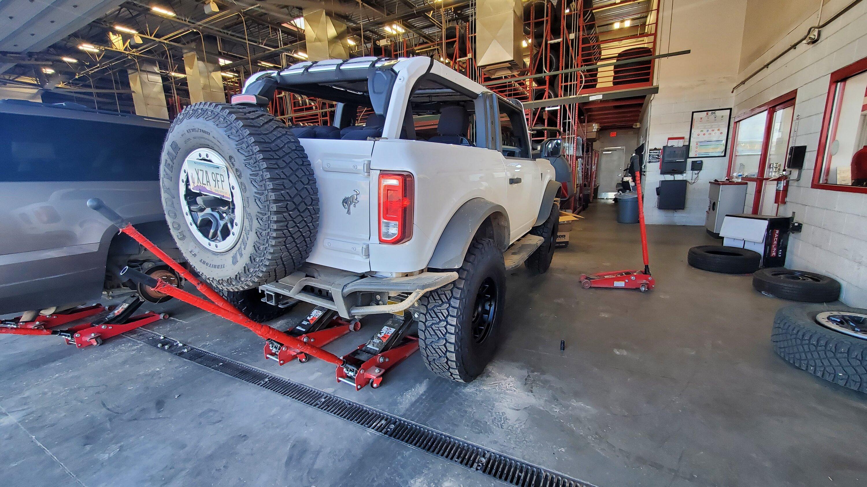

Hey! We recognize that shop. Thank you for your business!
Absolutely. Been a customer for decades. Typically buy 1 or more sets of tires per year. May have vehicle obsessions... :)
