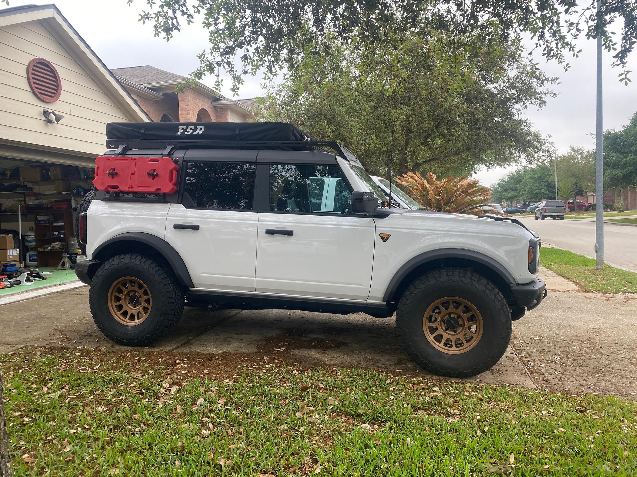

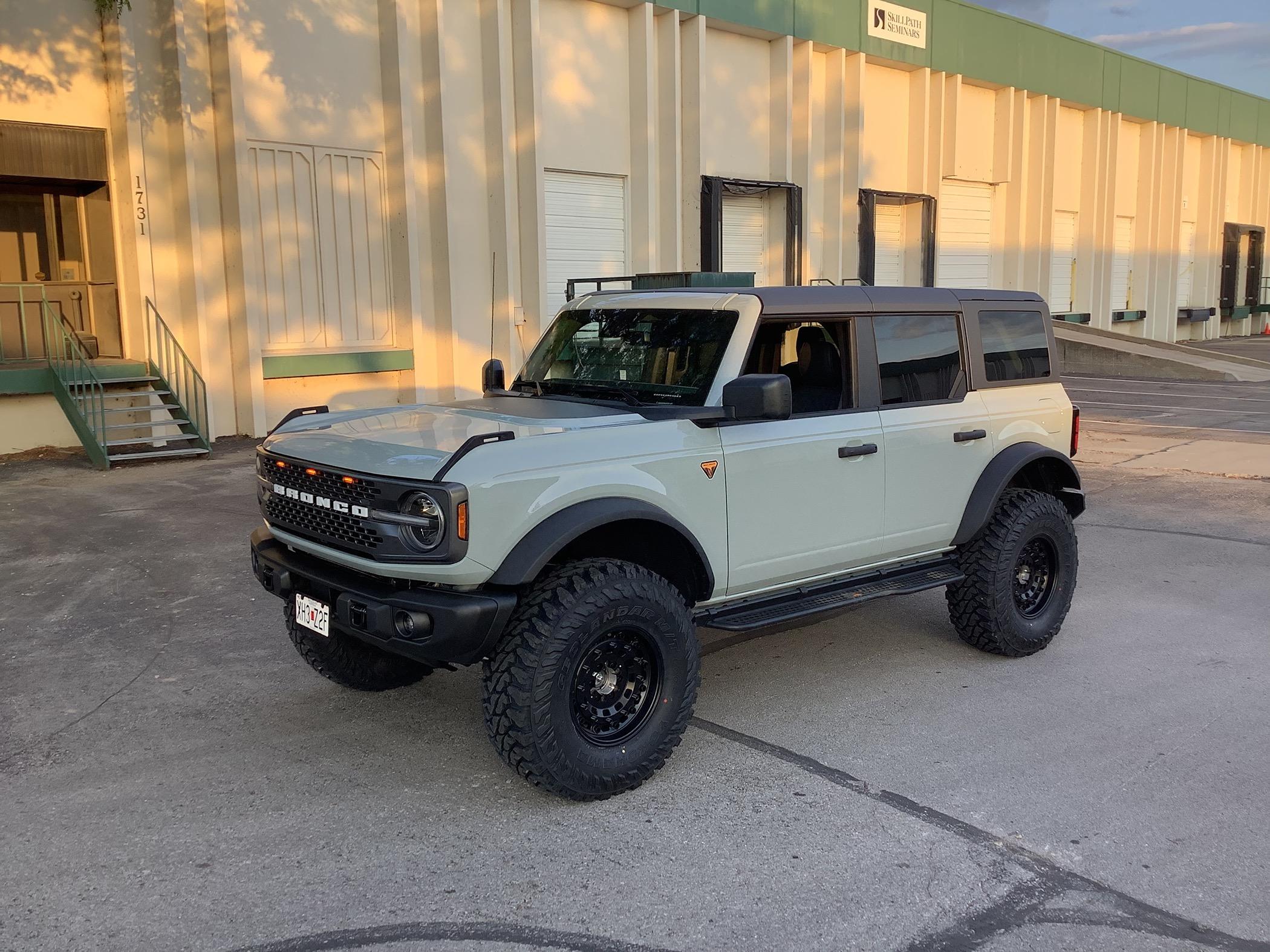

I also have a ‘23 Badlands Sasquatch. Just added 37” BFG KO2s, Fuel Anza wheels with -6 degree offset, and Icon stage 3 adjustable lift. With this combination of tires, offset, and adjustable lift, I have absolutely no rubbing. Did not require perch collars, spacers, or clearance kit.
Putting the Icon lift on in place of those things is a more expensive option but, IMO, offers the highest quality ride and will be easier on the front end and CV joints in the long run.
Ford Bronco What upgrades needed to run 37” tires on a Badlands Sasquatch Bronco? IMG_0879

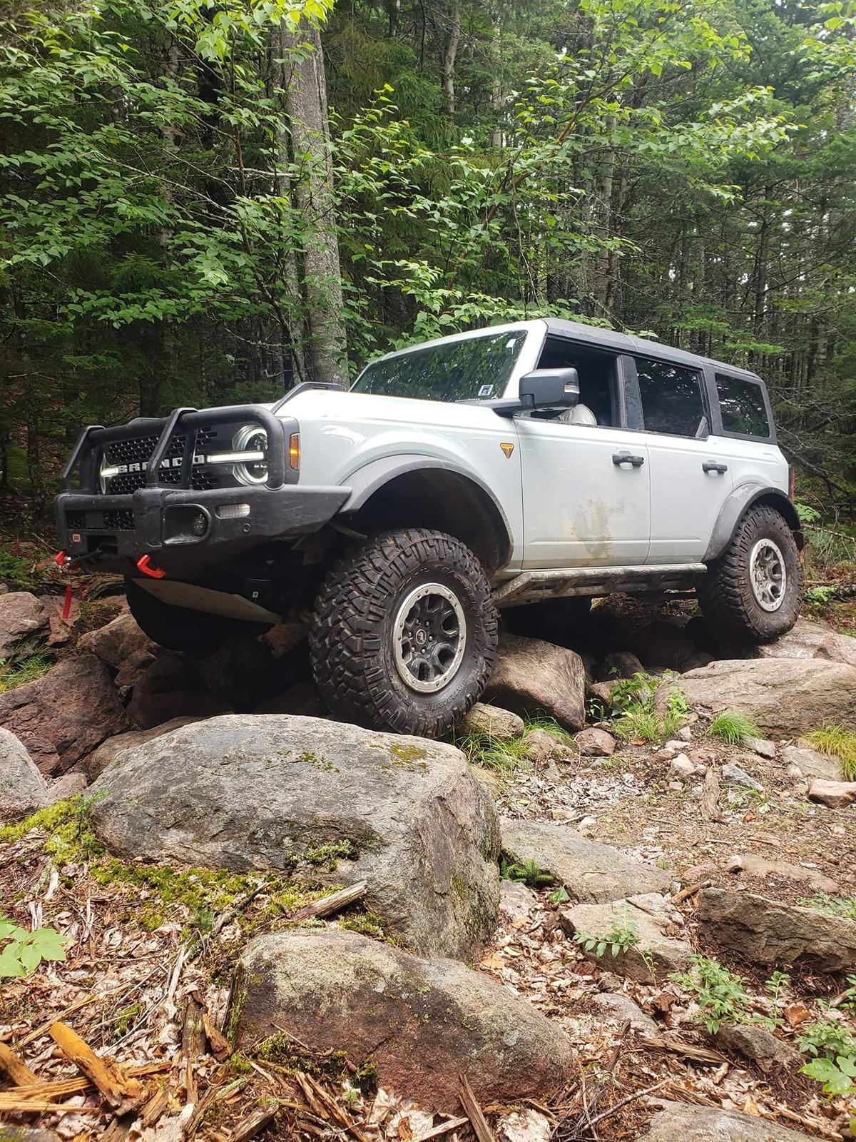

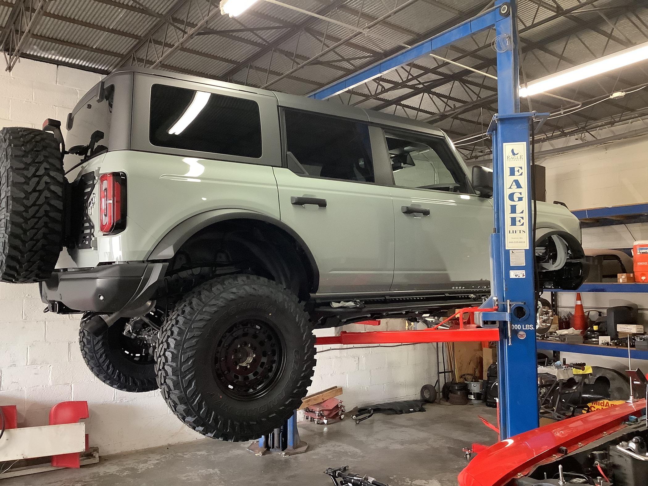

Absolute minimum for me on my 2024 Badlands Sasquatch with 37” BFG ATKO2s was a Lobo Offroad crash bar delete. In addition to replacing the front crash bar.body mount with that, I also cut off the rear crash bar (by the firewall).
No rubbing so far, but I haven’t done any serious off-roading since then, either. Wheels are Method 703 0 offset/4.75" backspacing.
Ford Bronco What upgrades needed to run 37” tires on a Badlands Sasquatch Bronco? IMG_2155
Full disclosure: I’m installing an Icon Vehicle Dynamics stage 4 lift kit in the near future before I go off-road, though.

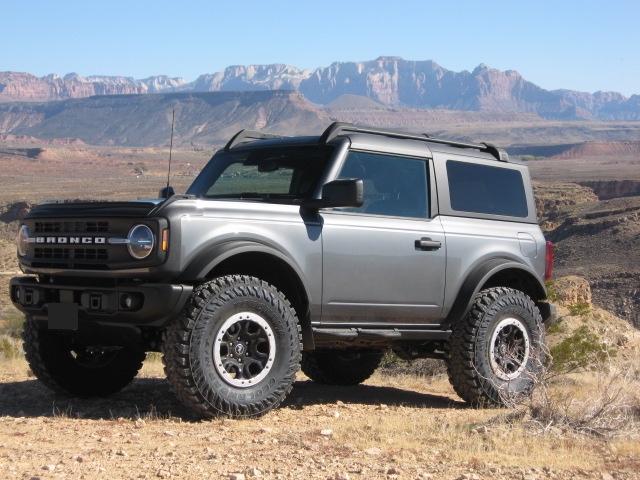

Unless you're extreme rock-crawling all you need is Leveling Kit and re-alignment then add your 37's to your factory SQ wheels no problem
In lots of very rugged off-roading the only rubbing I've had is reverse at full lock, and we're talking minor rubbing - almost nothin
Broncos are just made for 37's
The link you sent is for a 1.25" leveling kit. Is that all you need to fit the 37s like you say? Your 2Dr bronco looks great in this pic! What exact tire size and brand did you go with if you don't mind me asking?

my photo above is 37x12.50r17 with a 1.5" spacer for a little extra poke
