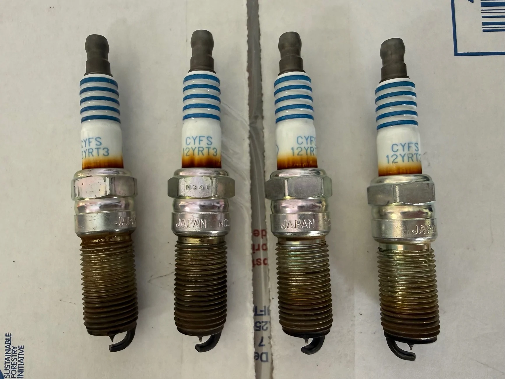

This is what they look like at about 40k miles. New plugs changed the sound and the idle for the better, ie quieter and smoother.

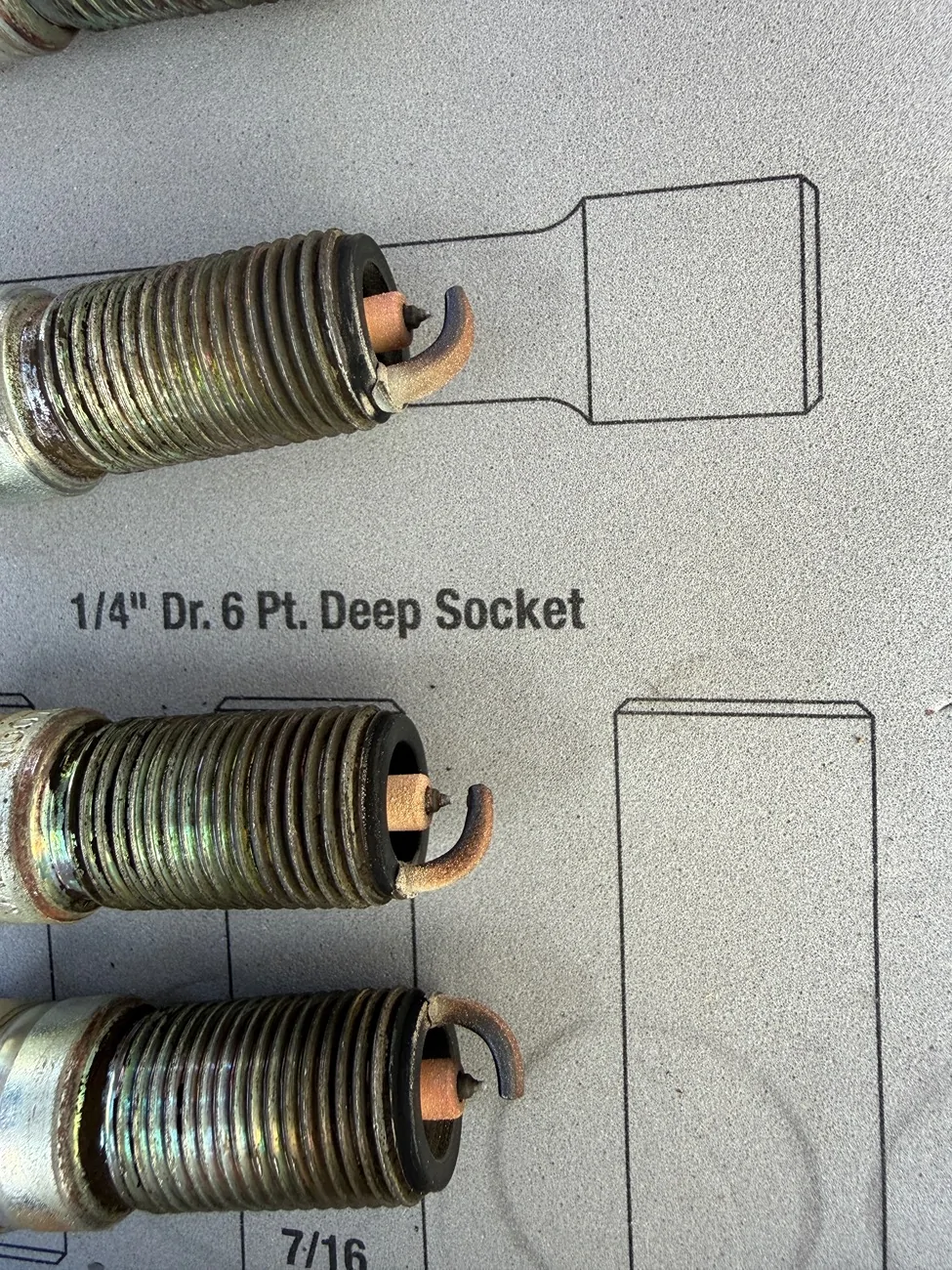

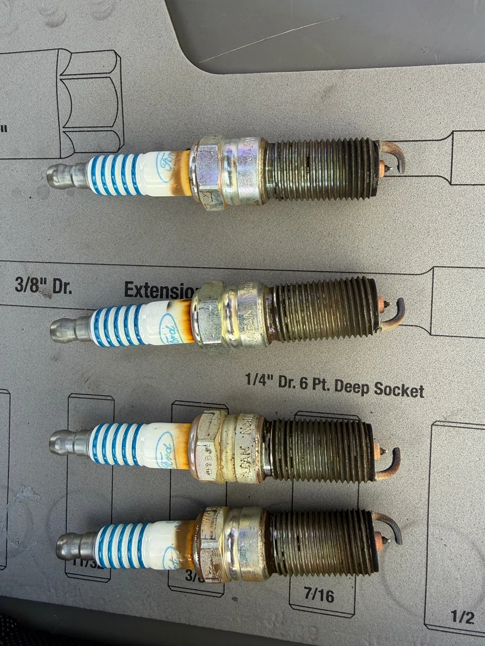

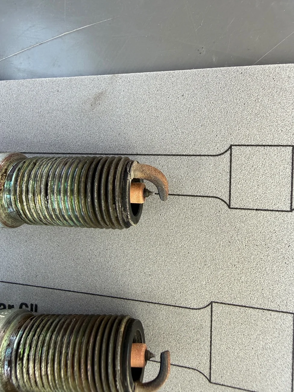

Finally changed mine. Maybe a little improvement in performance or maybe its in my head. I was hoping for more. Will investigate carbon build up on valves. Here are the plugs:
Ford Bronco 2022 2.3L Getting Sluggish IMG_0561
Ford Bronco 2022 2.3L Getting Sluggish IMG_0559
Ford Bronco 2022 2.3L Getting Sluggish IMG_0560
