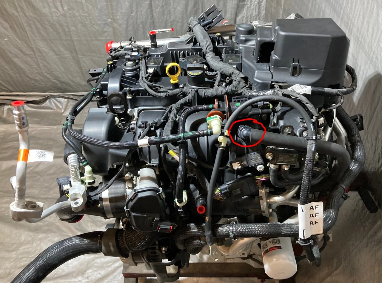

I'm a big NGK plug fan, and 70k on any turbo engine is probably overdue for plugs.
I don't have a 2.3 in front of me, but looking at this pic I found, the hose on the intake manifold at cylinder 4 looks like it can be removed.
Ford Bronco 2022 2.3L Getting Sluggish 1000059402
Look inside that hole with an endoscope/inspection camera (cheap on Amazon and insanely useful) and you can probably see the intake valves.
