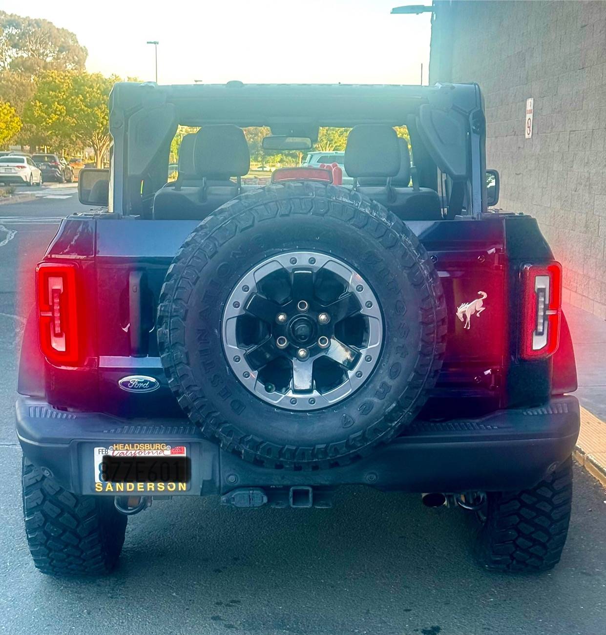

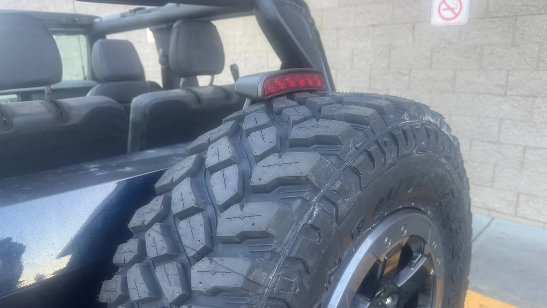

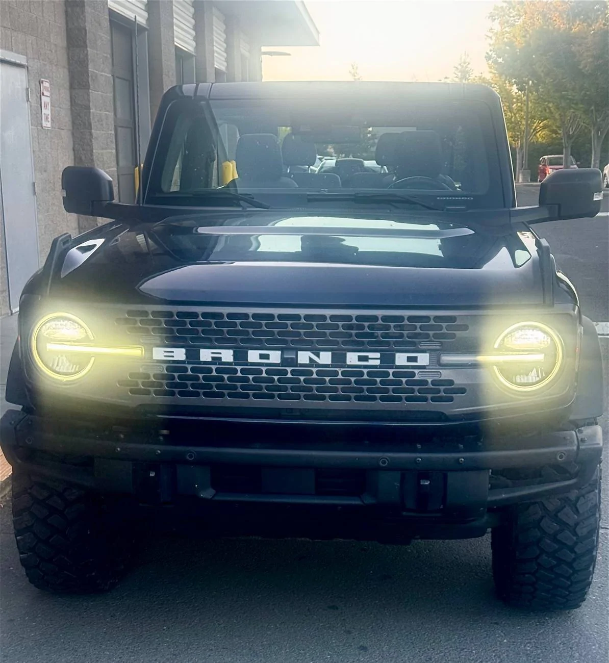

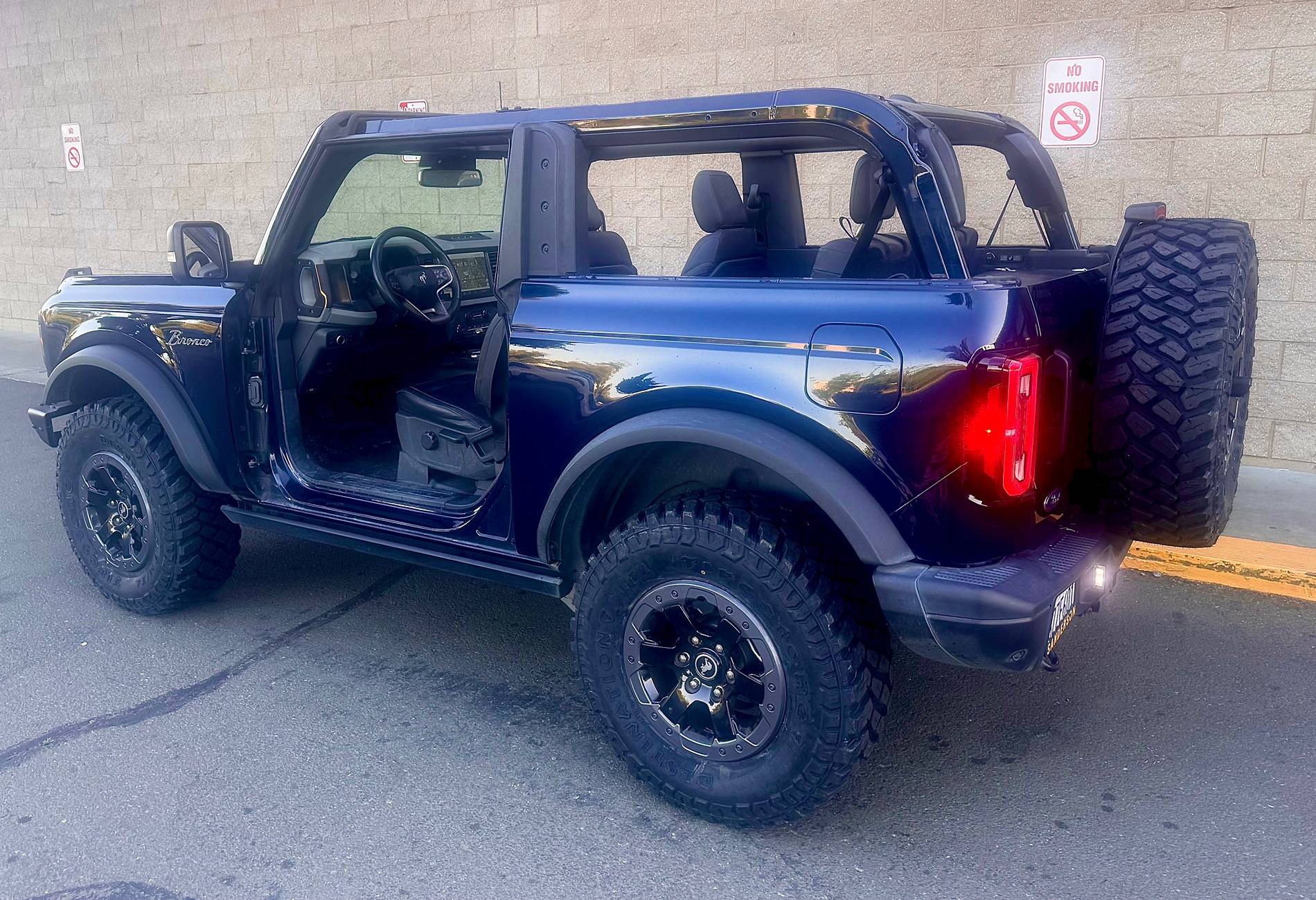

Anyway. My Bronco is back. Runs great! Picked it up this afternoon and went straight to Costco for tires. Looks awesome imo.
Firestone M/T 295/70/17.
