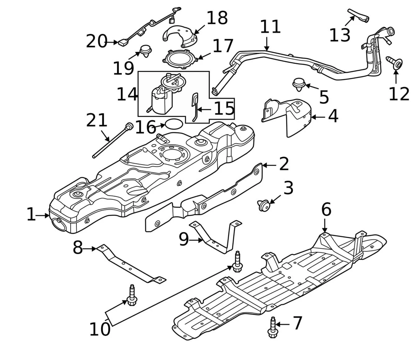

so when the pump is removed what keeps the fuel from leaking out?
bf4445

You said the pump was removed from the top right? So if the top and bottom are open what keeps the fuel inside?
The bottom is never opened, there's no penetration or anything on the bottom of the tank.
The top has penetrations for the filler line, and a relatively large opening for the fuel pump/level detection assembly to drop down into (that has a gasketed cover that bolts on)
Stealing image from Ford Parts:
The part in the box is the fuel pump/level assembly
Ford Bronco 2.3L 7sp badlands engine stopped on freeway Untitled

Ahh...thanks, boy was I out to lunch.
Seems like years ago i changed a pump with a similar arrangment from inside the vehicle. There was an access plate when removed allowed the assembly to be removed without removing the tank.....maybe was a German car???...don't remember
Dosen't look like a bad design except for having to remove the tank.
