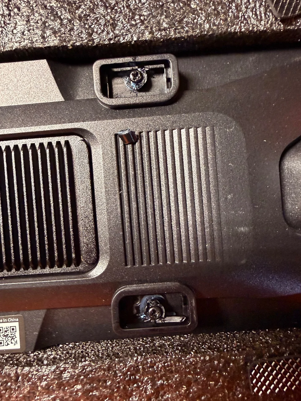

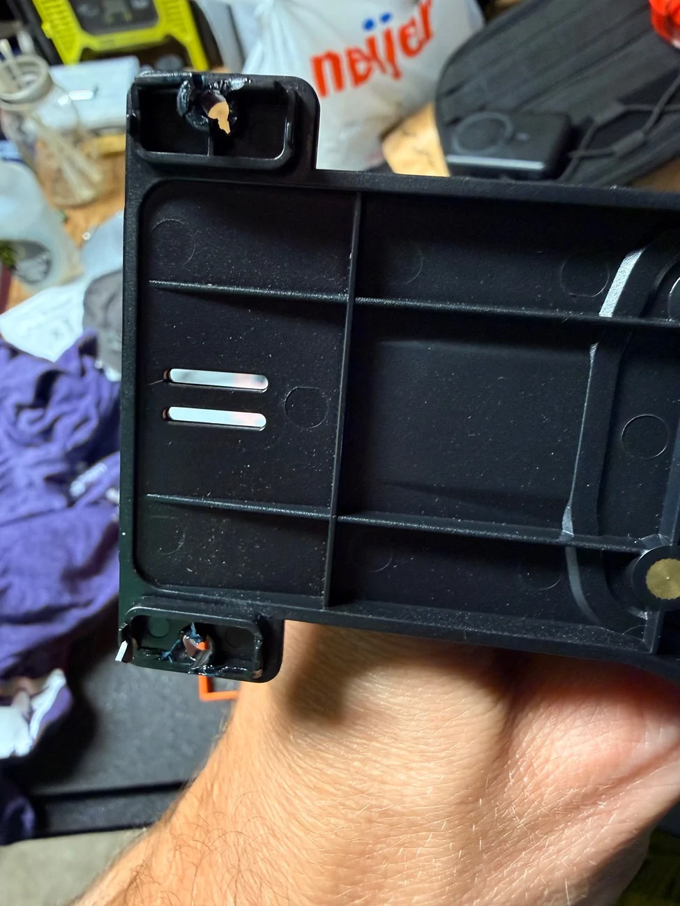

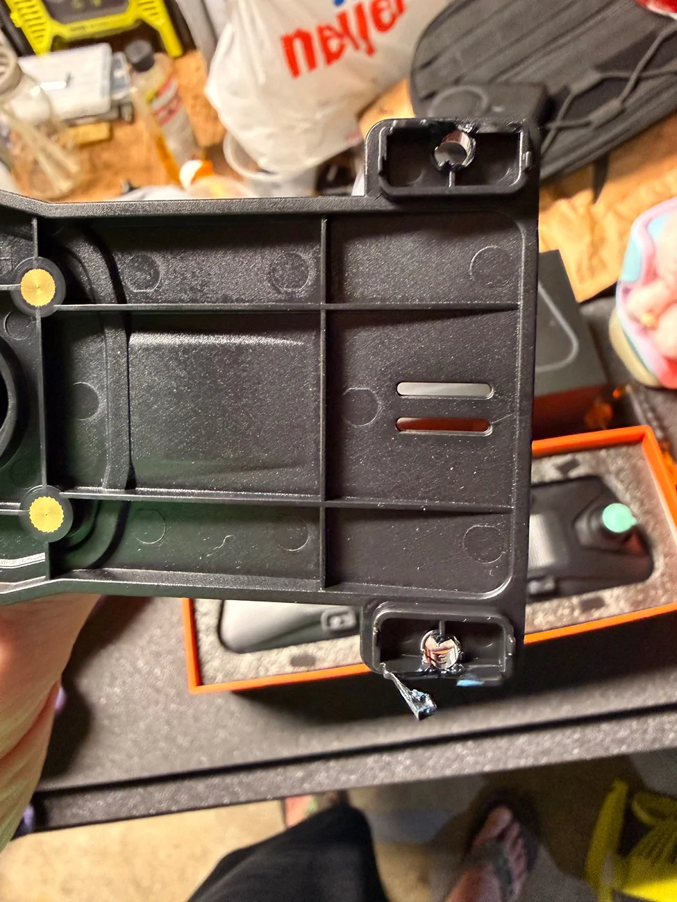

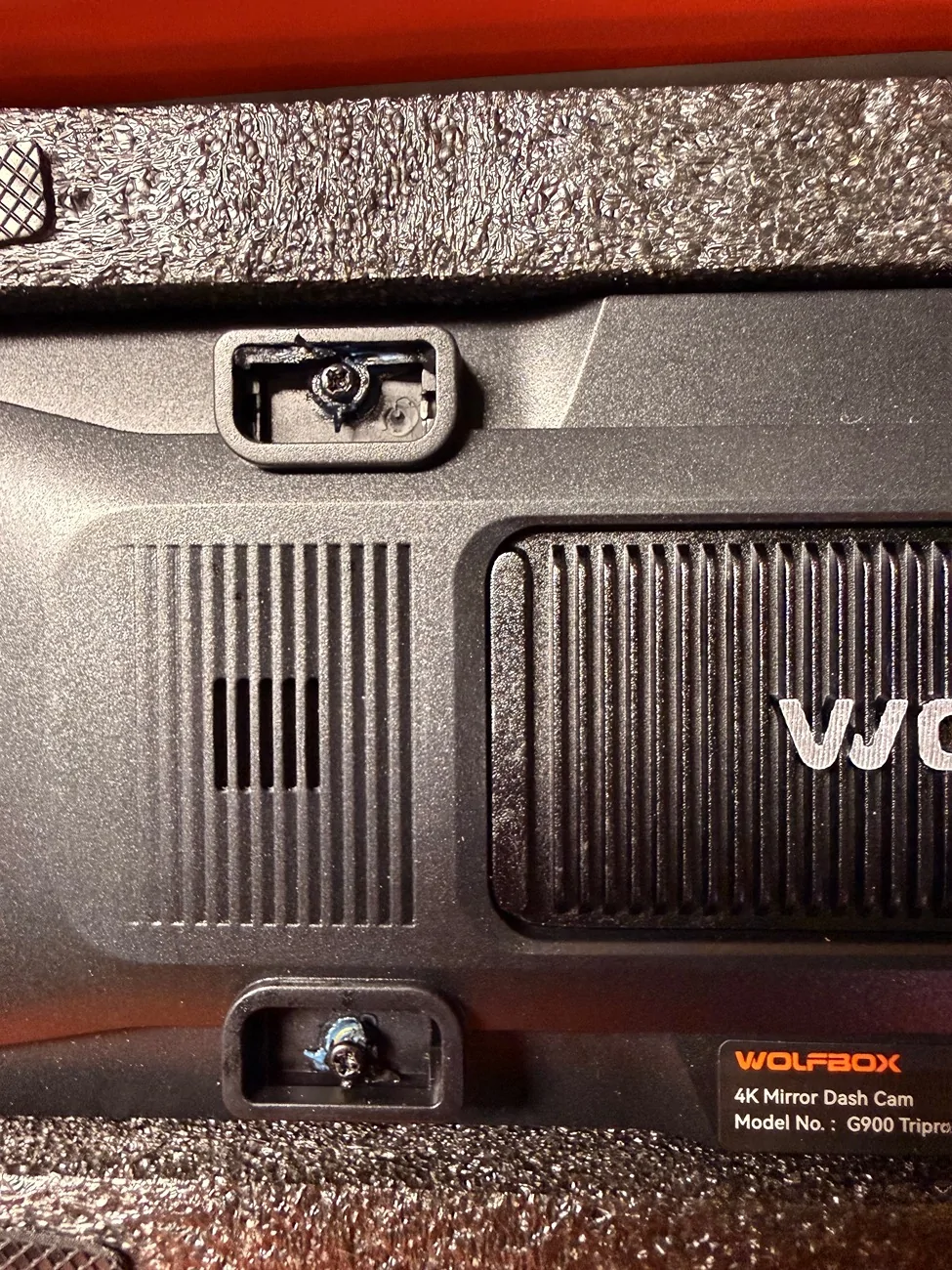

UPDATE: After reading through the replies here, and more closely examining the bracket, I can only assume it was my use of Loctite that was the main cause of the issue. I know someone mentioned it wouldn't have degraded the plastic that quickly, but I don't know what else could be to blame unless it was a faulty bracket. I am extremely confident I didn't overtighten the screws as I was being over cautious to not do so. The four mounting points didn't just seem to crack, they seemed to almost crumble apart.
I wanted to share my experience with the Wolfbox G900 TriPro in case anyone is on the fence about buying one. As much as I wanted to like it, I will be returning mine.
While installing, the mirror broke clean off the OEM bracket and came off in my hand. I’ve attached photos showing how it failed. I was already concerned with how cheap the bracket felt (it is mostly plastic), so I was very careful, holding the screwdriver only between my thumb and index finger to avoid over tightening. Even with that caution, it snapped before I could finish attaching it to the windshield.
It happened when I went to adjust the mirror angle to get a better line on the screw. All four attachment points gave way at once. I honestly sat there for ten or fifteen seconds trying to figure out how it could have happened before it sank in that the bracket had completely failed.

I can’t really figure out how it could have broken like that. You used loctite? I suspect you used a product not compatible with plastic and that caused the failure.
From Google. “Is loctite compatible with plastic?”
No, not all Loctite products are compatible with plastic; it depends on the type of Loctite and the specific plastic. Some anaerobic thread lockerscan chemically damage and cause stress cracking in certain plastics like polycarbonate and ABS.

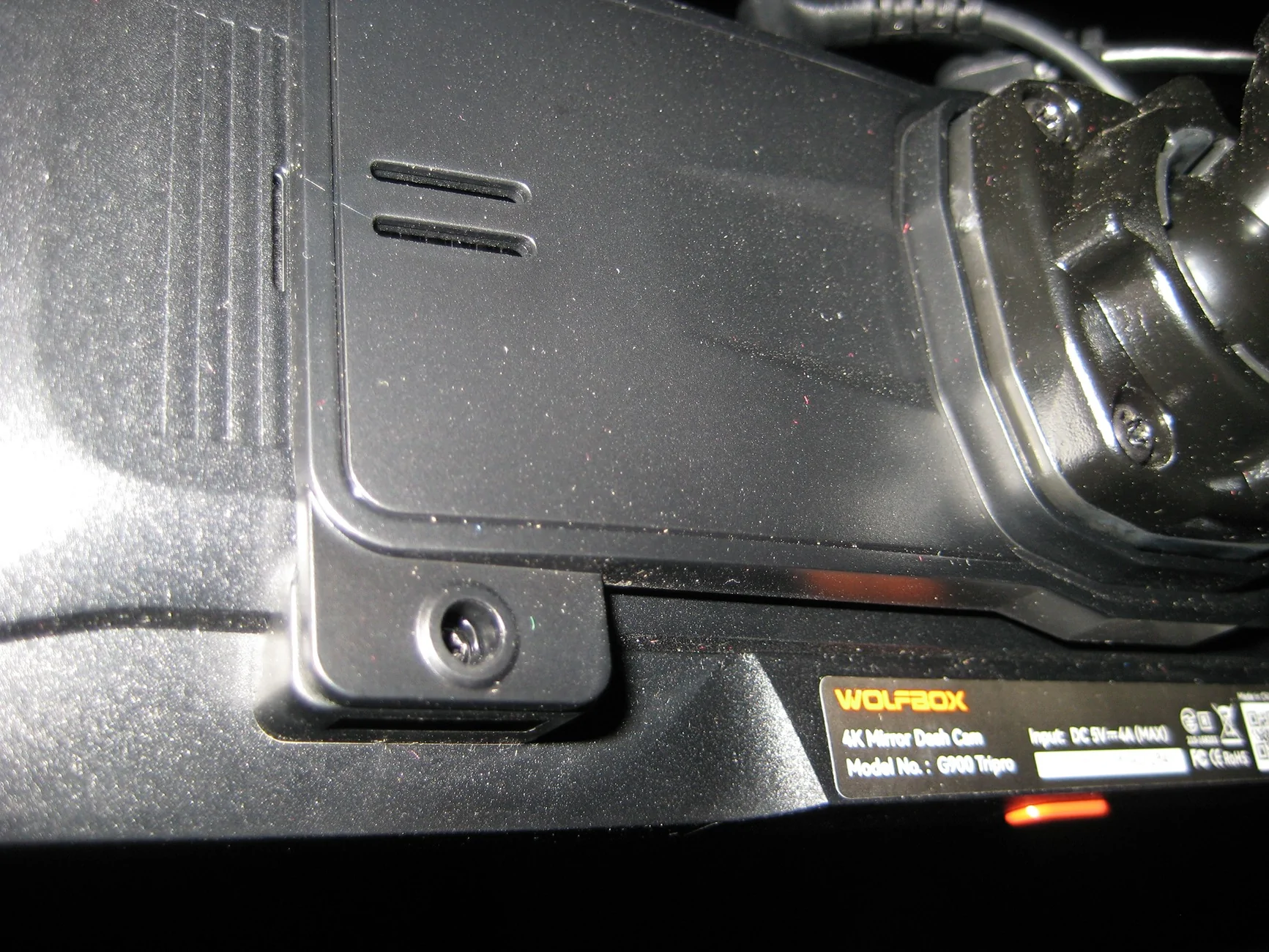

This is what mine looks like after 5 months of use. No problems. I found that it does vibrate a little when going completely topless at higher speeds because of the wind. But not enough to be a problem.

Why are the screws all surrounded with super glue? The bracket looks like it was damaged by a chemical reaction to whatever you put on it.

My last job I worked for Henkel - makers of Loctite. My current job I work for makes gorilla glue and vibratite (competitor to loctite). Thread locker and sealant is a pretty diverse product group and we have customers use it wrong all the time. However, no way blue loctite penetrated and degraded the plastic that fast. Assuming you put it on, threaded the screws and then mounted it. I will say, much easier to put the arm on the mirror bracket then put the whole assembly on the glass mount.
With that said, that OEM bracket they sell is a piece of shit. too flimsy and allows the vibration. They will replace that thing tho for you, customer service is great. I had a camera fritz out and they sent a replacement quickly.
