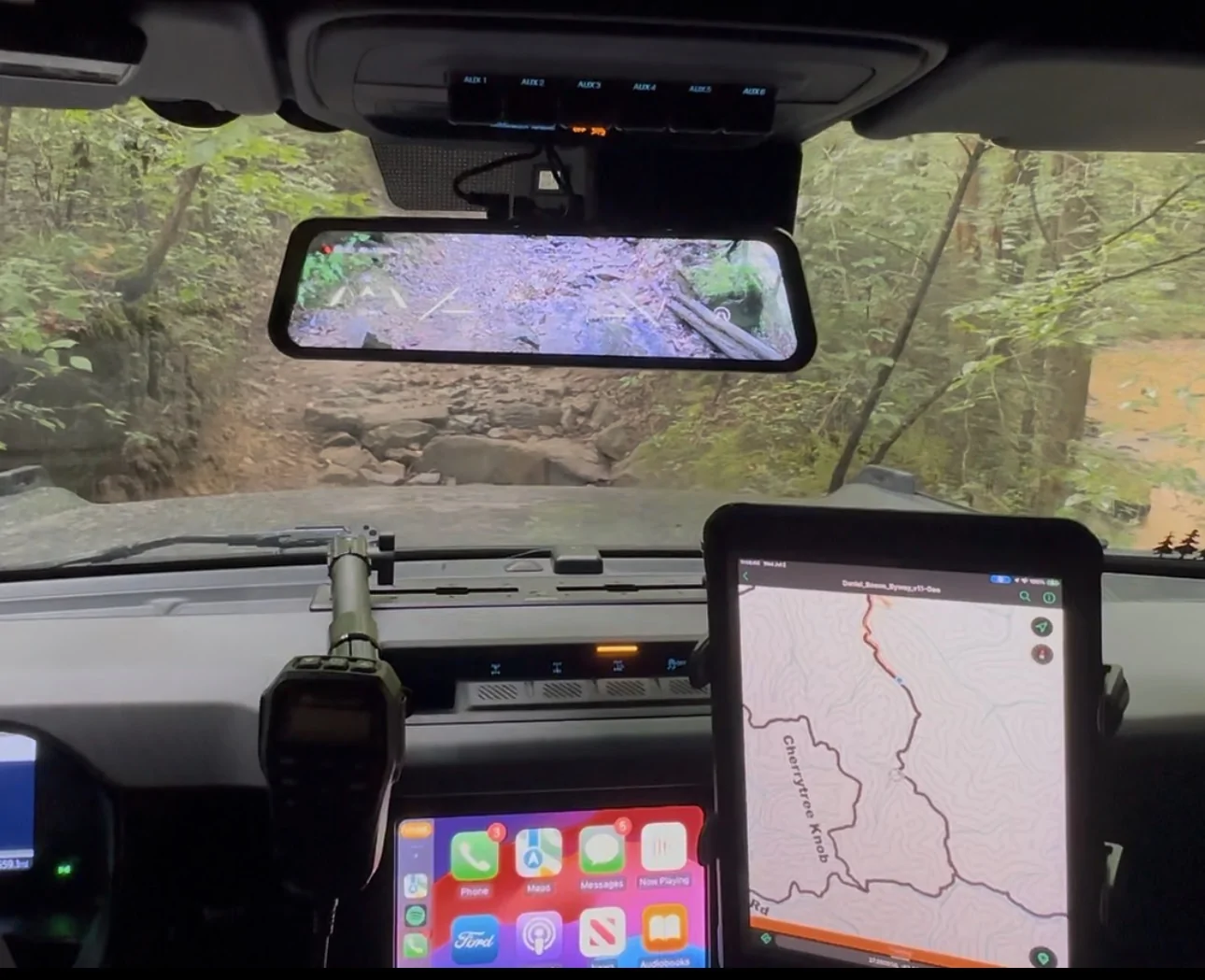

Daylight Driving
Even with the soft top open, the display is clearly visible while wearing polarized glasses. Colors are vivid, and the refresh rate is slightly better than on the Brandmotion Fullvue. A smoother image feels more natural, and helped me trust the system without feeling the need to turn it off to use the "dumb mirror" mode.

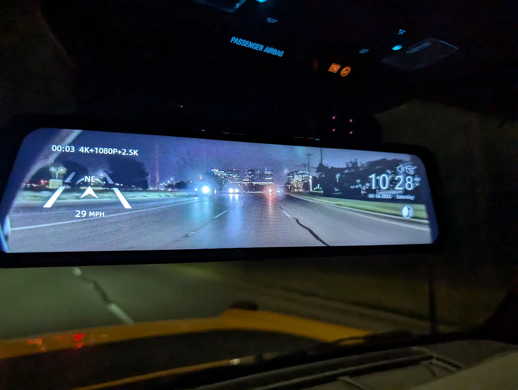

Nighttime Driving
I'm really happy with the night vision and white balance on the front and rear cameras (haven't tested the interior camera). Even with headlights directly pointed at the sensor, it's still able to make out colors. Useful, if you need to be able to describe the color of a vehicle if you ever have or witness an accident.

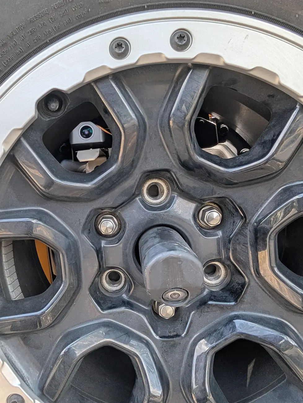

Installation (you absolutely need to use this guide, custom made by @Bee Bop )
@WolfBox , this is where I think you can save Bronco owners the most headache! The lack of first-party installation instructions for a Bronco was a challenge, and buyers should be made aware of the specific accessories they'll need to buy for the installation method they choose. Maybe offer some guidance for hard top vs soft top buyers to show them what their options are.
Considerations
Power: 12v cigarette lighter adapter (included, with bonus USB-C port) OR hardwire to fuse box. I chose to hardwire.
Rearview mirror mounting: you can use the included rubber straps to slap the Wolfbox on top of your existing mirror, which I find very ugly and ungainly. For some, it might be a practical option.
Camera mounting: as mentioned above, you can run the rear view camera through the seams of your trim panels or through the body of the vehicle by removing the trim panels. The camera itself can be affixed to a license plate bracket (not included), your tailgate glass, or the spare tire carrier (3rd party mount required, not included). Some have installed the camera directly on the rear bumper, but I have found this offsets the camera image significantly.
GPS module mounting: super easy to do with adhesive backing, though the cable is a bit long. I reused some twist ties from the packaging for this.

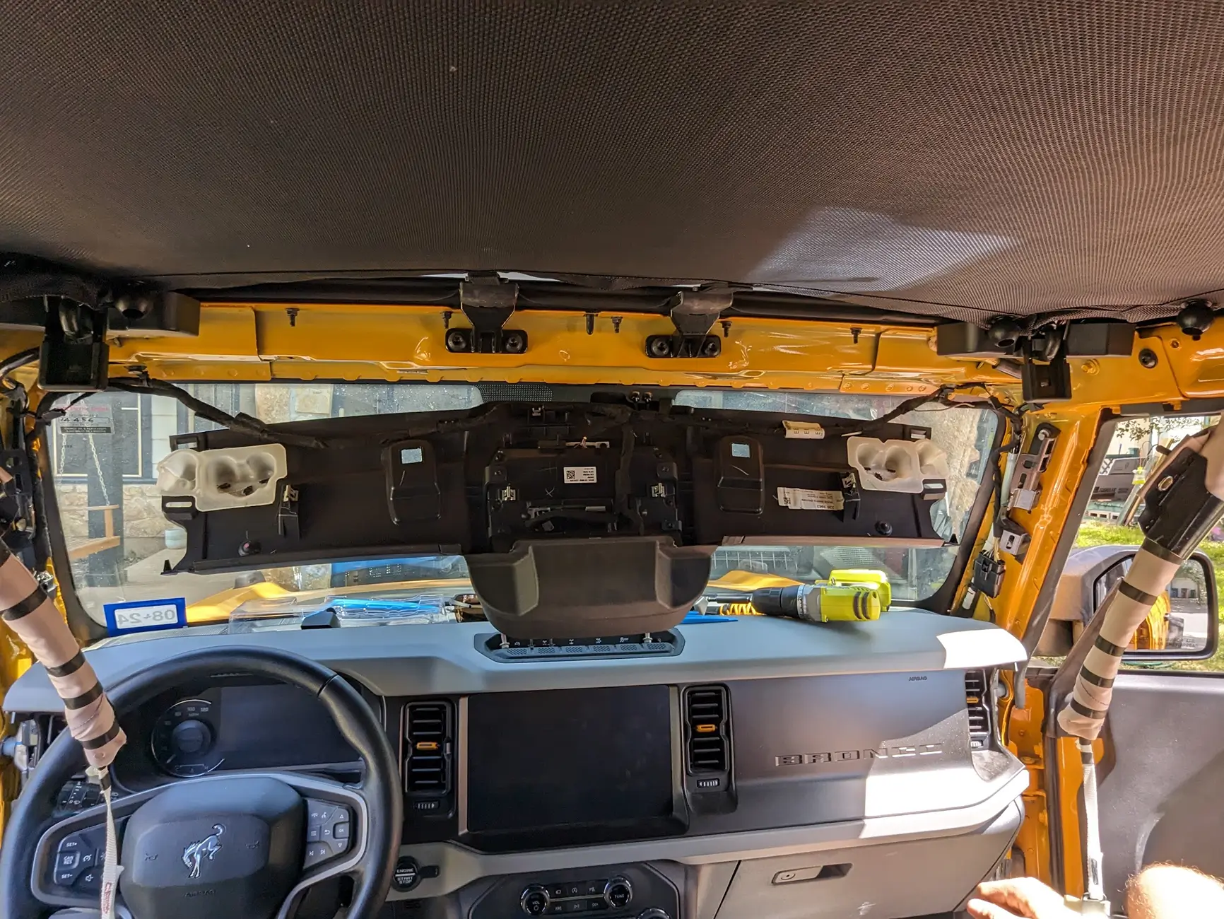

Soft Top
Wolfbox allows a lot of flexibility in the installation if you have a hard top Bronco, though soft top owners needing the rear view camera will want to run the rear camera wiring along the wiring harnesses that pass through the side of the frame, and come out near the tailgate wiring. Note that this does require you partially dismount your side curtain airbags to run the power and video cables through the overhead console (1st picture below), and that you remove your rear spare tire if you want to mount the camera externally (3rd picture below). You'll want plenty of zip ties to this, and will need to buy special torx screws for removing the sun visor bolts.
Hard Top
While hard top owners can of course run the wiring through the body of the Bronco, a far easier option is tucking the rear camera cabling along the edge of your windshielf and through the interior trim panels to the back of your Bronco, and installing the rear view camera on your tailgate glass. This allows you to perfectly center the camera, and removes the need for a more invasive wiring through your tailgate.

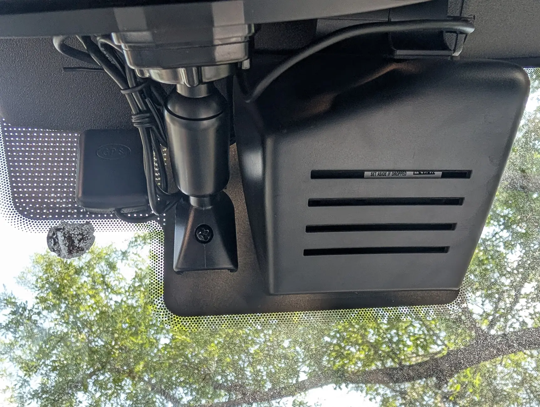

Room for Improvement:
There are no OEM directions for installation in a Bronco, though Wolfbox is heavily marketing towards Bronco drivers. They shared a couple of videos YouTubers had made on their own to demo the process, but I found that I had to rely on multiple videos for all of the details I needed for my install.
I wish Wolfbox had mentioned that to retail the use of your sun visors, you will need their OEM Bracket (sold separately) to extend the neck of the rearview mirror, or that mounting on the spare tire or rear license plate requires yet another separate purchase of their Reverse Camera Plate Bracket (sold separately). Their customer support advised me on this, but I did buy the OEM Bracket with my own money. There also was not a bracket for mounting the rear camera the spare tire, so I simply reused the one I had already installed from my Brandmotion Fullvue.
Lastly, while I appreciate the option to choose how to power the mirror and to plug/unplug the rear and extra camera, I wish it was all tidily run through a single USB-C harness for simplicity.
Ford Bronco Wolfbox G900 Tripro: Honest Review 1755451865824-8
Ford Bronco Wolfbox G900 Tripro: Honest Review 1755451885685-1i
Above, you can see the number of cables required for the GPS sensor, power, and the 2 remotely wired cameras (rear, extra). It's not impossible to tuck everything neatly behind the mirror, but it would be nice to see all of these routed through a single USB harness.
Ford Bronco Wolfbox G900 Tripro: Honest Review 1755451897500-3h
Ford Bronco Wolfbox G900 Tripro: Honest Review 1755451946347-li

I should also note that the OEM bracket for mounting the rear view mirror vibrates when on bumpy roads. Will have to see if there is a fix, but since it uses ball joints, it might be tough to eliminate this issue.

Glad to see someone else identifying the vibration problem. It’s a great product, I’m really happy with mine.

Agree with what is stated above. I believe the vibration is due to the very flimsy bracket. I put 2 pieces of thick cork gasket material under the bracket and it eliminated 80% of the vibration but they stilll need to provide a more sturdy bracket to eliminate the vibration. My other issue is the mirror is too bright and distracting, if you turn it down, then then you get the image of the underlying mirror thru the lighted image, not ideal. I do not like the mirror image and solved this by putting a clamp on mirror over the Wolfbox mirror to retain the dashcam features. They have so improving to do.
For a moment I imagined you clamping the Wolfbox onto your OEM mirror, and then another mirror atop your Wolfbox.
Greaf suggestion about adding a shim between the bracket and the Wolfbox mirror - I'll have to try that with some rubber pieces I have laying around.
