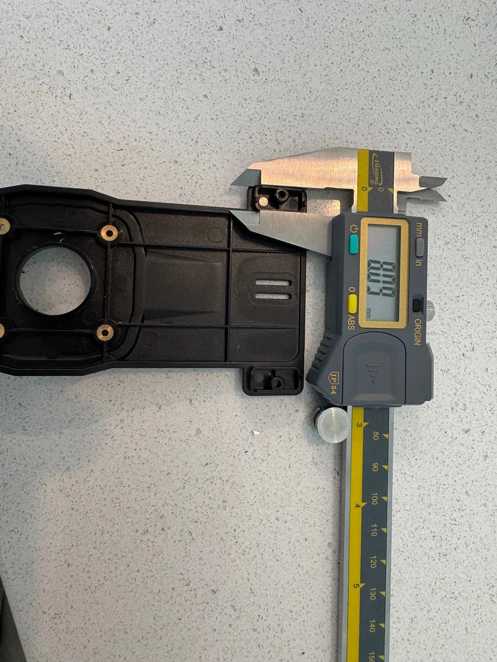

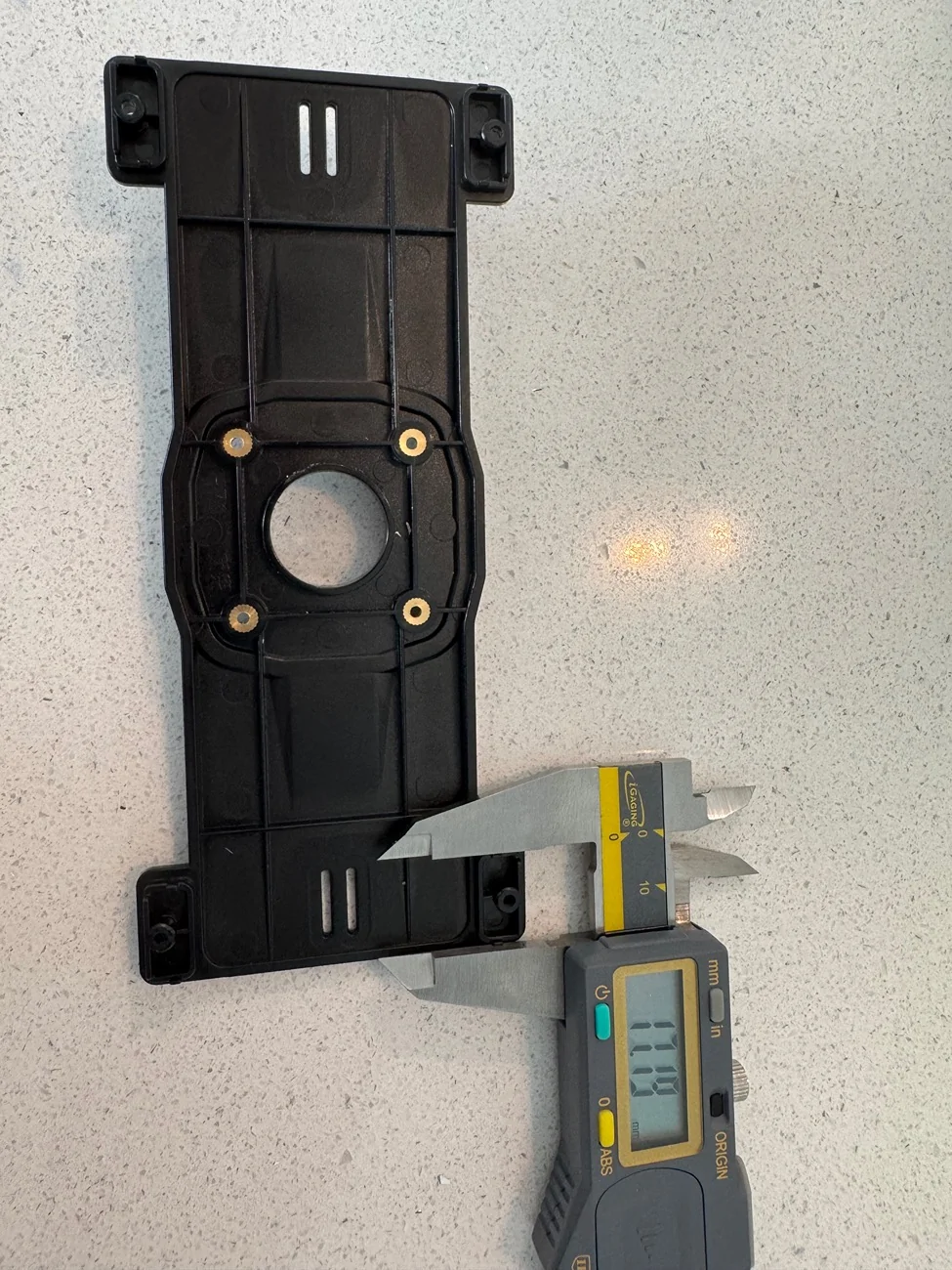

honestly, something like this would be better to make the spacers out of. I was just in a hurry to get this done yesterday. Note the dimensions (in mm) in the photos below. I went with a thickness of 1/4" .

Well the short answer is yes, you can go without spacers but I do not think it is a good idea. The reason why is in the bottom of that hole where the spacers go, there is a brass insert in the plastic. If you start cranking down that plate without an insert, I worry with a tight enough screw you may pull out the brass Insert. So in my mind, the spacer supports the brass insert so no matter how tight you get that screw it’s being supported and will not pull out of the plastic. I considered doing the same thing by not using a spacer, but then decided against it.
