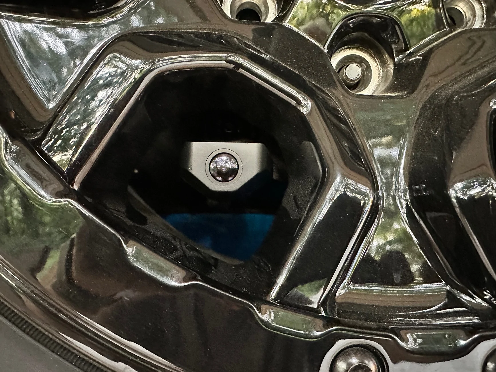

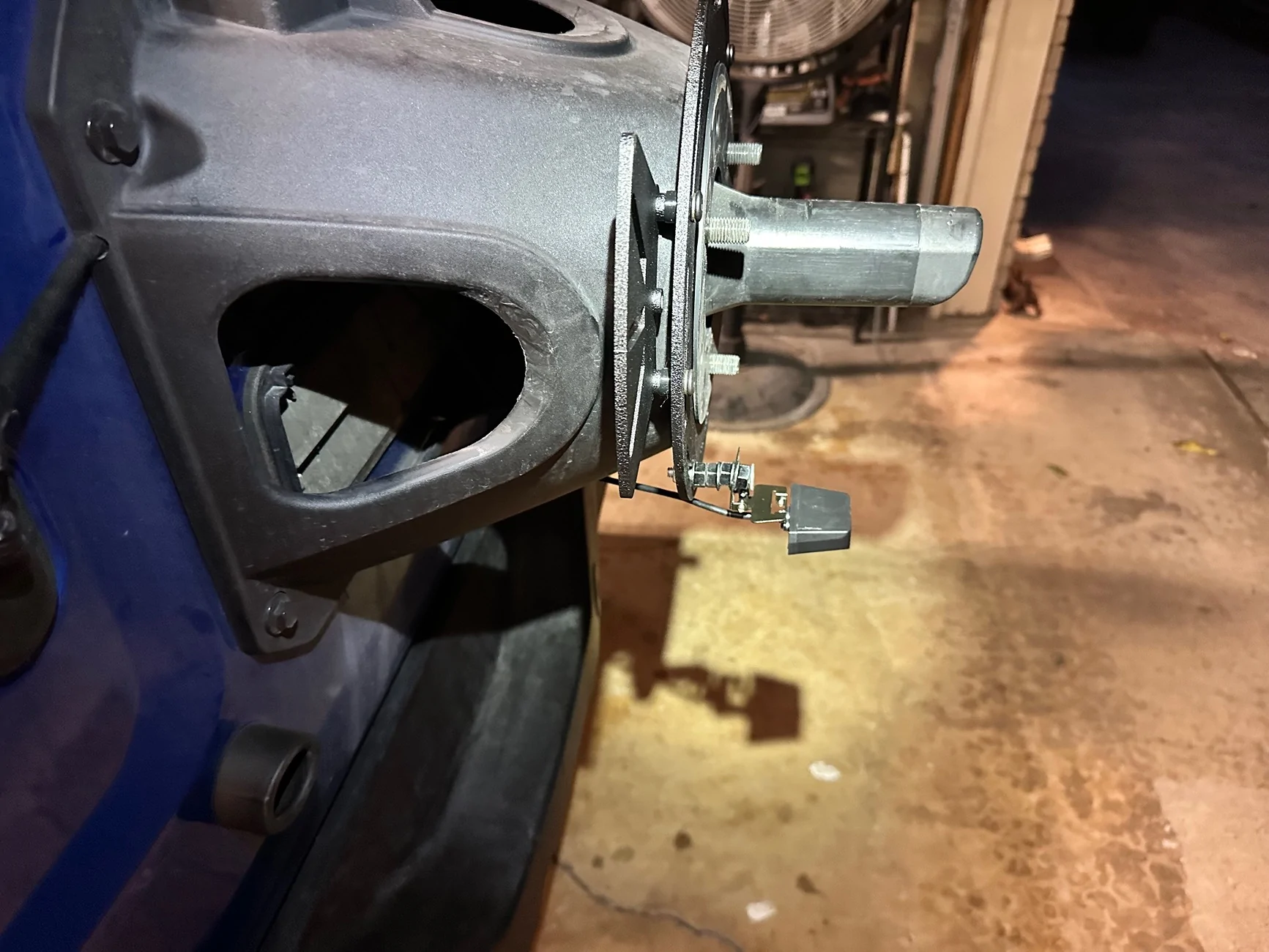

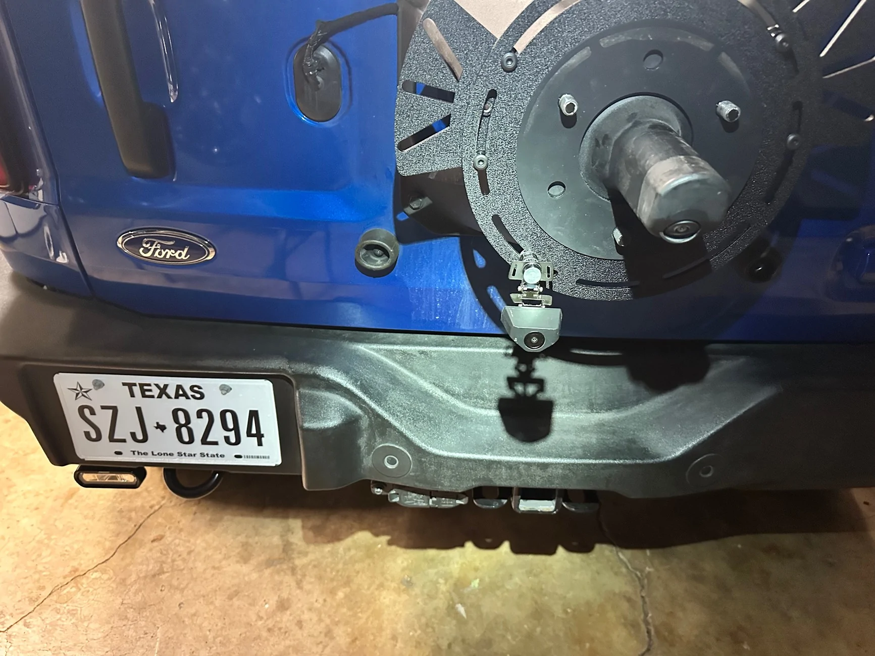

Tonight, I moved my camera from the rollbar to the rear tire. I put my top on and the view was too restricted. I hate that the camera is in the weather now. It would be nice if there was a hood to shield it from the rain. I'm pondering how to fabricate something. I got kind of creative getting it inside the spare tire. I used the AGS off-road mount for a base, I'll eventually add some lights to it as well.

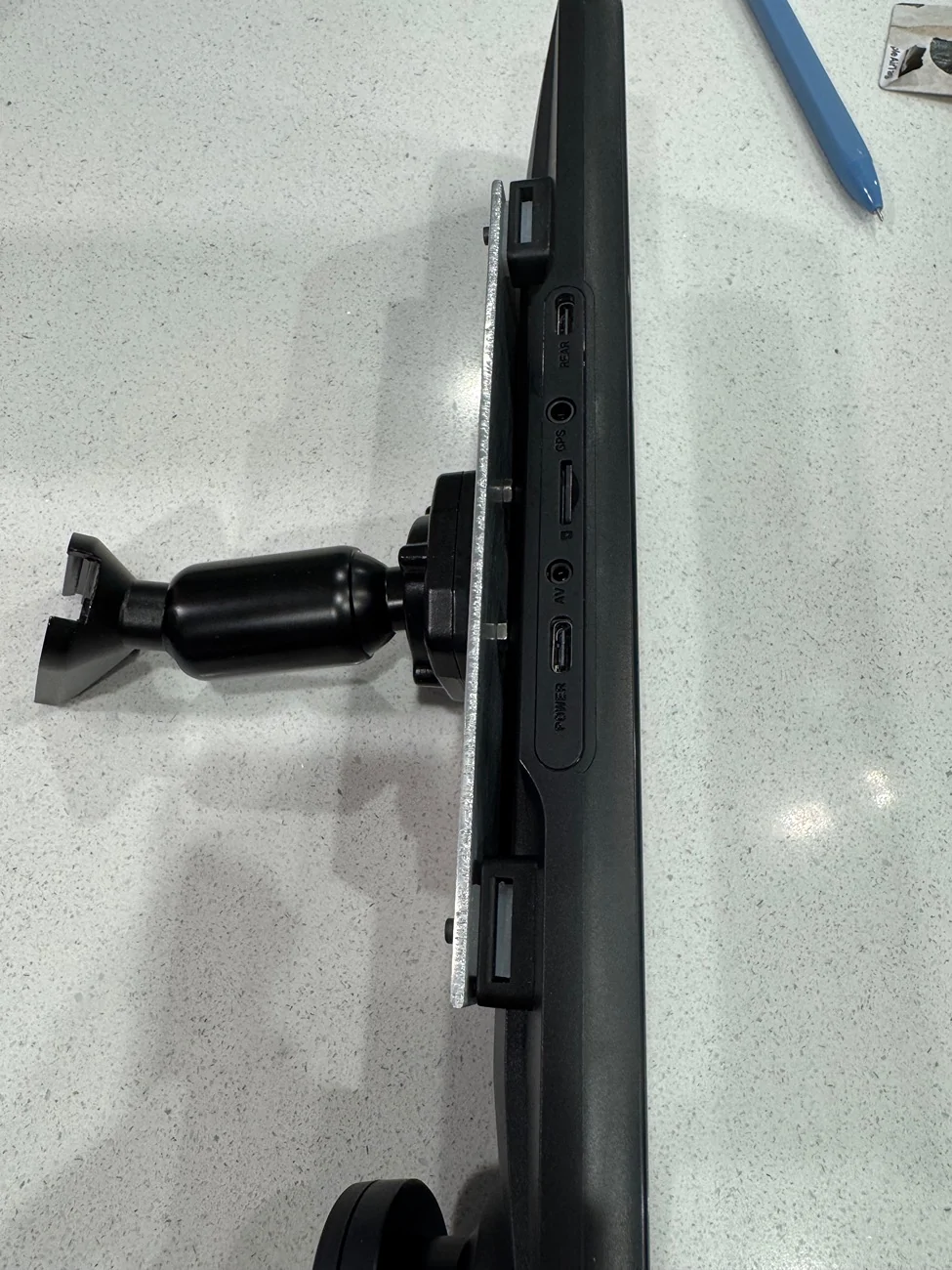

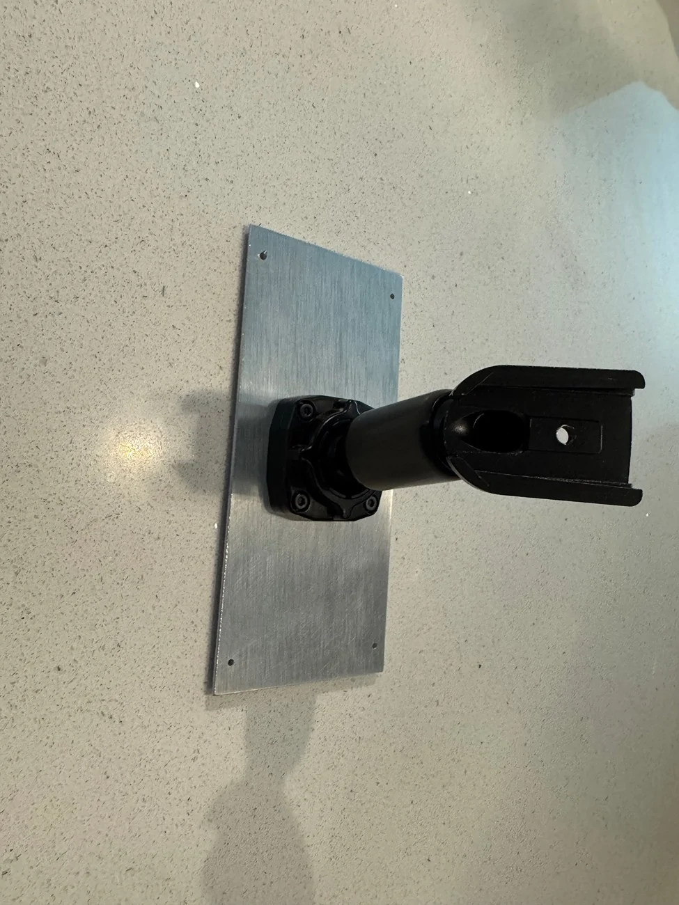

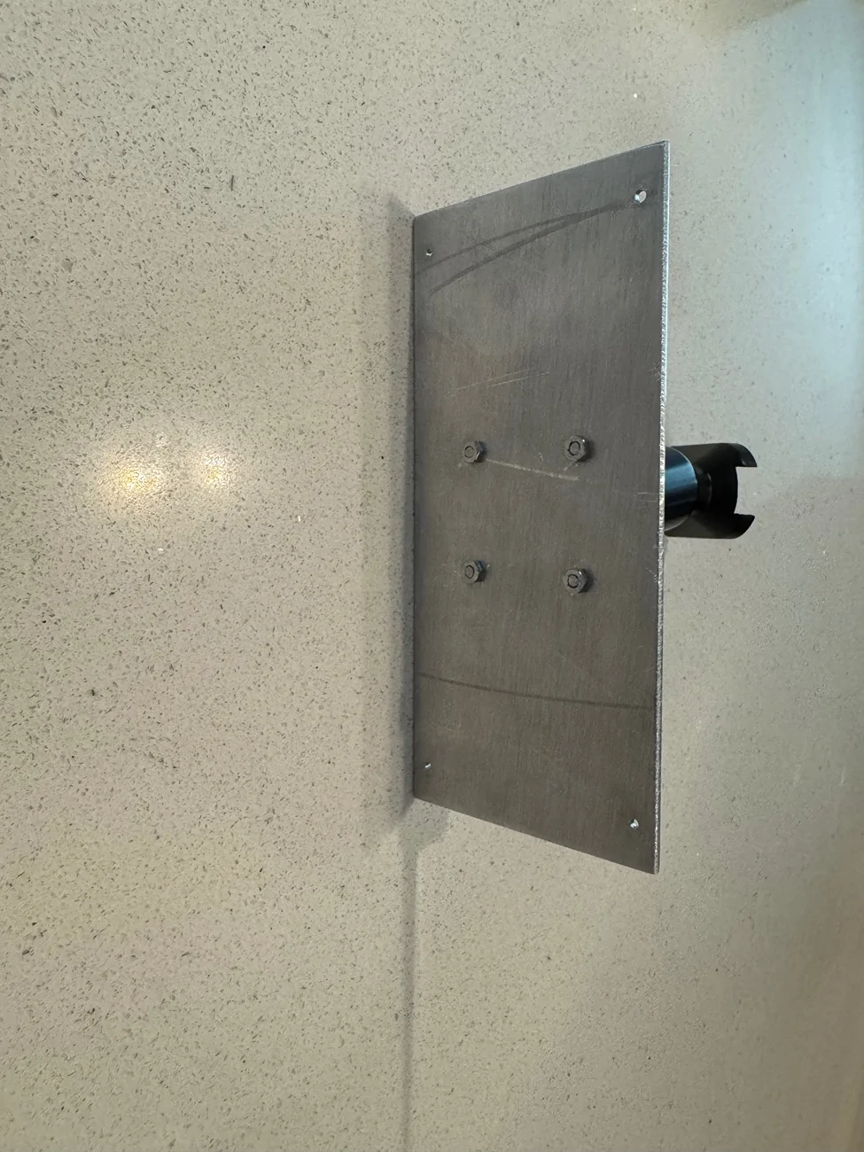

Solved the screen vibration issue. see below photos. I used a sheet of aluminum plate that is .09 inch thick (2.29 mm). I used spacers that are .25 inch thick to seperate the display from the aluminum plate. The cap screws that hold the plate to the display are M2-.4mm by 12mm long. The cap screws I purchased to hold the center post to the plate are M3x.5mm x16. (I did cut these off to make it flush with the nut on the back side) I considered using a tap to thread this but decided not to due to the thickness of the plate I used. The spacers were the toughest part of this. I did not have access to .25 inch spacers that were rectangle and fit down in the place on the back side of the display. I made them out of 1/8 inch thick plastic washers purchased from Ace. I must have spent close to 2 hours filing them down to fit the space needed. I also changed the machine screw that fastens the arm to the windshield to a cap screw. I believe this allows a greater degree of torque to minimize the chance of any vibration coming from that connection. All of the cap screws I found at my local Ace Hardware. The aluminum I sourced from a buddy. I would have purchased a piece of 1/8 inch thick plate but when I saw this piece, I thought it would be good enough and I do believe it is.
Edit: well I guess I don't know how to post photos. I was trying to do this from my Macbook that has the photos in the photos app.
