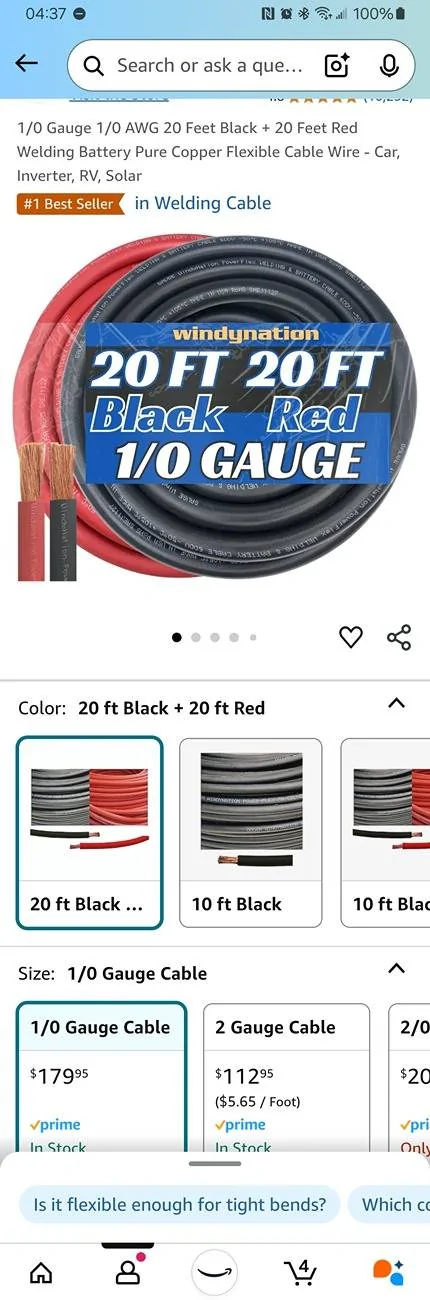

I've been running these cables with my rear winch for about a year and a half with no problems. No they aren't cheap, but after receiving a couple other sets and not liking them I decided to quit being cheap and be safe. Then again they were only about $150 back then. Also ordered copper lugs and the correct tool. I have a lot of time and effort involved in the rear winch. Don't want to have to pull it apart anytime soon. Same reason I ended up running the Warn M8000-S winch. The Badlands winches I tried didn't fit well, so ordered the one this kit was made for.
https://a.co/d/6FARTo3

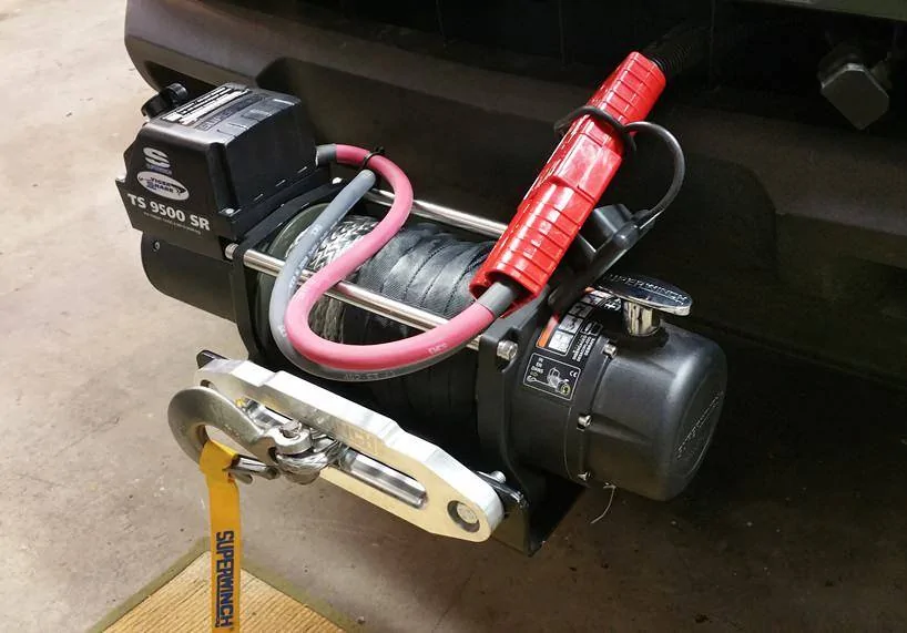

Been running ECWS 1/0 for my LWN's Tigershark 9500SR winch for years: 100% multibundled copper, with Anderson 350A QDs. Even replaced the undersized winch wiring with it. Also buy a hydraulic crimp tool for the terminals if you go this route.
https://www.amazon.com/dp/B016HFD86Y

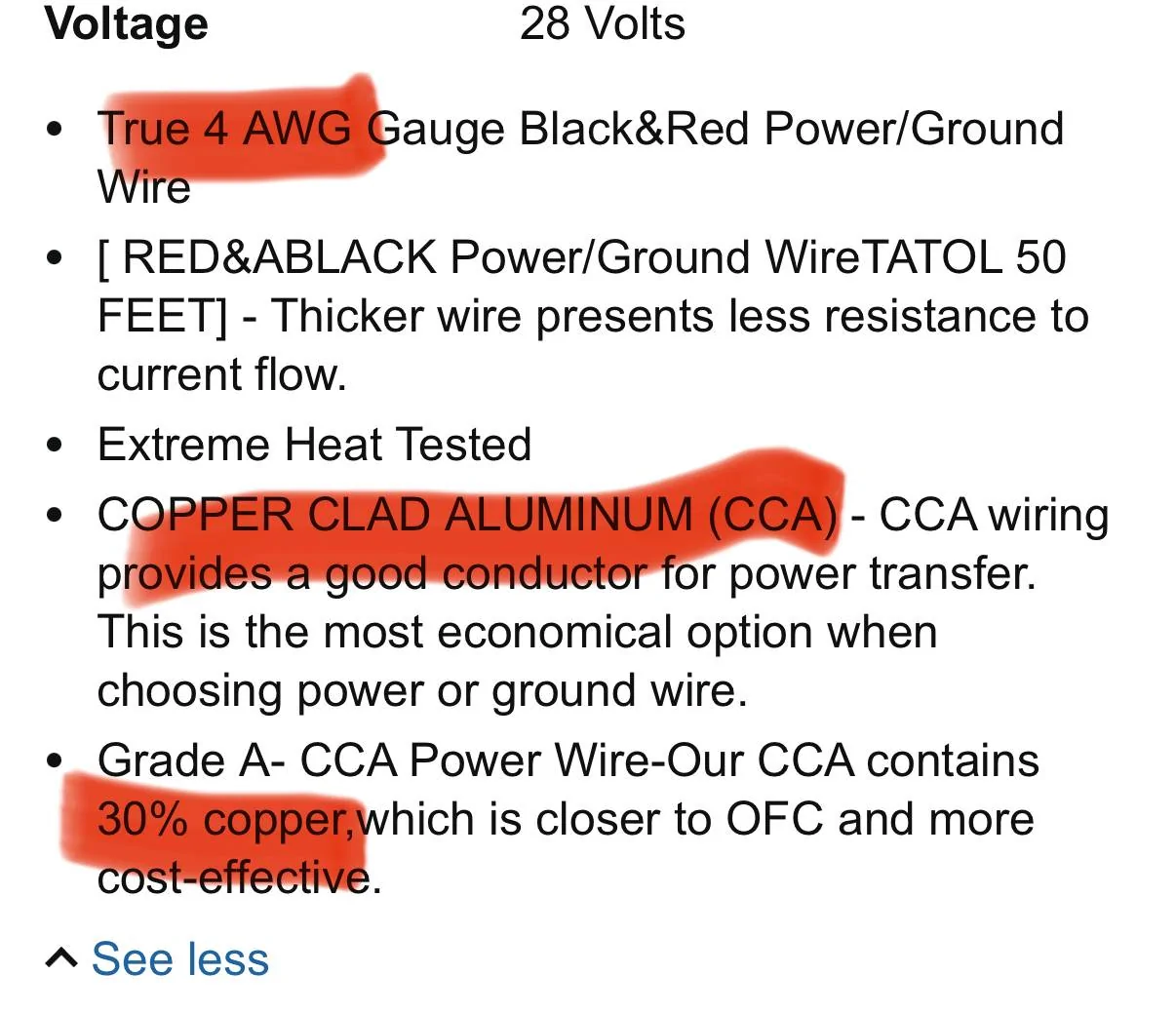

That wire you have listed for Amazon is absolute shit, and these cunts are trying to make it look like their cheap bullshit shortcuts are a good thing. Fucking hell what a bunch of crap. I hate everyone.
4 gauge is too small for a winch. Especially a rear winch. Yes you could use it intermittently and give it breaks, but are you going to be thinking rationally in a situation that could potentially be dangerous? Most people do not. I would suggest 1/0 wire (4/0 would be awesome but like already mentioned that’s some chonky shit and you probably couldn’t even get it to fit the battery. Don’t confuse 4G with 4/0. Two VERY different sizes 1/0=0. 4/0=0000)
DO NOT USE CCA! Copper clad aluminum is absolutely terrible and your voltage loss will be huge at that distance, exacerbating the load on the winch and it will likely overheat sooner. I get it-why spend $120 on a wire when you could get the “same” wire for $30, but pure copper is definitely worth the money. And while we’re talking about wiring I would suggest running the winch ground back to the battery rather than grounding to the frame. It’s a controversial topic among those that actually know about electricity, but after seeing that all the grounding for the entire vehicle is ran through a single harness that is essentially two 4G wires at the battery. Is it worth $100 to know you will possibly reduce the risk of frying a computer?
That is a long run to the back, and if you hook it up like is conventionally set up, you now have an unprotected circuit with a large wire. Definitely get a 500A relay so your rig doesn’t start on fire in the event of an accident or wildlife making a tasty treat out of your insulation.

okay so my understanding is get a relay and get a fire extinguisher. also run ground to battery. also get element and animal resistant sleeve.
i also found this pure copper wire i can get, does this look good?
if not please link what you suggest!
But how do you ~really~ feel?

That looks like good stuff. Also worth getting a proper crimper for large wiring. Hexagonal crimping tools are awesome and not expensive.
Just a heads up-you’ll likely need to trim a little plastic from the dividers on the positive terminal block to hook up the terminal. 90 degree connections are super helpful too so you can close the cover without needing to notch a bunch out.

That kit looks good to me. You would still want cable sleeving for the run back unless you go through the cab
Also, a relay is nice - you can also use either a physical disconnect or manual switch as well. Either of those require you to pop the hood and turn it on vice just flipping a aux switch though, but effectively do the same thing and can have other advantages as well.
I don’t use cheap amazon cables but I absolutely use the ever lovin’ crap out of my cheap Amazon hydraulic crimper set
