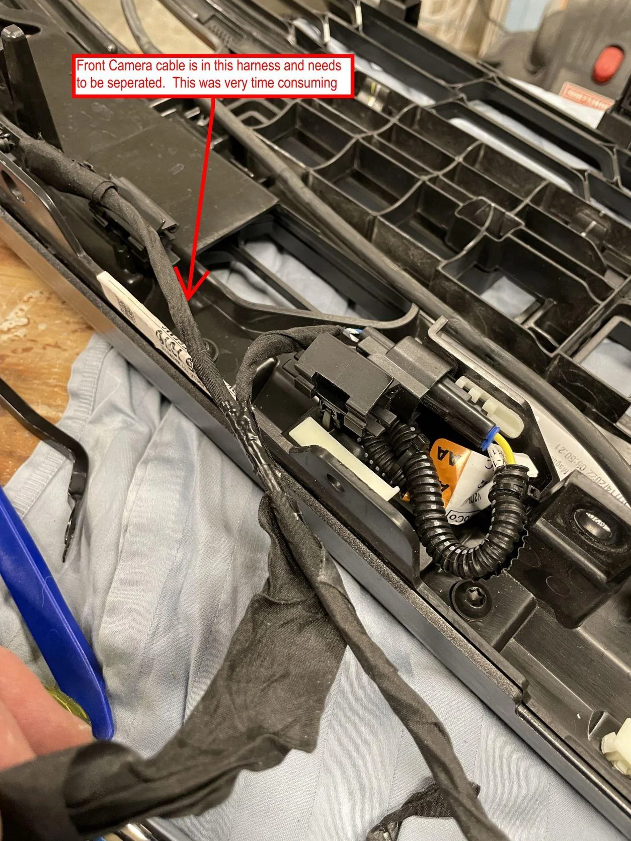

The front sensors were probably the hardest part. Extending them would be easier in my opinion.
The front camera cable is buried in the harness for the grill lights.
Ford Bronco Winch solutions for your Raptor Harness

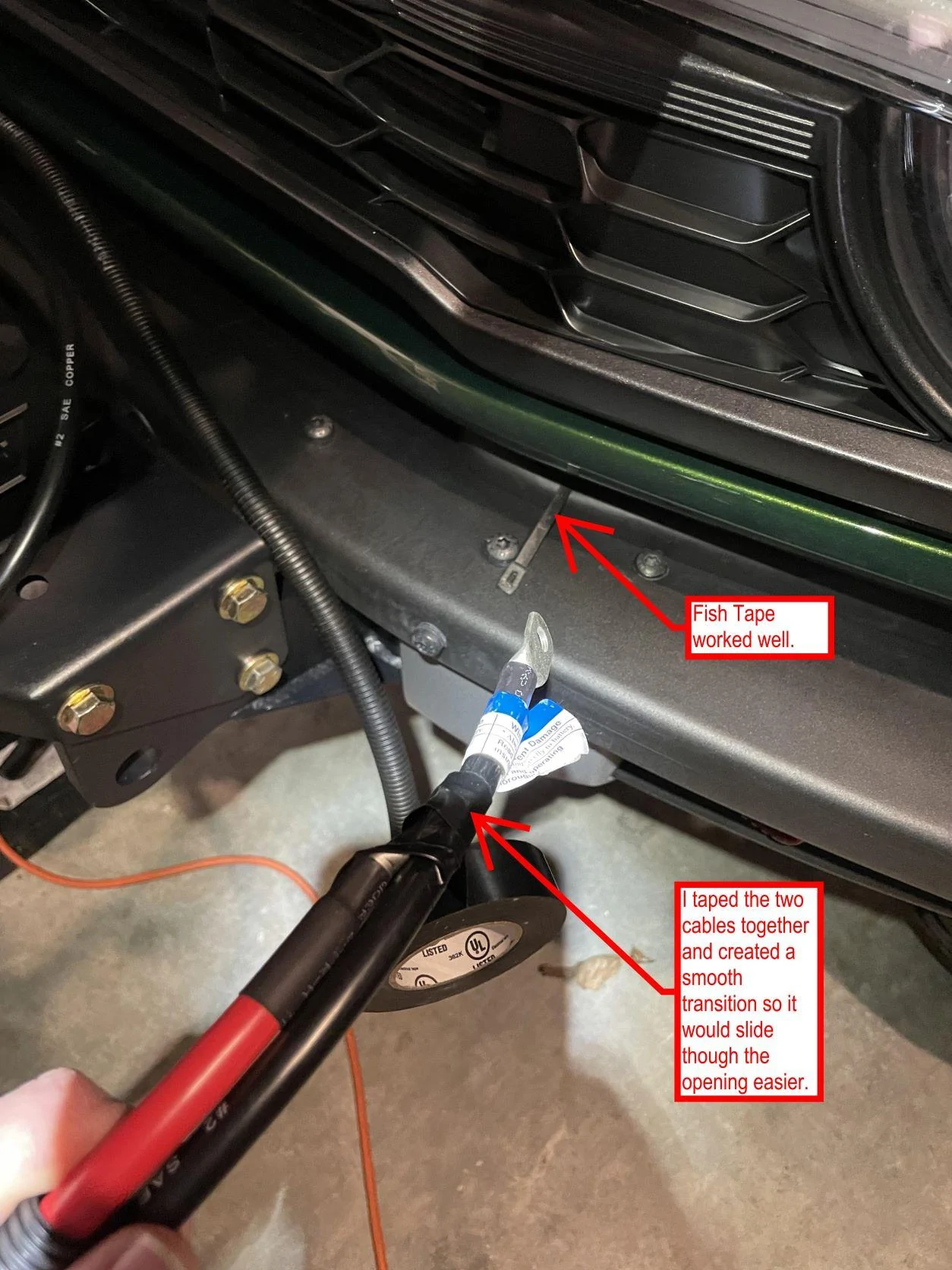

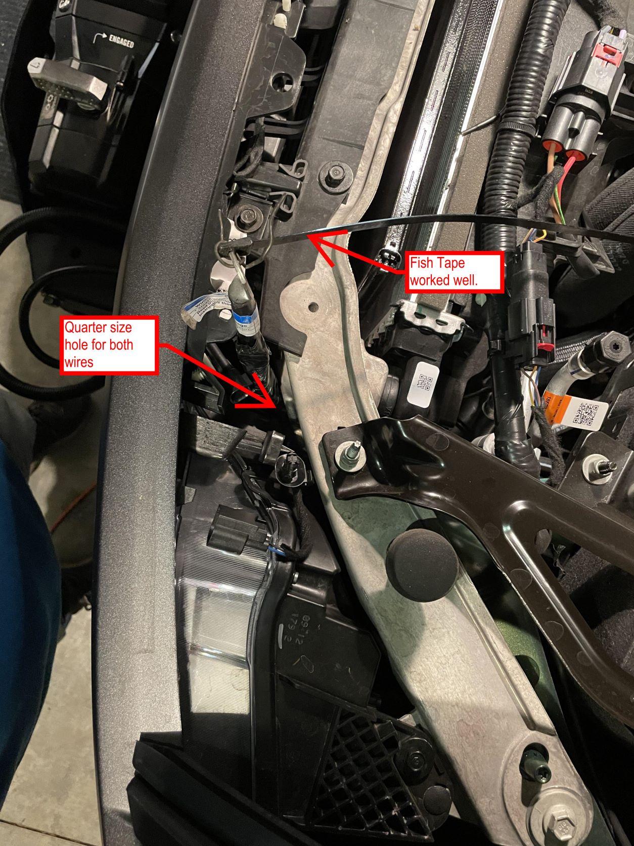

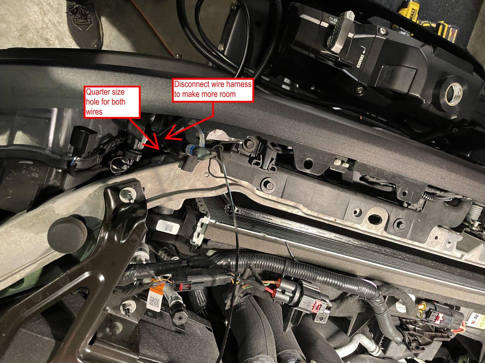

Cable path
Ford Bronco Winch solutions for your Raptor wire-path-to
Another angle
Ford Bronco Winch solutions for your Raptor wire-path-top2

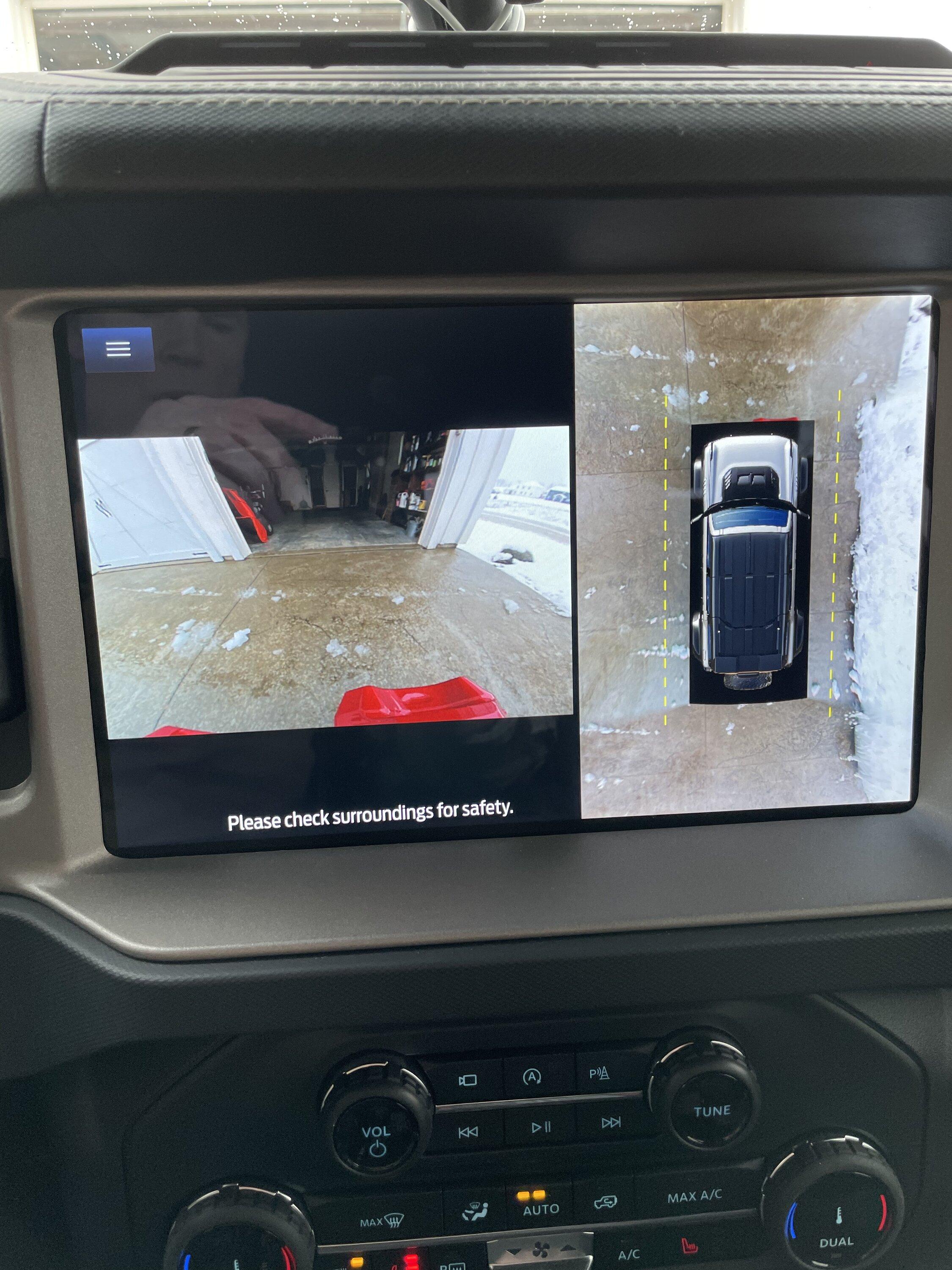

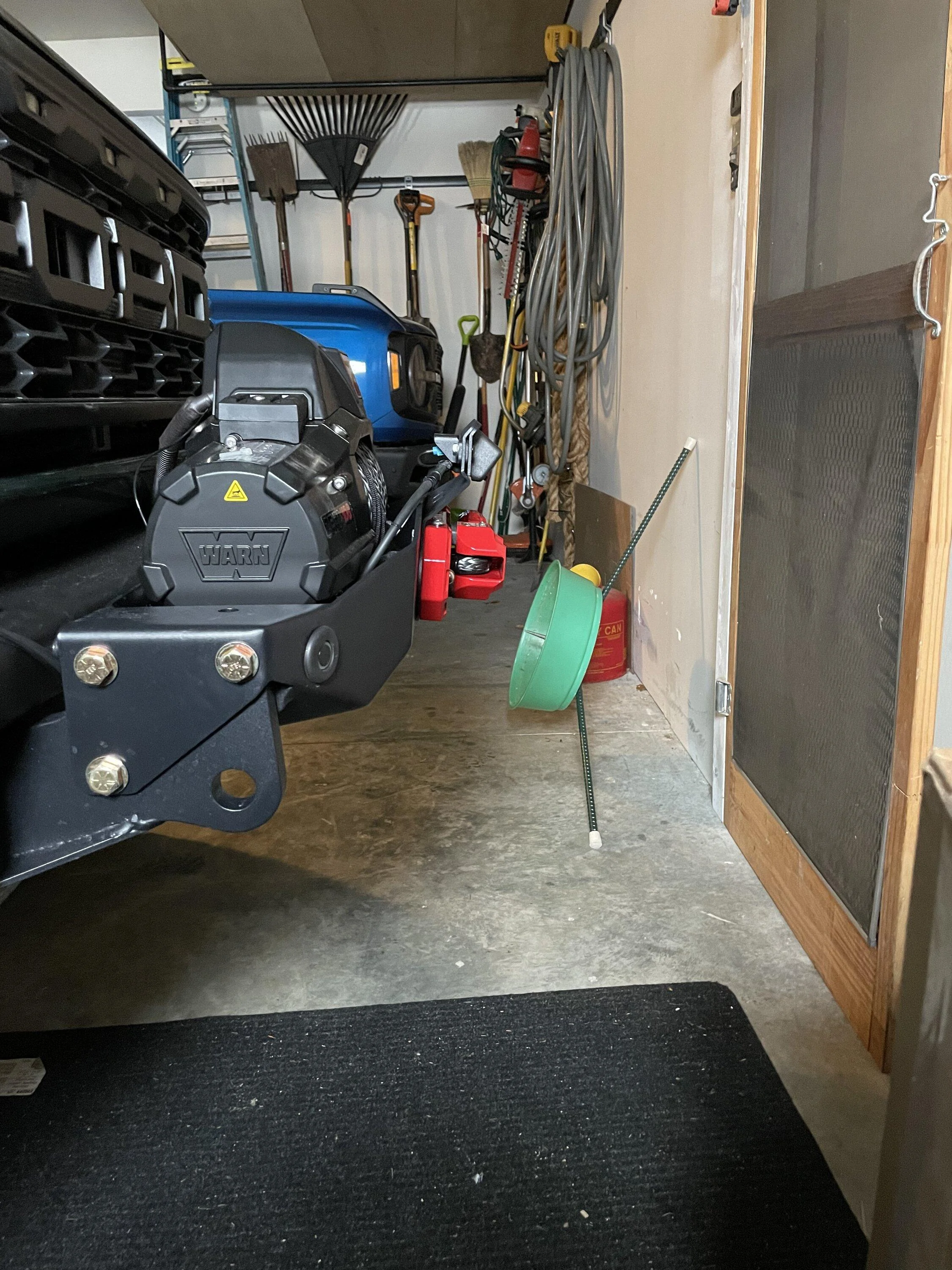

That looks really nice. Does the front camera stick out beyond the fairlead? It is hard to tell from this front picture.
Yes. See below.
Ford Bronco Winch solutions for your Raptor F5556D9F-3C68-400A-B3D7-B5BCC5856C95
Feb 14, 2022
48854
Ram 2500. 2014 Mustang
Camera video looks perfect. I assume the red is part of the winch.
