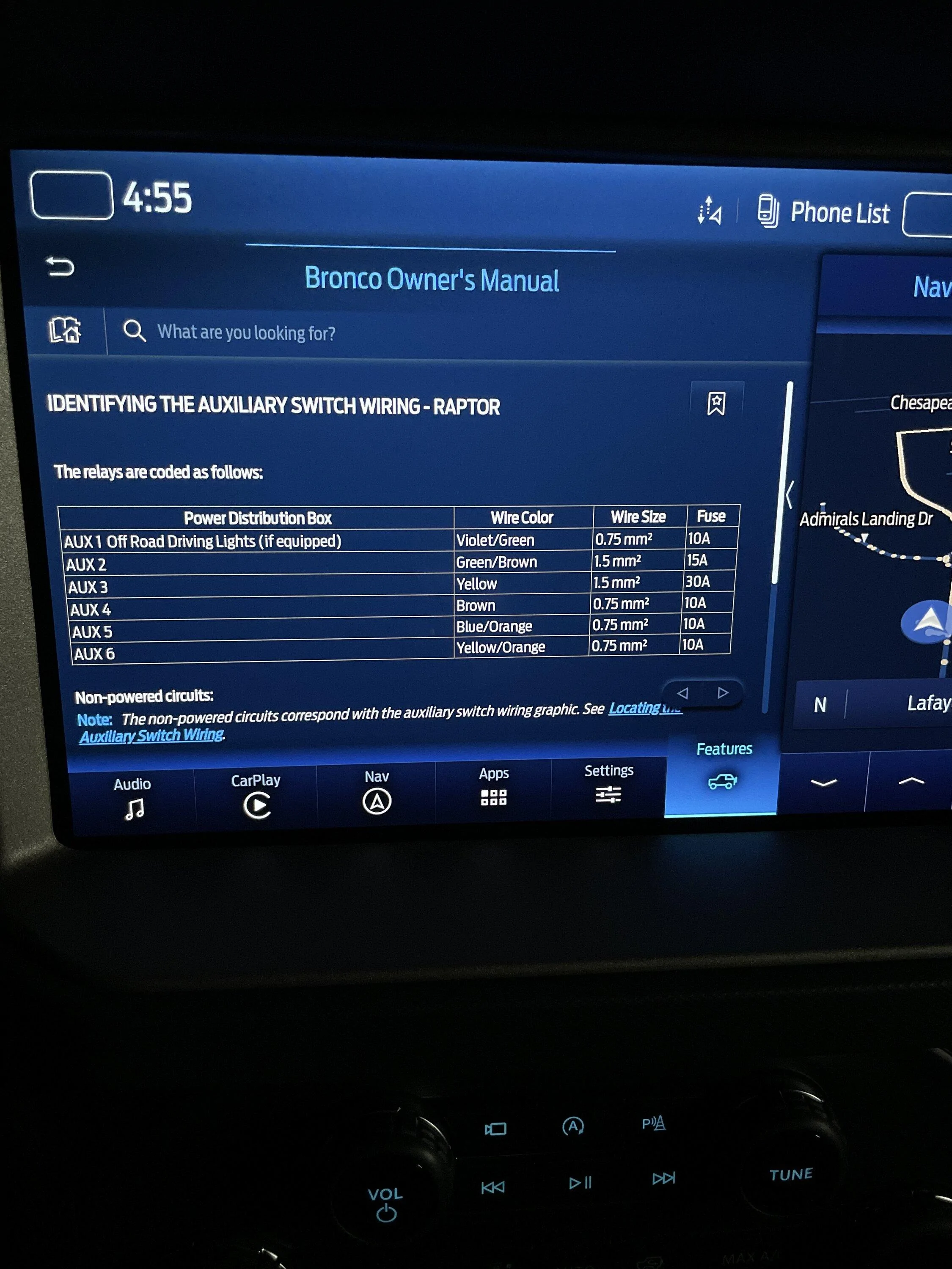

Just a quick FYI. The BRaptor Aux switches are not the same as the Bronco. Aux 3 is the 30 amp on the BRaptor.
Good catch - thanks for pointing that out

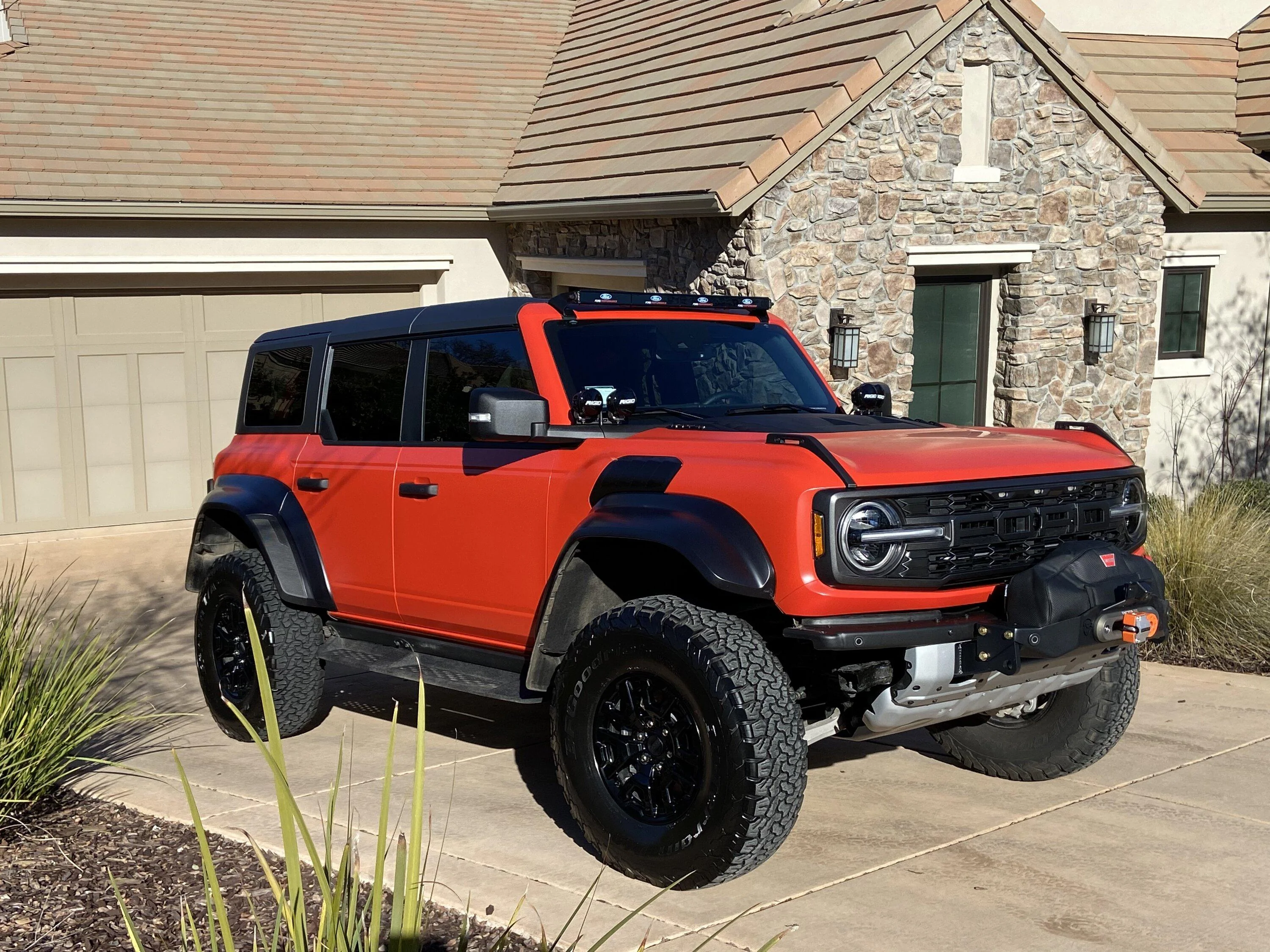

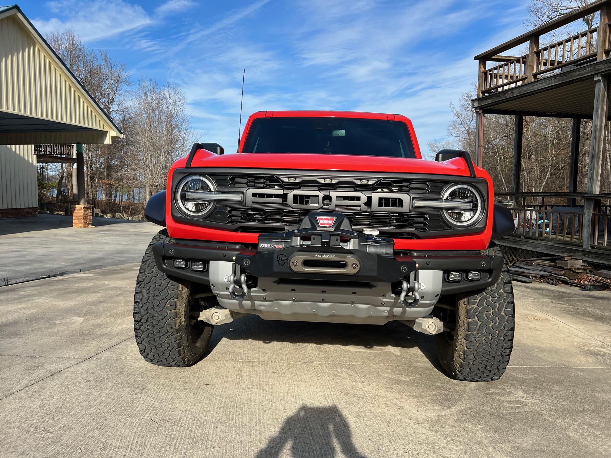

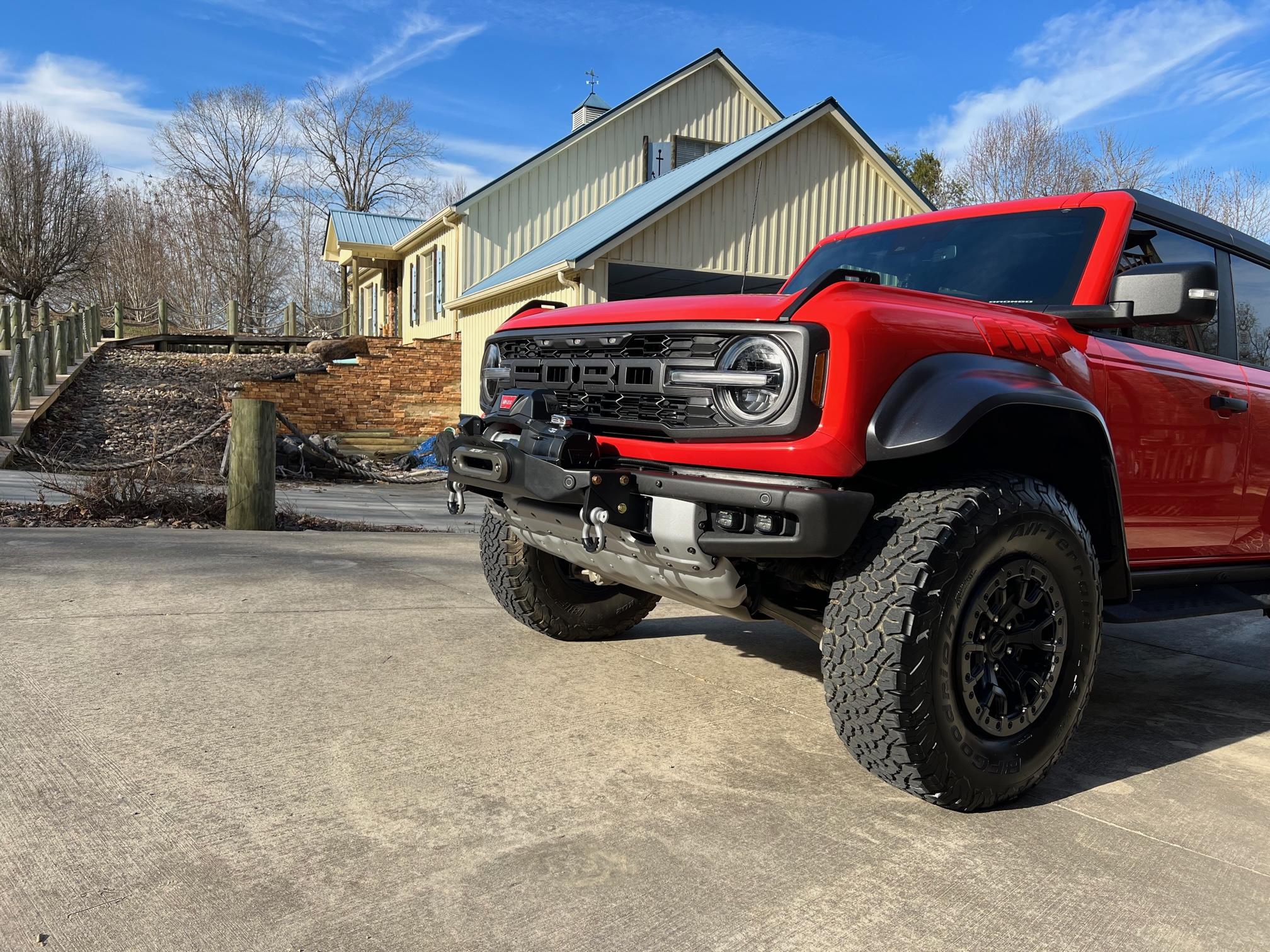

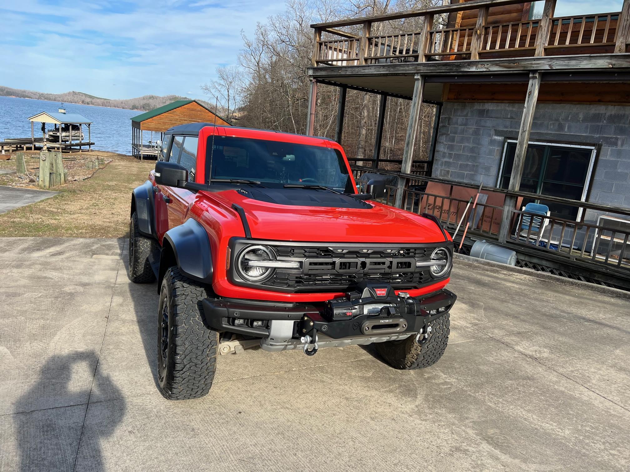

Just installed my JCR winch plate, Warn Zeon 12-S, JCR Camera Relo Kit, Factor 55 Fairlead, Flat Link and Rope Guard yesterday.
Raptor sensor wiring is different than standard Bronco (I did same install on FE two months ago). Just cut out the short one, skip stripping harness on that side and splice in 12” -16’ of wire, save yourself the heartache of coming up short.
Running battery cables up next to the headlight was easy. I used I wire coat hanger taped smooth, the slid right through, but it s tight. I did pull the clip holding the grill running lights harness to get it out of the way to make room for sliding the cables through.
I pulled the painted valance this time it makes it easier to get to the plug for the bumper wiring harness. Unhooking that plug was a pain on the FE It pulls off easily, makes routing the camera wire,sprayer hose and other cables easier too.
Don’t forget to put your silver plastic center cover before mounting the plate, winch etc. you can unbolt the plate and slip it in later with some help. Don’t ask me how I know.
Lmk if you have any questions, glad to help. Best of luck!

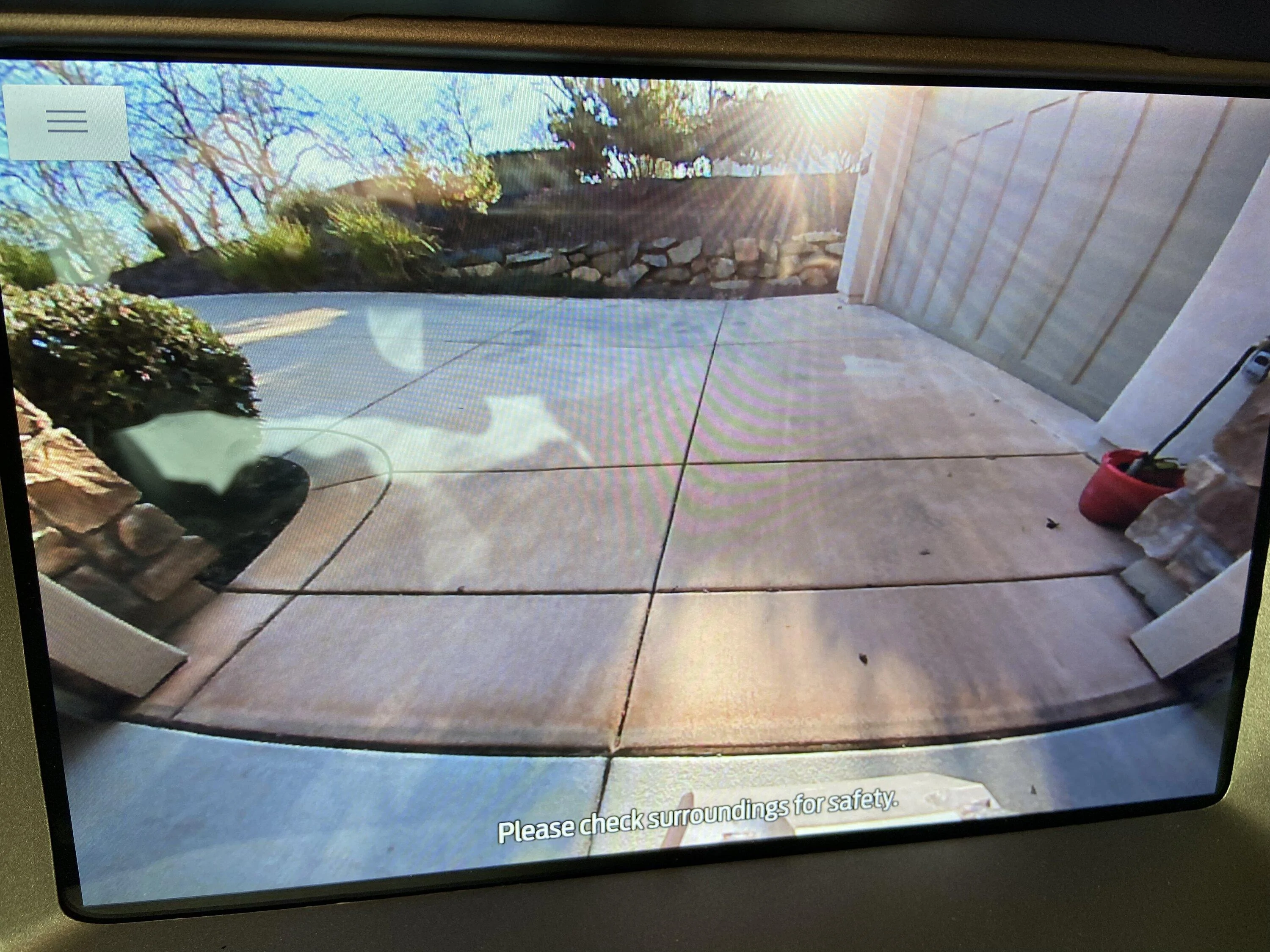

Looks great! So, you actually cut the wiring harness and added wire to get it longer? I just watched their video showing removing and cutting the tape. Are you adding/splicing wire on the two sensors that fit into the new winch plate? Does the ACC work OK with this setup?
The only thing I don't like is how far forward the camera is. I hope someone comes up with a mount that goes behind and above the center of the winch. About how long did it take start to finish? Thanks for the post.

Yes I added wire.After I started stripping back the harness on my Raptor I discovered there was no way one side would be long enough due to the way ford wired the raptor. It wasn’t this way on my friends FE, we followed JCR video instructions but that still ended up being a very very tight fit for sensor to reach its me location. So I cut the three wires about three inches from the sensor and spliced in about a foot of wire (I used 20 gauge) on each sensors wire with soldered heat shrink connectors, re armored and retapped. Note: the JCR video is on a standard bronco, not a Raptor. The Raptor is such a different vehicle, so many small differences you wouldn’t notice till digging in.
I don’t have an ACC on the Raptor. But I can’t see how splicing wire into the parking sensor would affect that. My friends FE we did works perfectly for ACC and JCR has assured ACC will work on all installations, but Raptor could introduce some new issue, who knows?
Watch the ASFIR video for how they relocate the camera. It’s set well back and high, but I’m not cutting my grill at this point. I’m also not sure how clear the camera view is in that position, it looks like it would still catch a fair amount of winch, but I can’t be sure. The JCR mount only sees a small bit of my tope guard on my flat link. But if that far forward position becomes an issue I’d consider the ASFIR solution. EDIT: I just was looking at my grill, the Raptor running lights look like they’ll conflict with ASFIR solution.
I’m a so so mechanic so is my buddy, it took us all day working together to install everything first time, but we were learning as we went. I did it a bit quicker this time and also installed/wound the synthetic rope. Getting the rope threaded and puck seated properly has been a time consuming pain in the …. Both times.

Looks great. Sounds like you had the same struggles I did. I thought I was all done until i turned around and saw the silver cover sitting there with all the clips.
I thought the winch cover was also a pain to install. Planning to leave that on as long as the winch is there. Nice work and thanks for adding content to the installation process.

Haha! Sounds like I was there! Trim piece was fortunately easy to get in retroactively with a second pair of hands.
I had same issue with my Warn winch cover. There is very little clearance between the ends of the winch and the side of the winch plate. The elastic strap slip in easily, but I had to push the draw strings through with a panel tool. I’m retrospect I may have put the cover on before tightening down the winch. And I’m definitely leaving on the cover permanently. The access panels on Warn winch cover are easy to use.

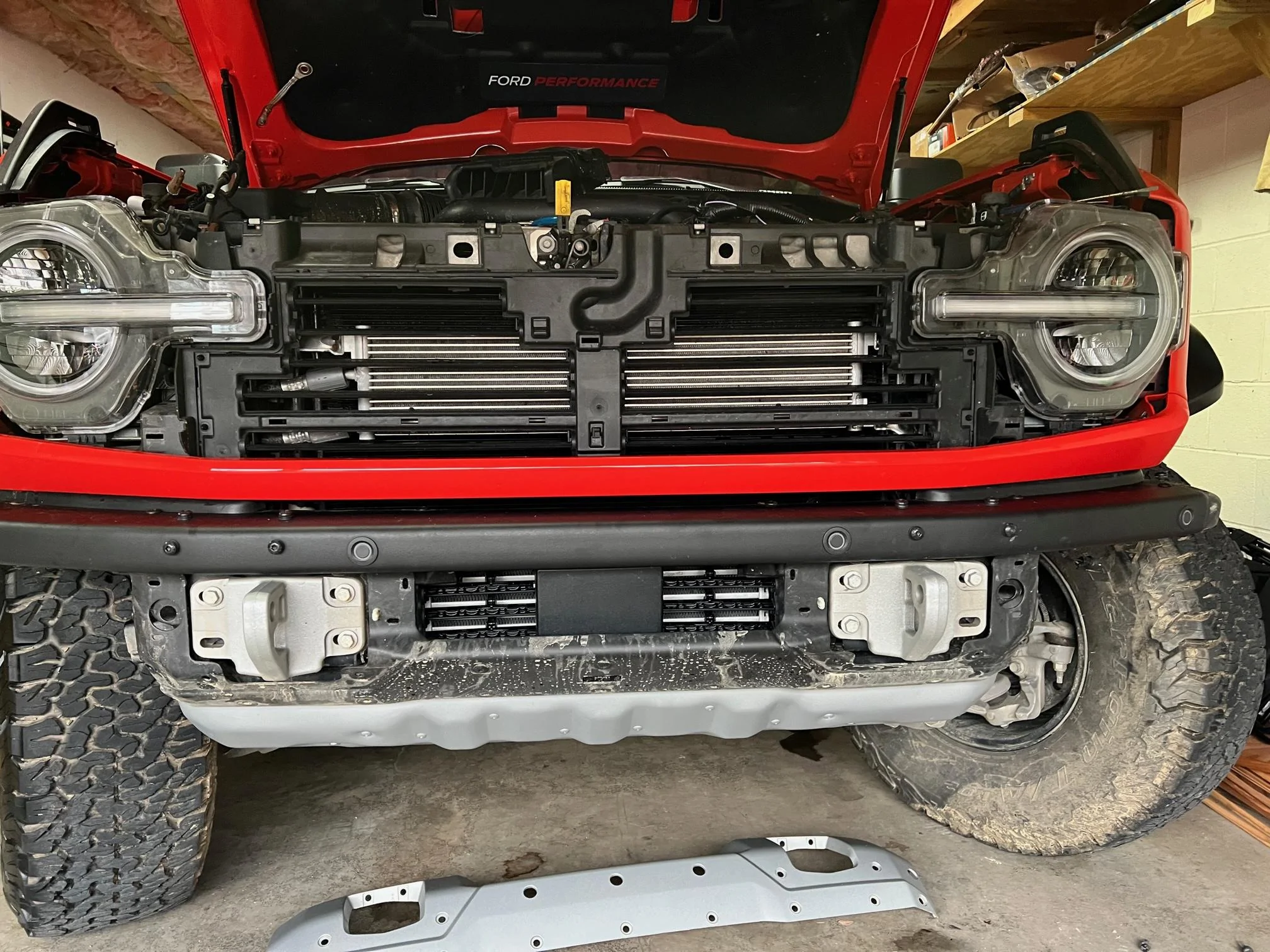

The painted balance is the skinny plastic panel running just above the bumper. It pulls (pull parallel with the bumper from the side of vehicle) off on the outsides with firm steady pressure, then work from each side toward middle popping out 4 or 5 clips straight out from bumper. The Braptor has some rubber seals mounted to the top of the bumper that other broncos don’t. Removing the valence will make it easier to thread your power cables up past head light, but not absolutely necessary
I have been trying to get it off. The corners are on very tight and I am afraid if I pull to hard it will break. So I just pull the sides towards the Front?
Ford Bronco Winch solutions for your Raptor IMG_2668
Got the camera all removed from the grill, and the grill harness put back together.
After lunch I'll pull the bump with my wife's help. Then start the work on that harness.

Sorry I’m on a ski lift. Pull out 90 degrees from the side. You just have to get the edge out to the side then then you can start pulling forward.
andcyeah it’s scary! Just firm consistent pressure. I should have taken a pic of how it clips over the edge.

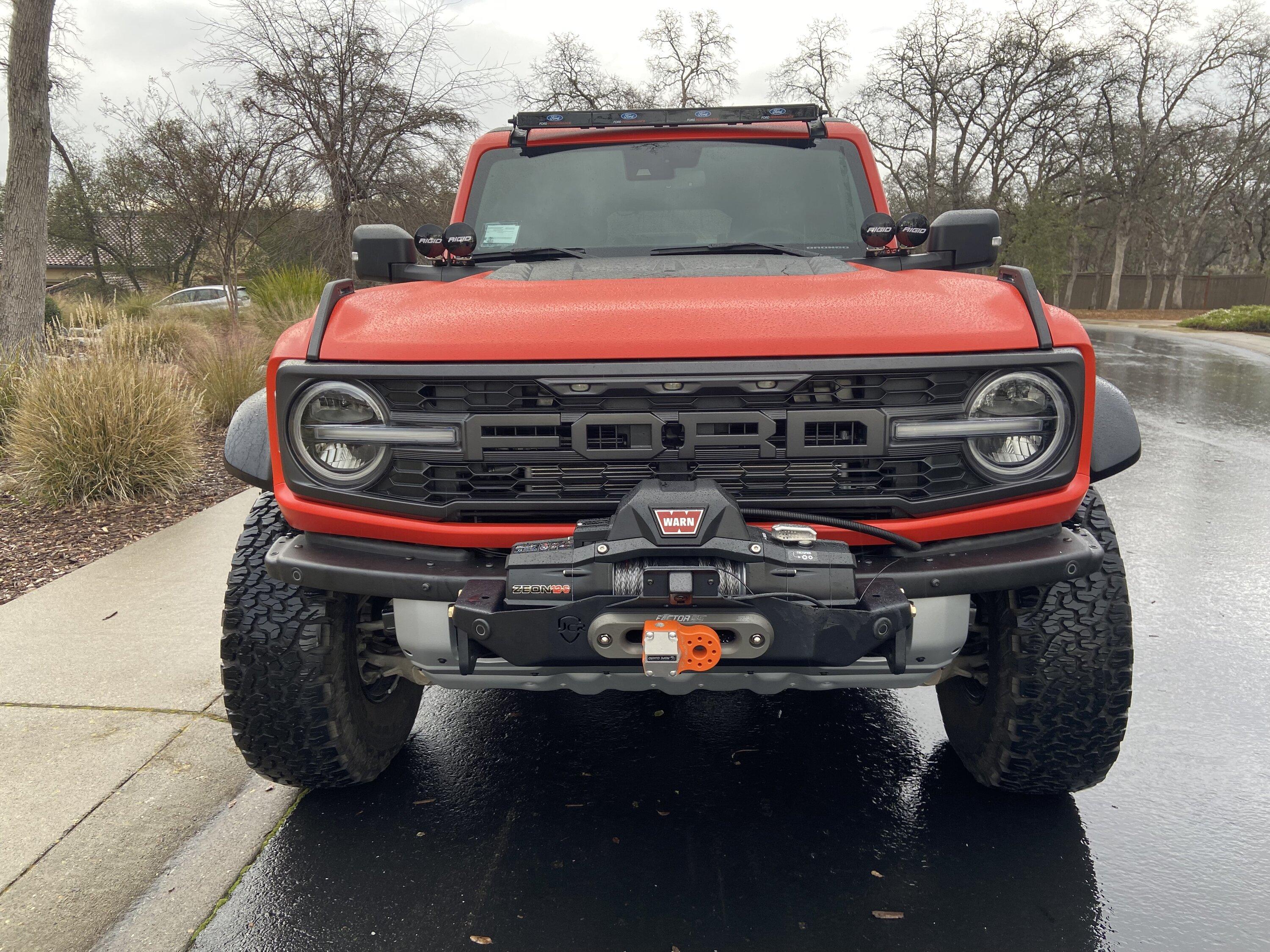

The winch install is almost complete. Just need to put the synthetic line on. I splice wire into the the proximity sensors, soldered it, with heat shrink over it. Also put it in corrugated last tube like factory. Everything is working. Did it by my self and took my time, about 10 hours over 2 days. I was going slow to make sure I didn't damage anything or forget to install something. I took before and after height measurements at front fender flairs. Drop was slightly less than 1/4" with all the additional weight.

Looks good, do you think the camera could be mounted to the Control box where the “W” logo is located?
