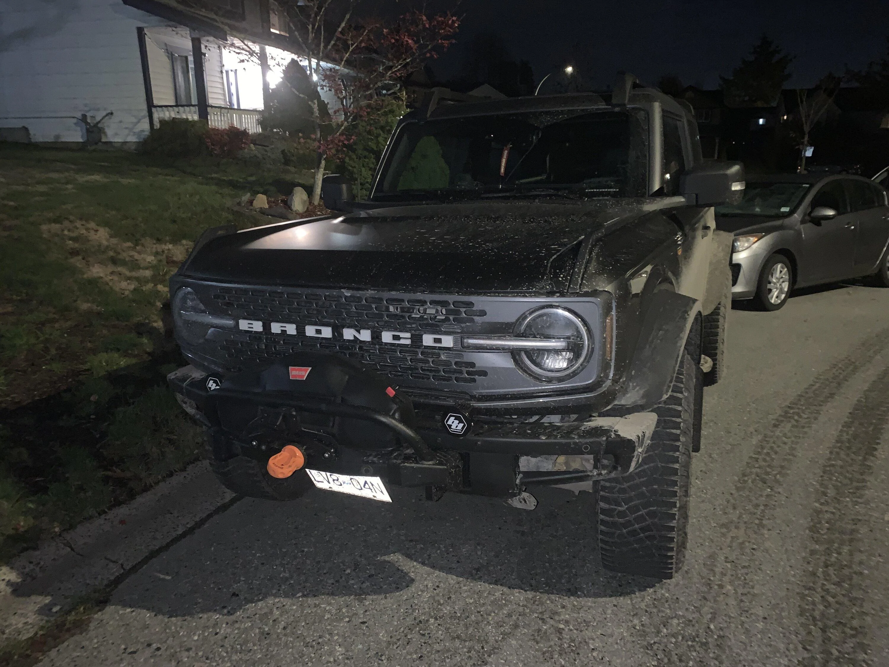

An avid rock crawler from Florida, that's interesting...I live in British Columbia, right between the Rockies and Coastal mountains and have no issues with approach angle with this mount and my D rings fit just fine as well, only mall crawlers have these on when not off roading and the license plate has taken a beating and I really don't care what happens to it, any other creative concerns?

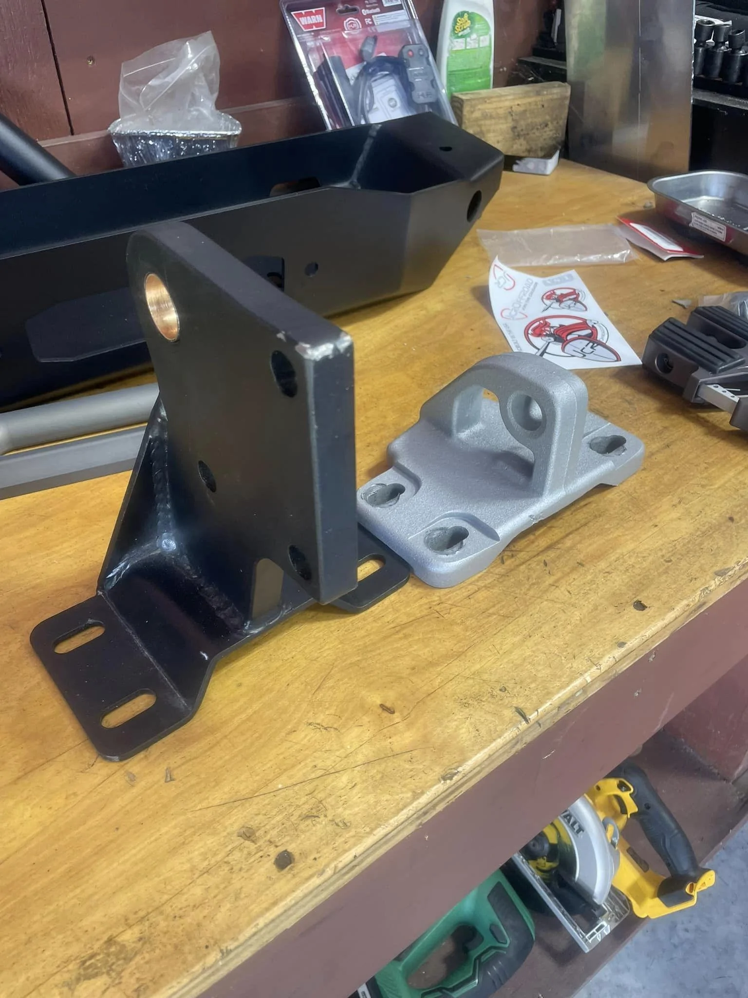

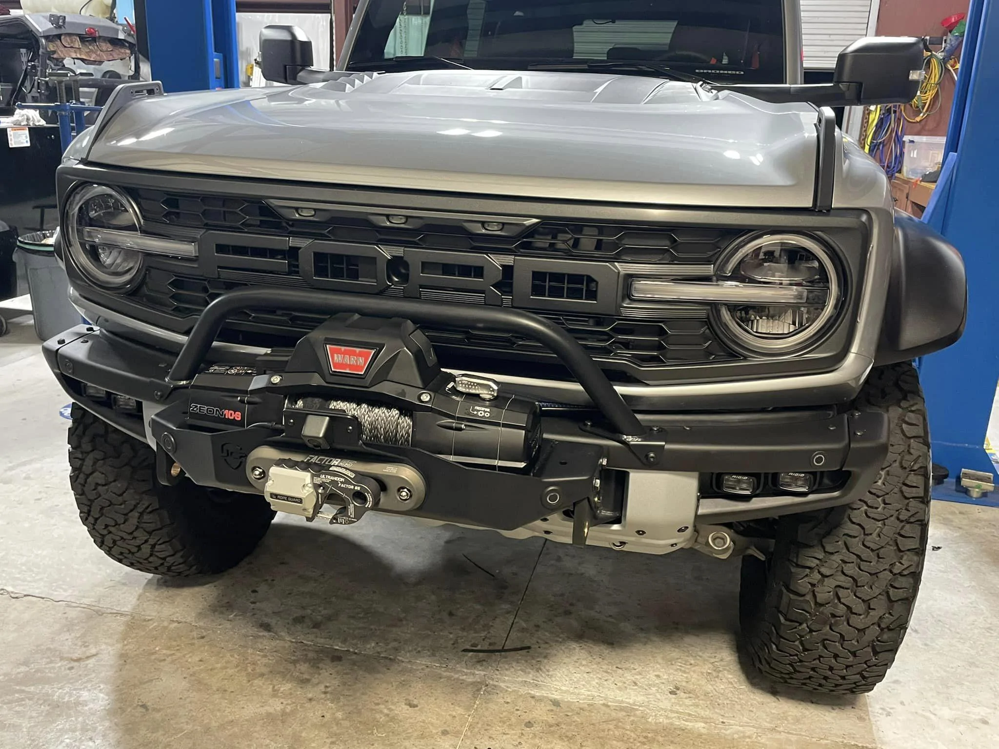

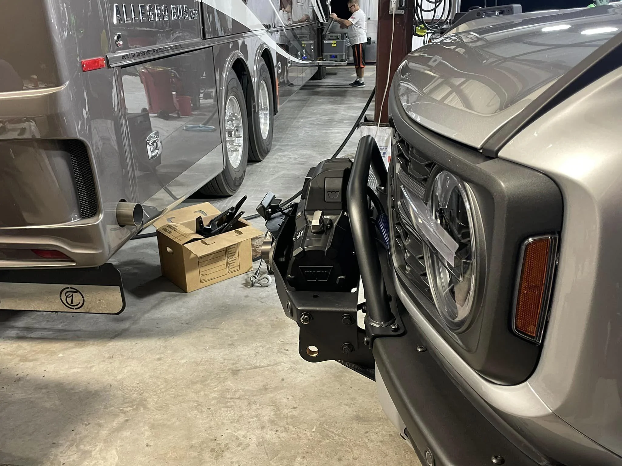

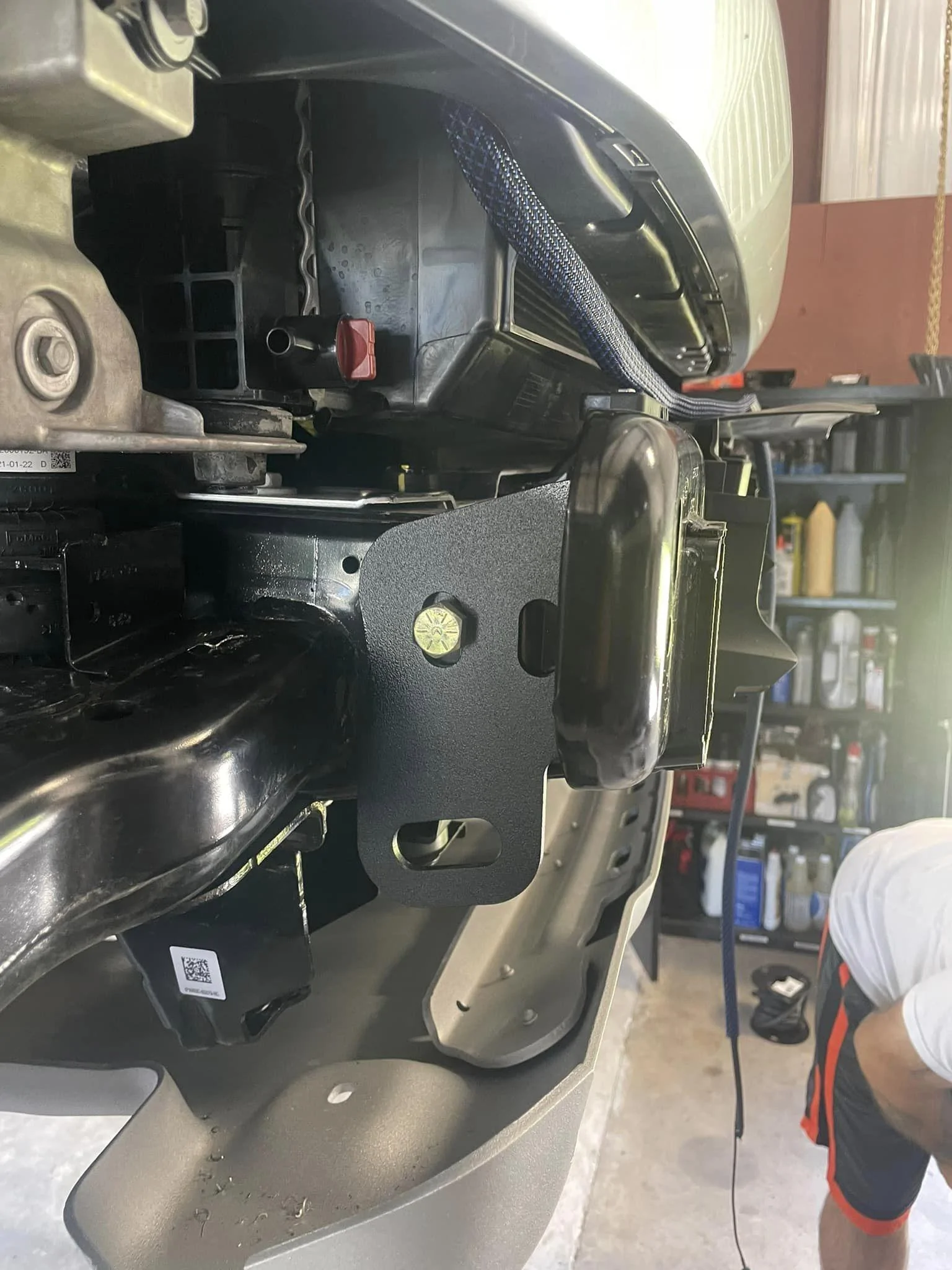

Your kit is spot on for the raptor, directions were correct and pretty easy install after watching video. Thanks for great product plus the bull bar i thought was nice as well. Cannot wait to wheel Raptor and your mount is super strong for flat towing, i did add the Lod rear bumper support for 2nd hooks really, if i break your mount i have bigger issues. The camera relocation was spot on as well, same as the parking sensor no errors from adaptive cruise but have not drove it far lol
Ford Bronco Winch solutions for your Raptor jcr vs factory tow hooks
Ford Bronco Winch solutions for your Raptor jcr winch mount and bar
Ford Bronco Winch solutions for your Raptor side view winch mnt
Ford Bronco Winch solutions for your Raptor lod back bumper brac

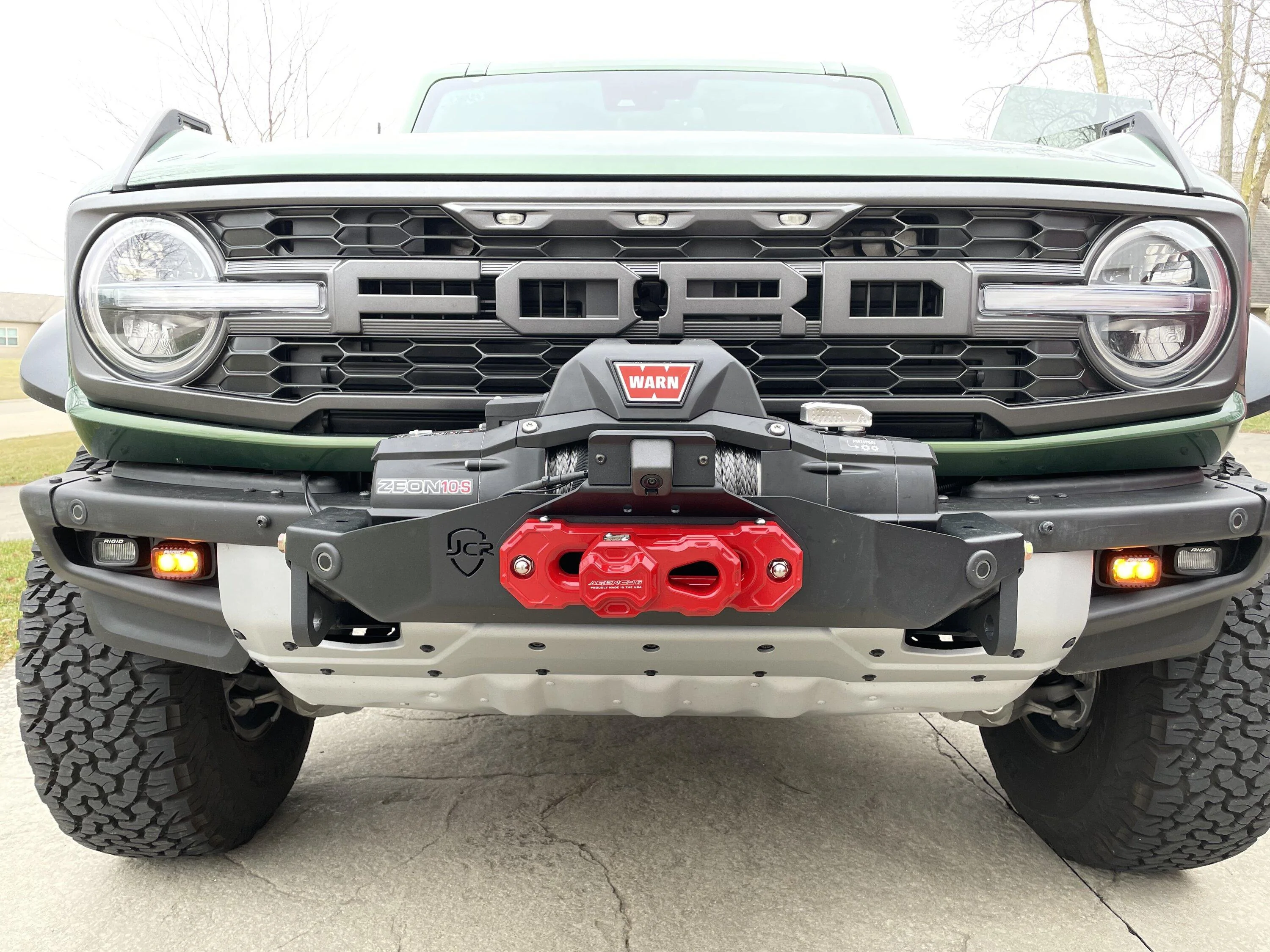

Wrapped mine up this weekend. JCR product is solid. The installation video was great, but lacked the detail for the Raptor. Just a few more steps involved with the wiring due to the additional Raptor style grill lights. Thanks to all who added guidance on this installation above.
