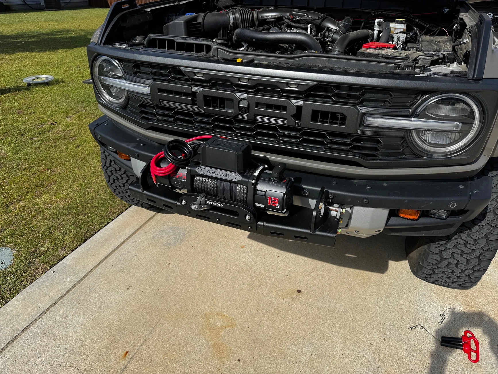

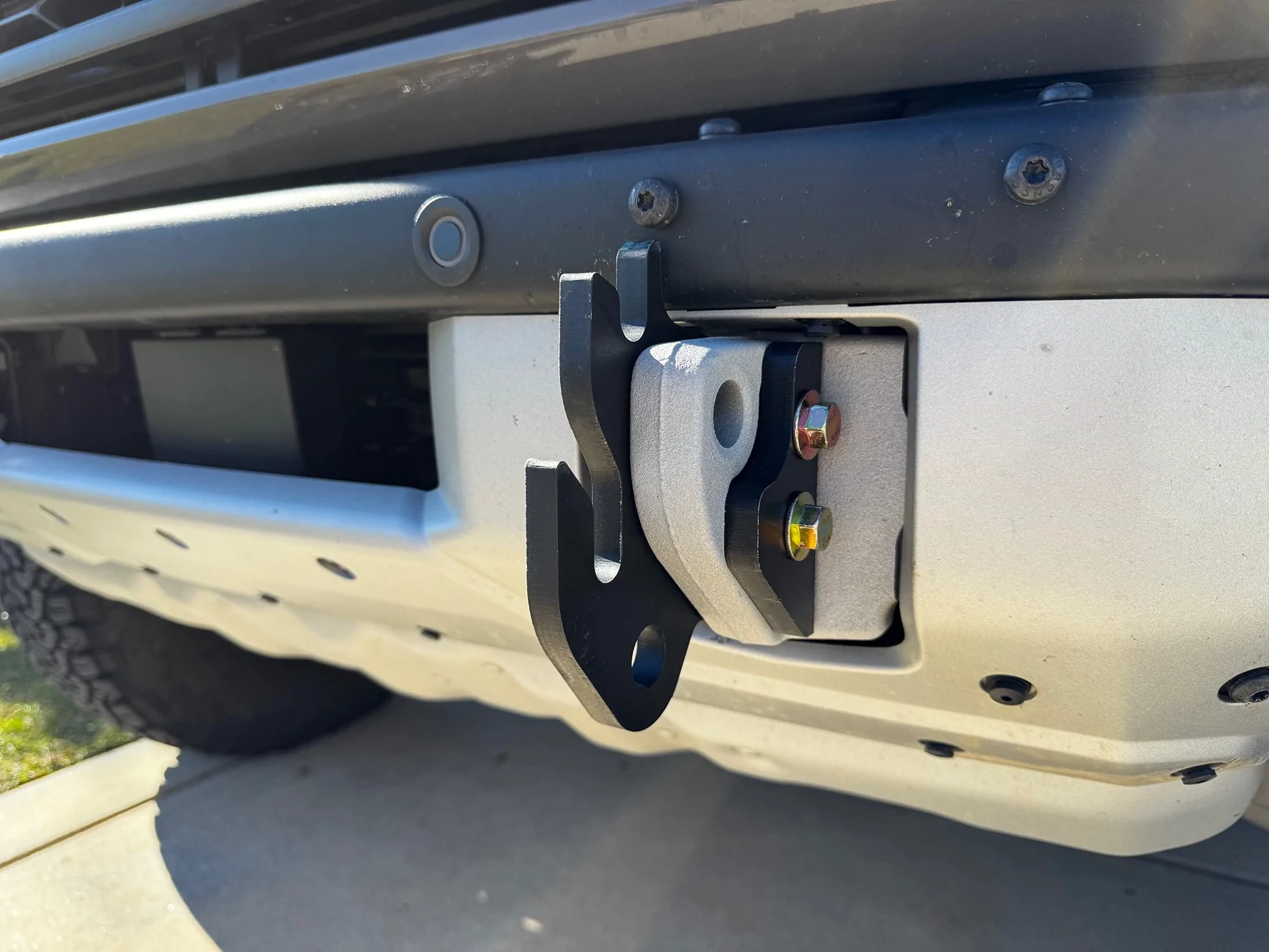

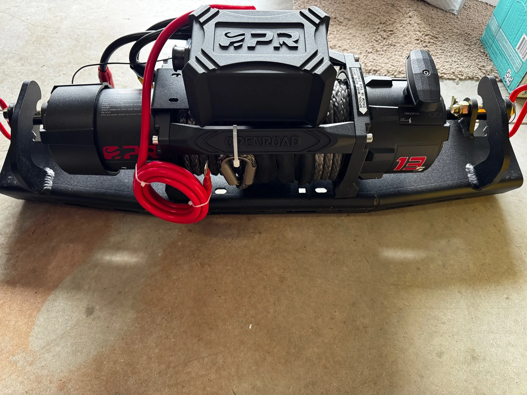

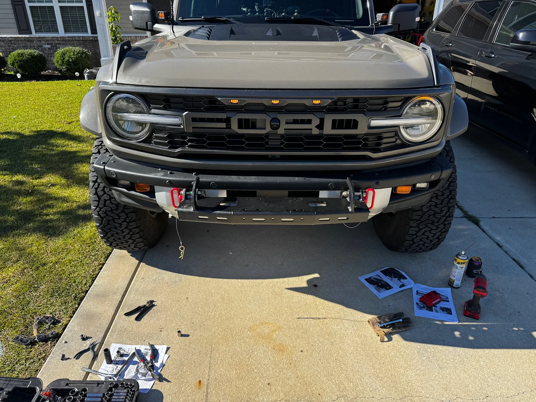

Go @Maximus-3 removable winch mount, and don’t forget the frame horn reinforcements! Winch goes on only when needed, so I didn’t have to move around ACC, sensors or intercooler. I am also not carrying around the extra weight constantly, I strap it down in the back when headed to the trails and put it on when I think I might need it (or need to use it for someone else.) I also did the Anderson quick connect for the power, pop the hood and connect it.

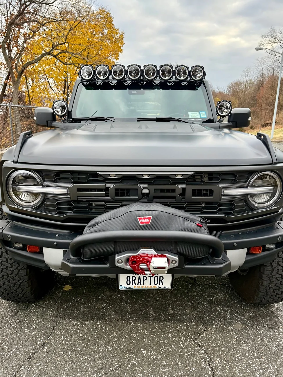

I went with the FP Winch setup (BTW - Ford states that this will not fit on the Braptor) but, if I had to do it again, I would go for the Maximus 3 setup.
my Braptor isn’t my DD and it gets a lot of wheeling duty so the ability to swap on/off as needed is GOLD (for my use case). I would however, need to implement a cable management system because having the wires through the grill really triggers my OCD.
I like the look and concept of this setup. Do you have any links to components required for this build?
https://www.maximus-3.com/product-page/ford-bronco-removable-winch-mount
I added both the reinforcements and battery quick connect, so that it came as a package.
https://openroad4wd.com/products/openroad-13-500lbs-winch-with-synthetic-rope-panther-series-3s
This is the winch that I went with, but options for that are endless. You’ll see on the Maximus-3 website that you can order a complete package winch included.

I have not had to use the winch yet, but I did spool the line out and in to make sure everything functioned properly. I just have the battery side connector coiled and tucked next to the battery, to use it I just pop the hood and connect. I have driven with it mounted some, front camera is still useable, but you will see the winch in your view. I did not weigh the mount and winch, but it is not difficult for me to carry and get mounted in the cradle or loaded into the back.
