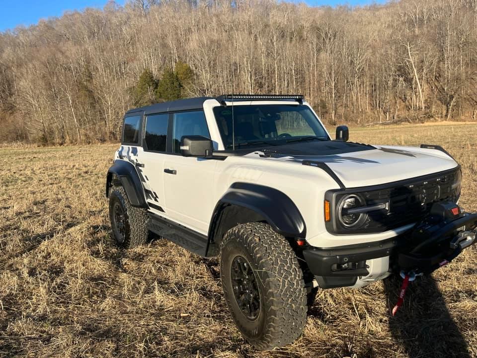

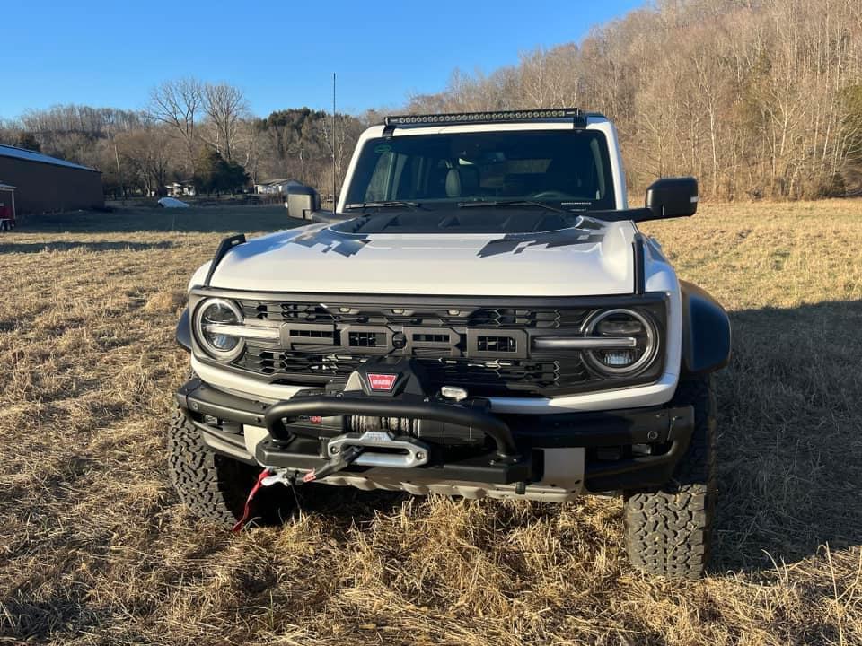

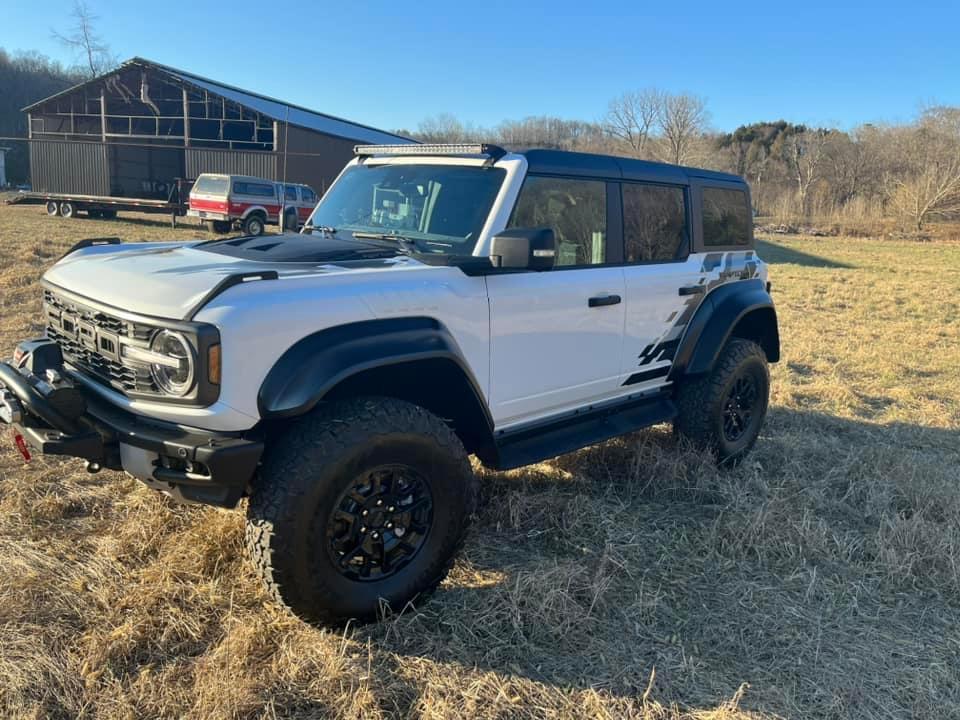

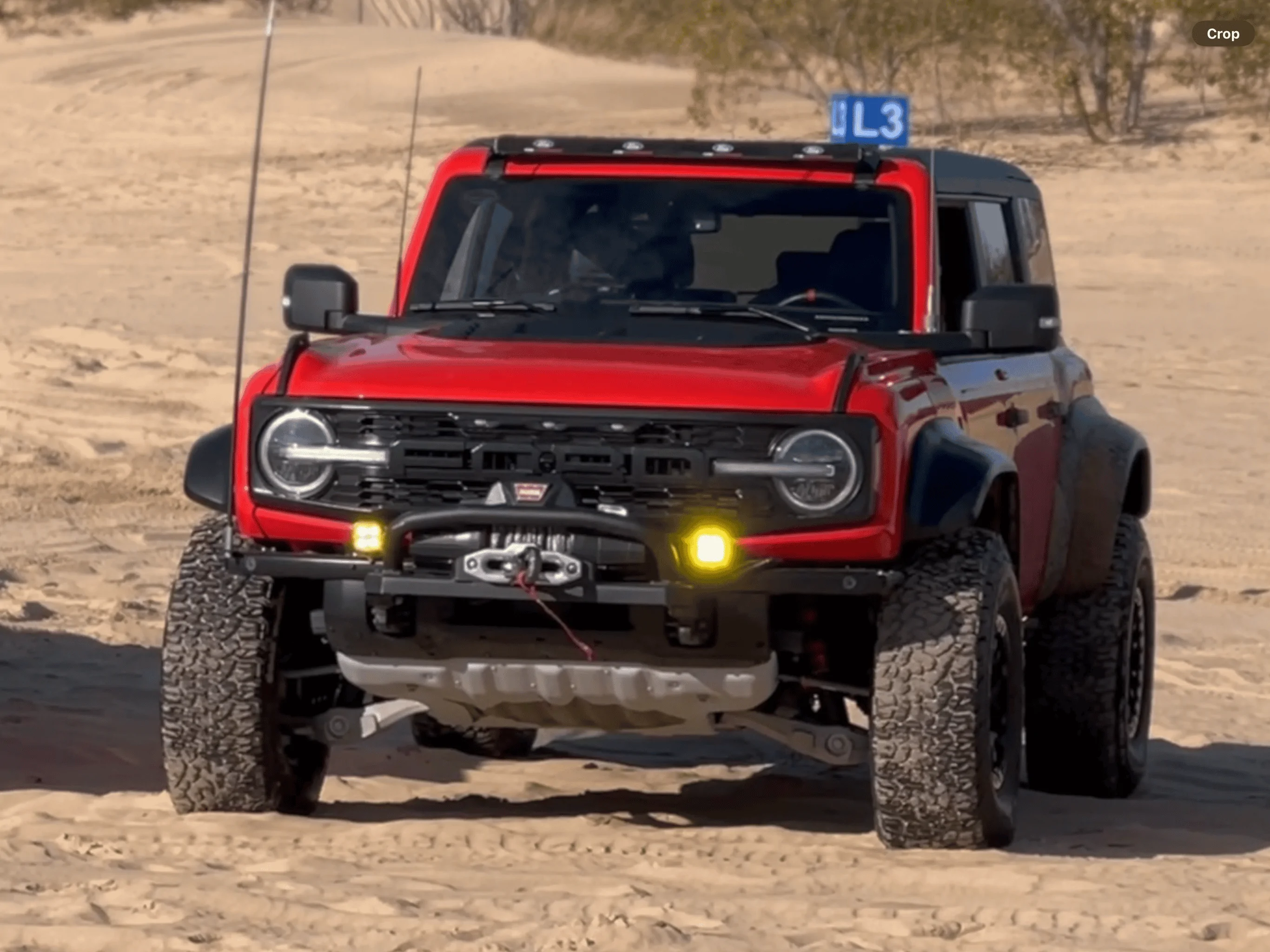

I’m confused. Ford Performance has a Warn winch solution that clearly says it will not work for Raptor and yet, I’ve seen multiple people install it on their Raptors.
Winch: https://performanceparts.ford.com/part/M-1821-B
I am interested in purchasing one. Why does it say, “Will not work for Raptor”?
Is it because of these reasons?:
1. front camera is blocked
2. radar for cruise control is disabled
3. front sensors need disabled
This guy on Facebook had a dealer install the winch and everything looks fine. Is there something else to be concerned about?
I also saw a guy with one installed running at Silver Lake State Park. Didn’t seem to stop him from driving hard in the dunes.

Yes. This is why Everglades only came with “Mid” options package. Ford just took a hard pass on dealing with these issues.
I went with JCR winch plate and everything works perfectly, they also have a bull bar option if I recall correctly

4. All of the above.

its more an issue with LUX package and ACC hence why I didnt get LUX.
