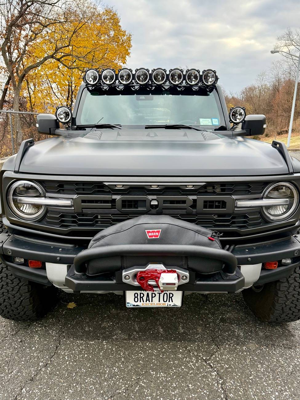

Fits like a glove!

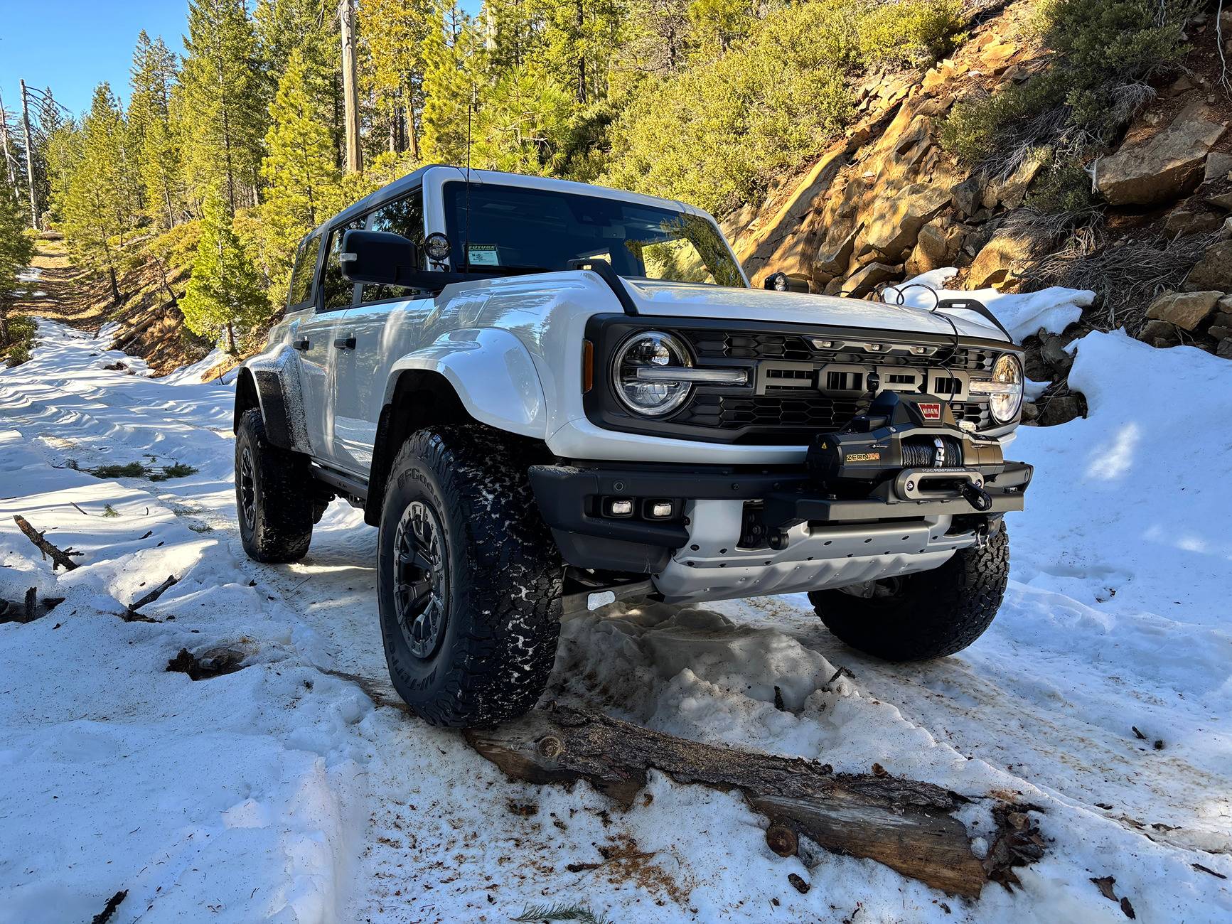

Sensors can be relocated as well. The ACC box does not need to be moved. Mine functions as normal in the original location.
Ford Bronco 2024 Raptor winch IMG_0552
