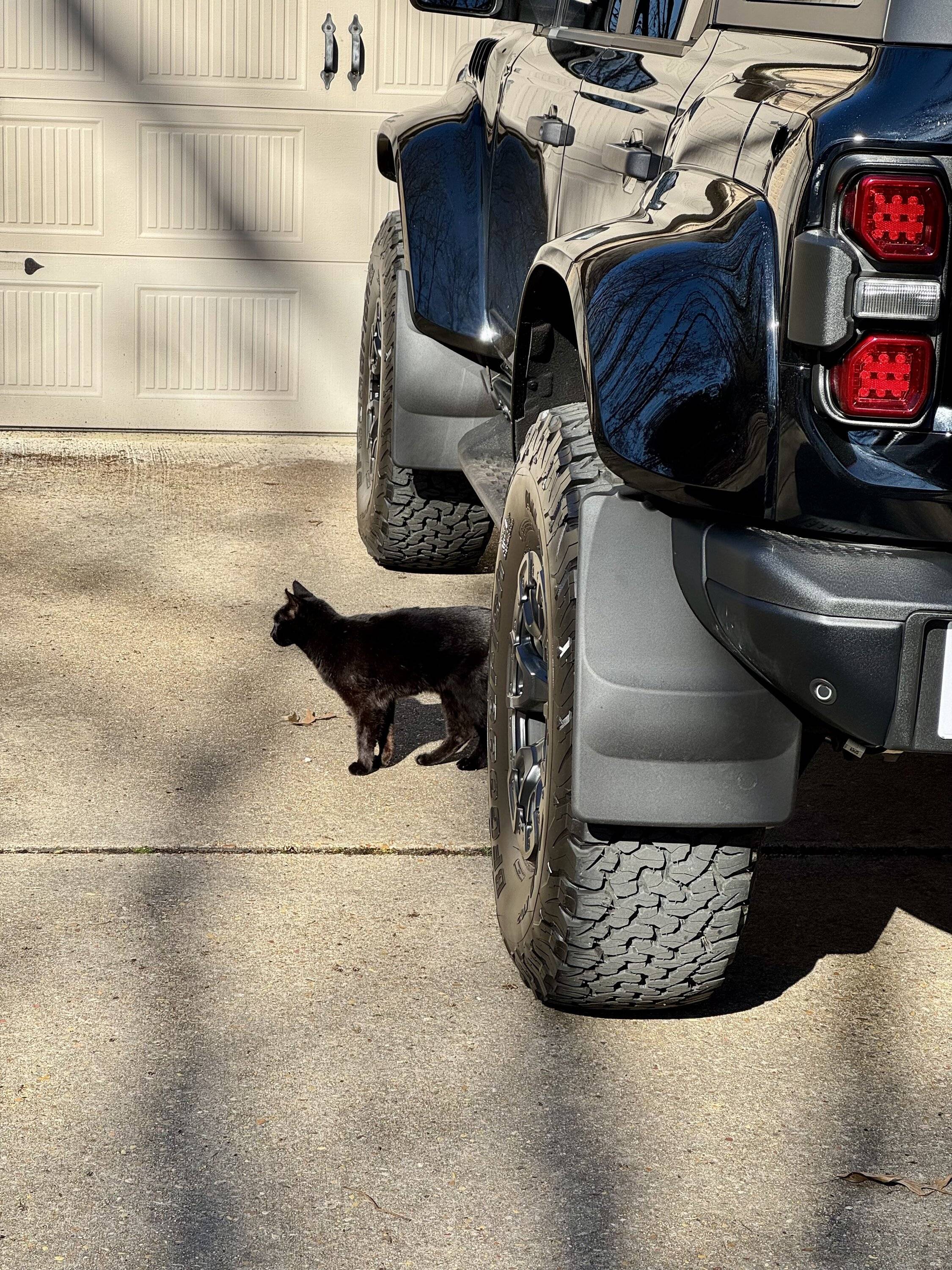

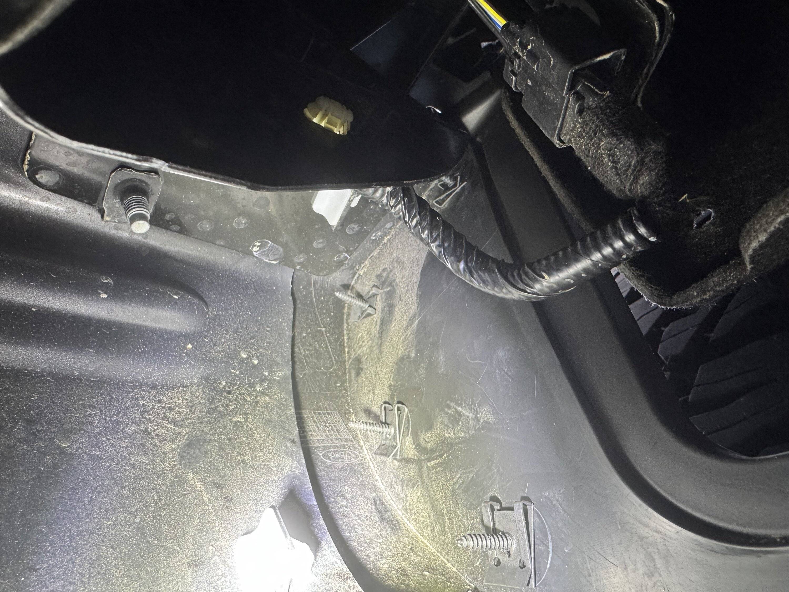

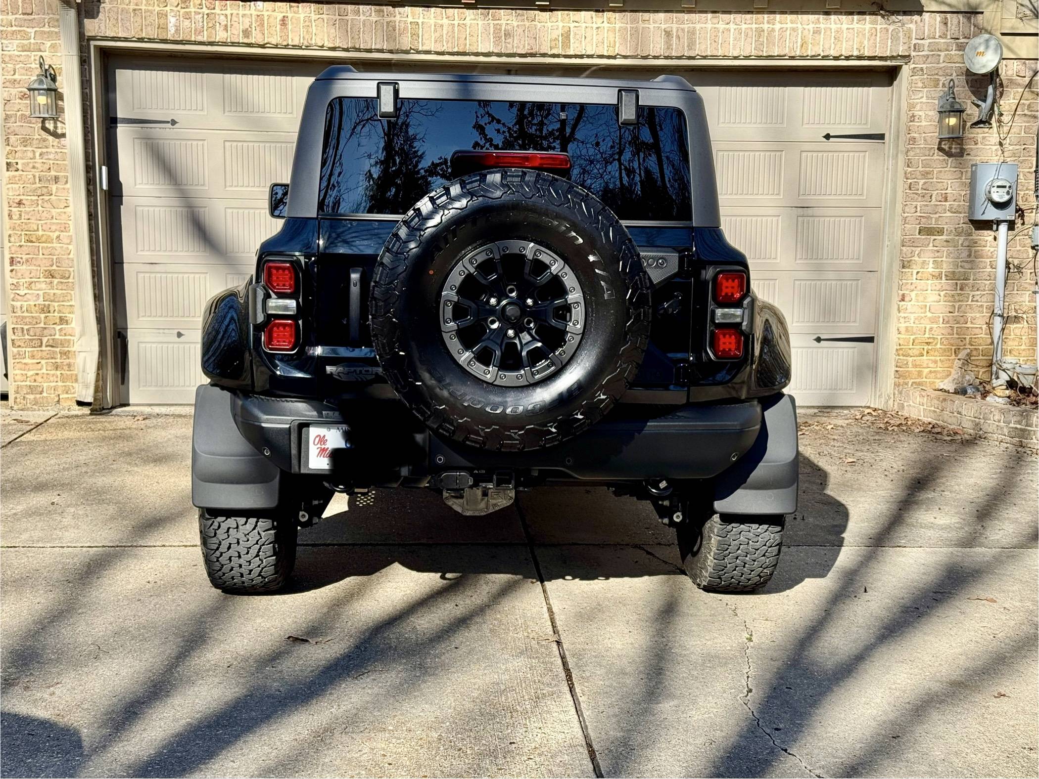

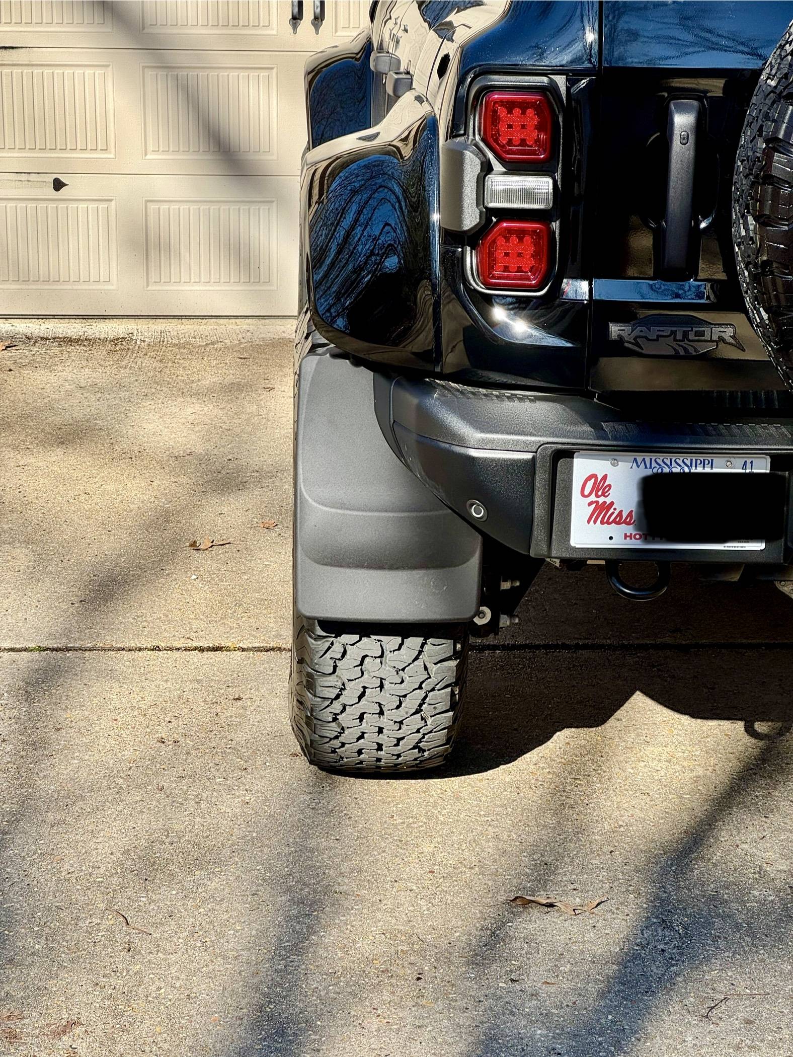

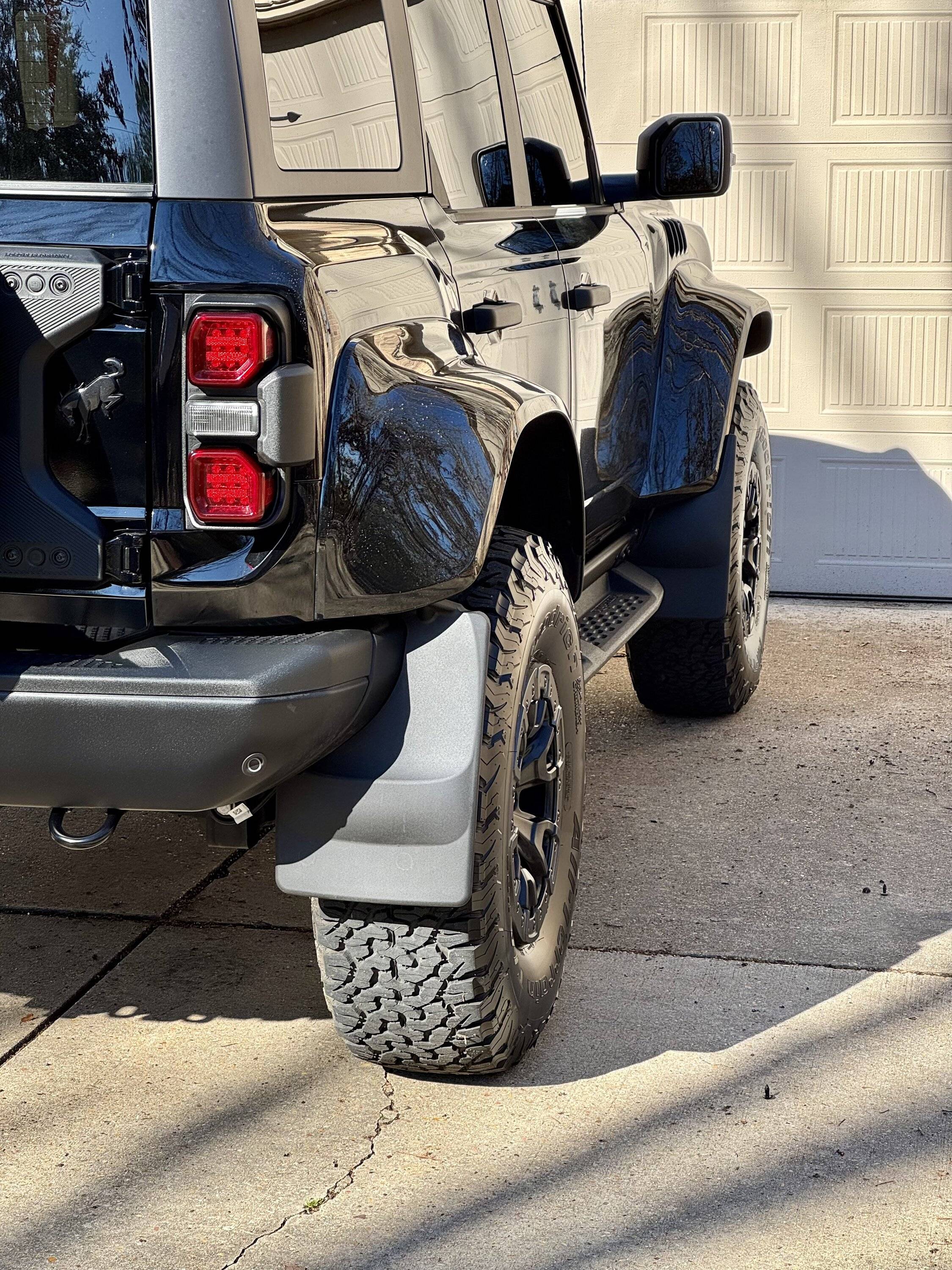

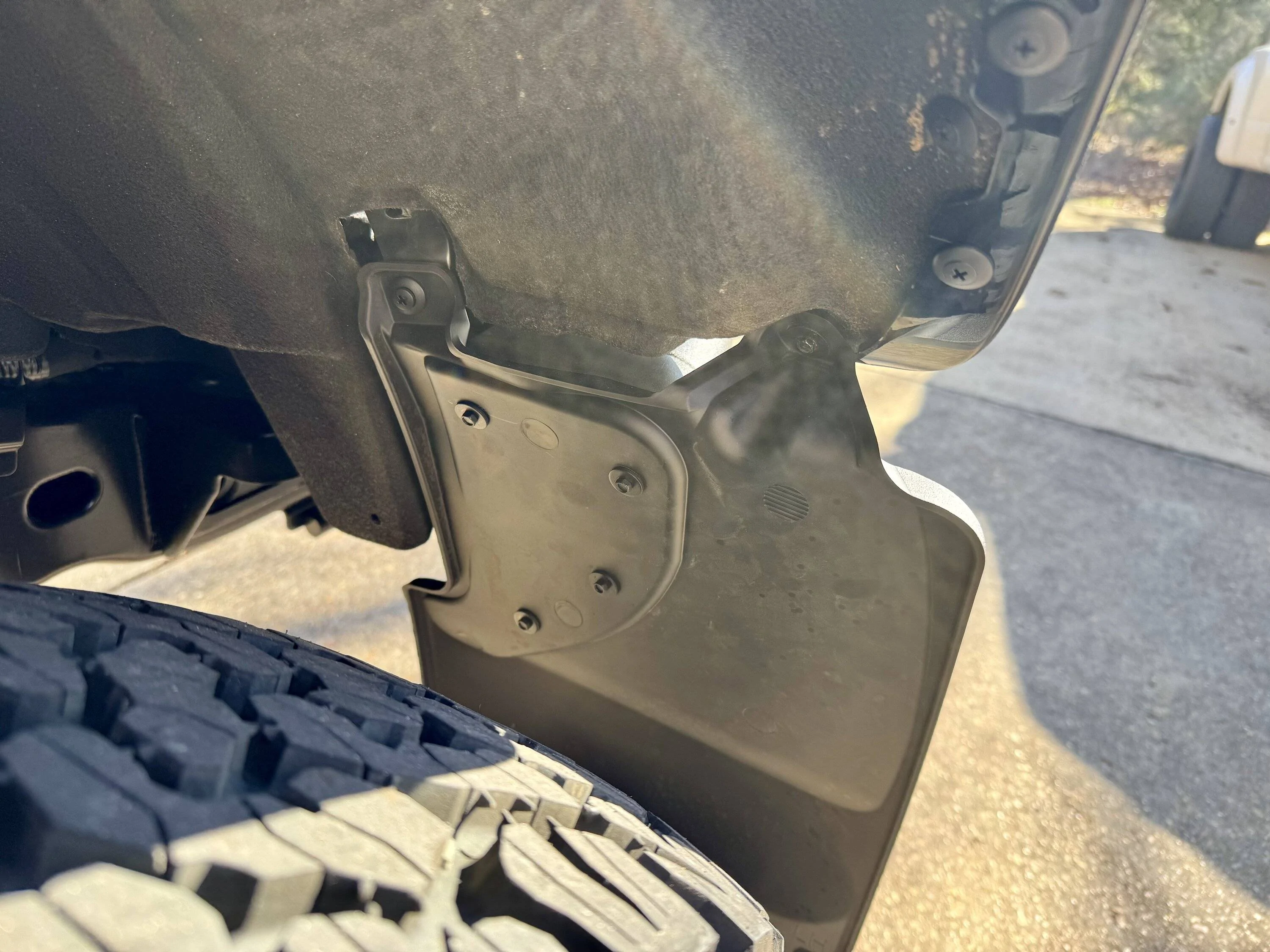

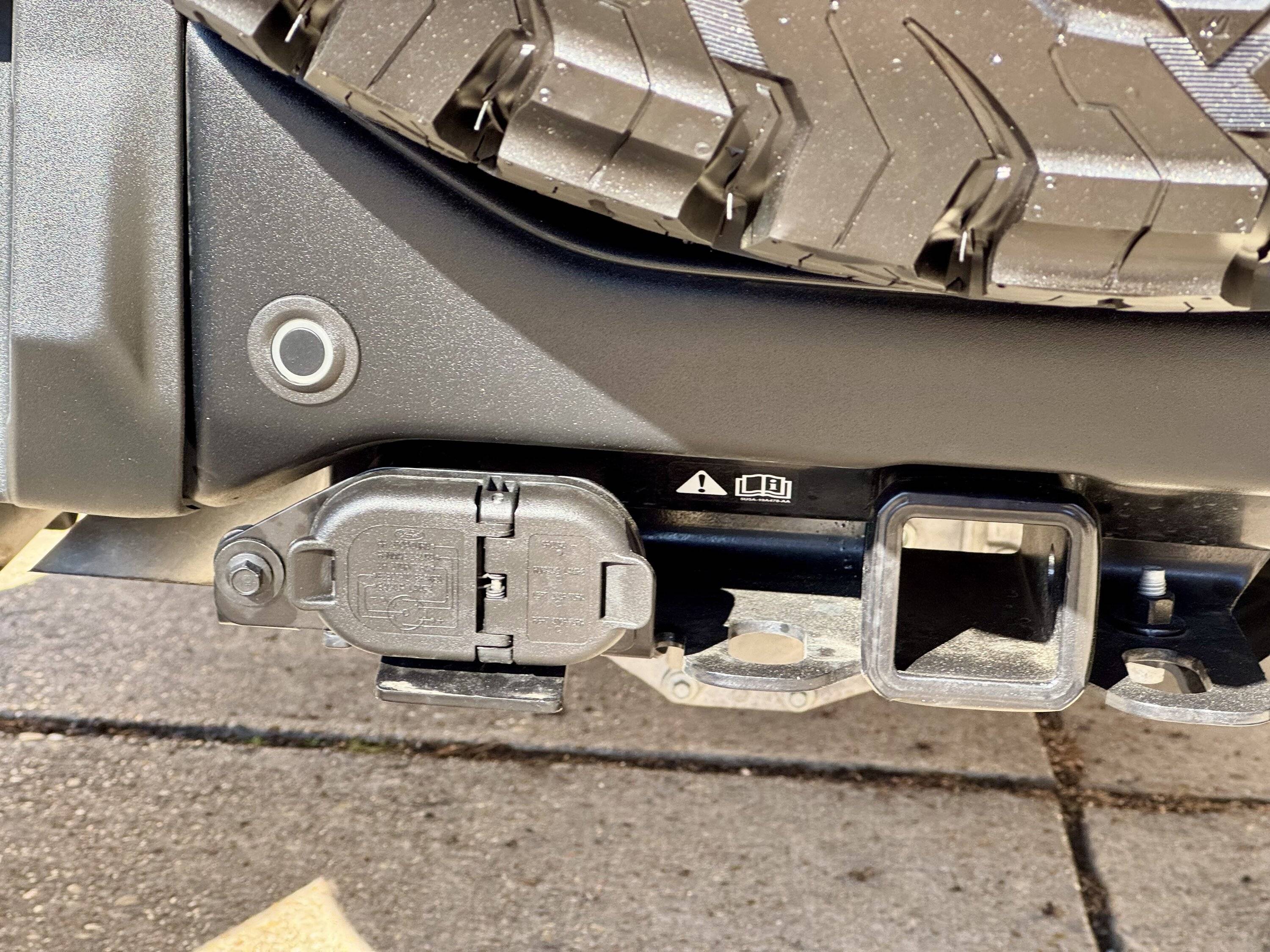

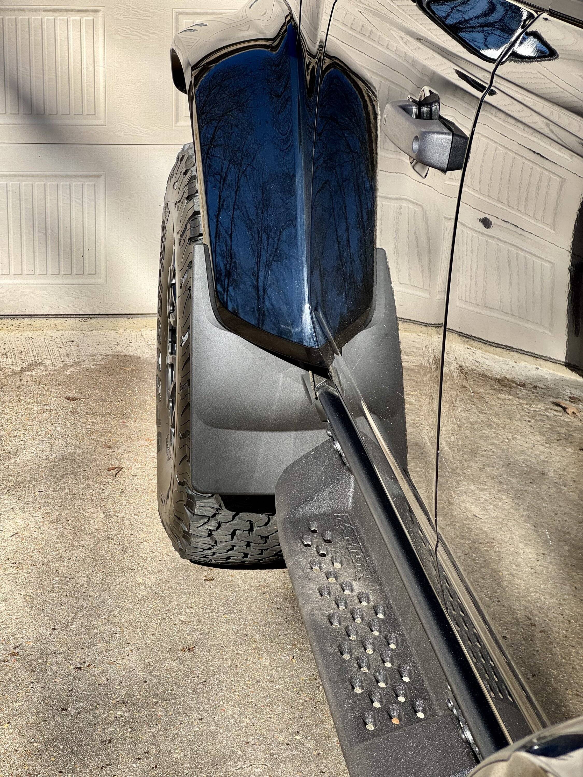

Quickly realized the door spray was going to be an issue so we ordered the weather tech mud flaps. No drill is a stretch for the rears. Fronts were simple to install. Rears require four screws to pierce the plastic bumper cap behind the mud flap and a speed nut to be placed on the threads on the back side. Maybe on a lift this would be a one person install but on the ground it took my wife to hold the speed nuts as I could not get my hand inside the bumper access point. I used a right angle adapter for my impact driver which made the process quick and easy getting through the plastic with the wheel on.
Definitely not as sporty as the og raptor look. But overall function will hopefully overcome any loss of coolness.

At least the cat approves.
I've had Weathertec's on my Bronco for almost 2 years now. The fronts started to rub out of the blue about 6 months ago - not sure if it was just my tires wearing and now starting to catch, or if the flap moved, or what.
Entirely agree about the "no drill" thing. I guess it's technically true...
I do catch them on rocks. I've broken/lost half a dozen of those clips by now - but no damage to the flaps or the fender wells. They do look like someone took a cheese grater to the bottom edge of them.
The don't come fully clean any more - kind of stained. Have the same issue with the floor mats, can't ever get them entirely back to black.
I ended up replacing the fronts with Broflaps just recently because of the rub, but left the rears on for now.
I do like how the WTs extend outward a bit to help with the splash, but my Mickey Thompsons love to throw stuff up and over, so it only does so much good.

She doesn’t approve of much. Lol. Awfully bossy for a rescue.
Great intel on the user experience. Thanks for sharing. Adams polishes makes a floor mat cleaner that works amazingly well on the weathertech floor mats. It likely would work on the mud flaps as well? Just a thought.
