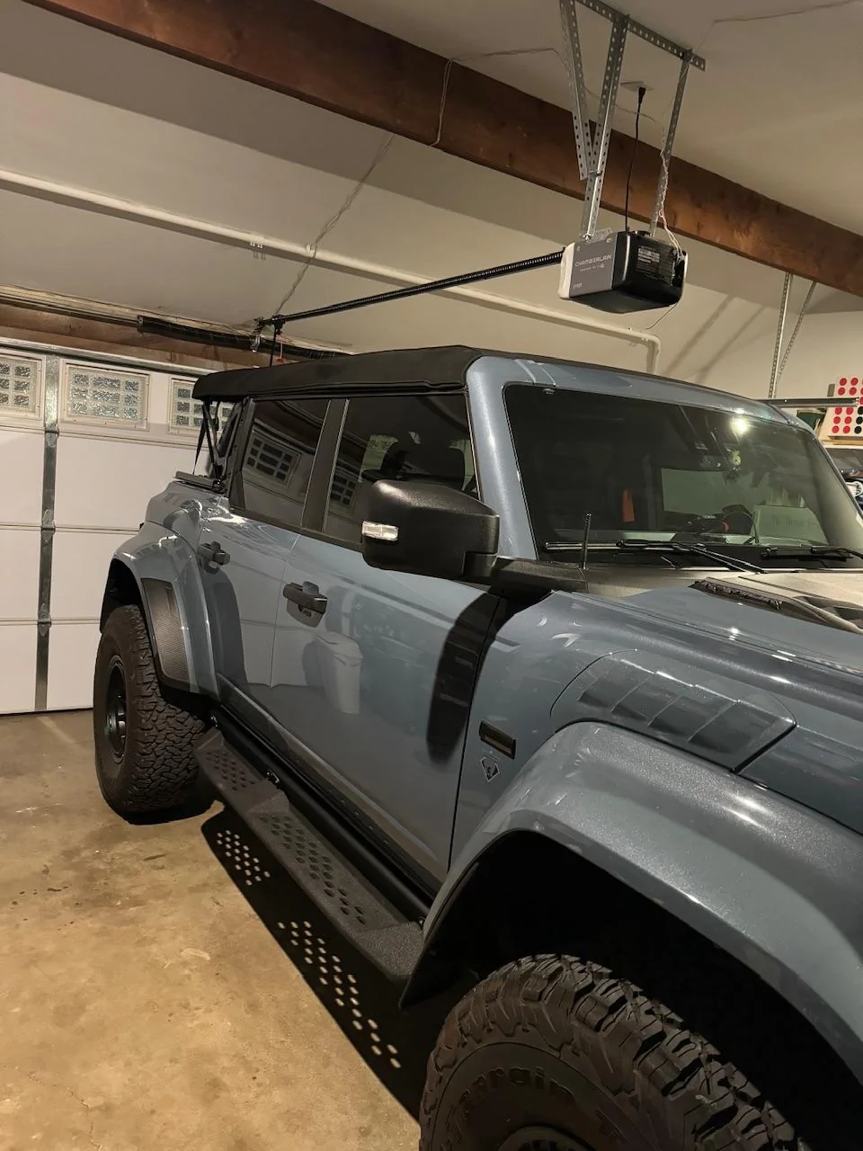

OEM top that comes from the factory (not the Bestop after sales top) fits perfect. Make sure it is the right top. It has to be the top that comes with dual top models or someone who just removed their OEM top.

+1 it fits I just did this a few days ago. Nothing different than the standard Bronco. As others stated it has to be the OEM Ford soft top that comes with a dual top purchase or taken from a stock soft top Bronco.
Read the thread of “lessons learned when swapping to soft top” ( sorry don’t remember the exact title) it’s immensely helpful!
