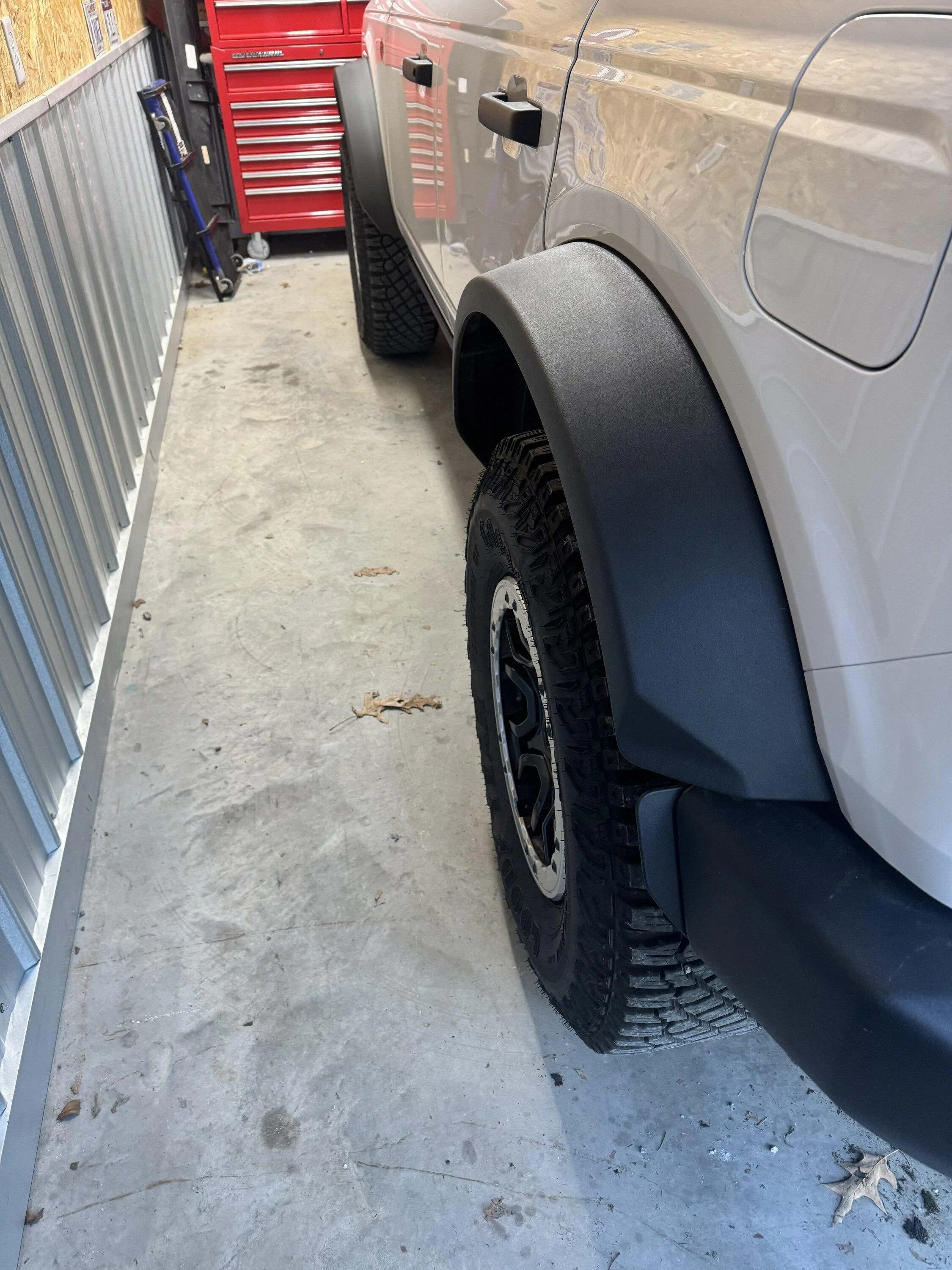

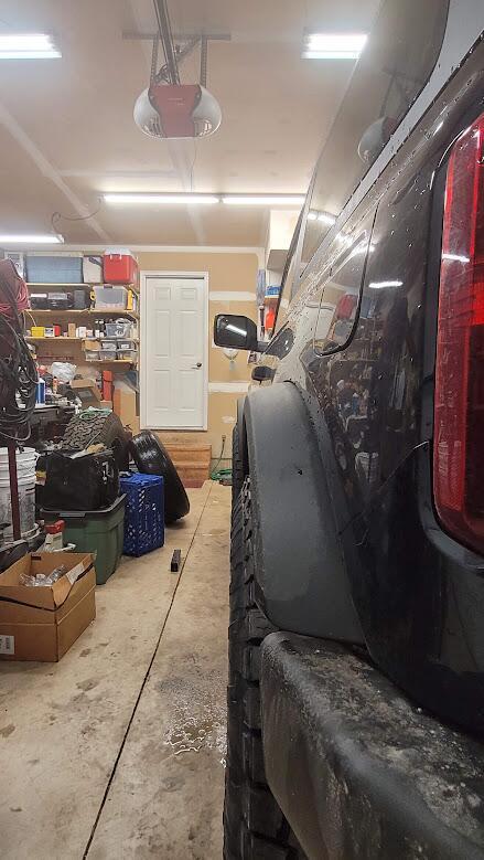

I am getting ready to order a new set of wheels and tires. I'm sure this has been addressed and answered. But what offset would be best for the wheel and tire to be flush or slightly inside the fender flare? I don't want it outside the flair. Also, I'm considering using a 10" rim.
2023 Bronco Wildtrak. Sasquatch package. Stock height currently
Please and thank you for your information

Depends on the tire size ultimately.
For the typical 8.5" rim you're looking at an offset between 0 and +30. At 0 offset, the wheel itself will be roughly in-line or slightly in (varies on the wheel design) from the fender, but the tire itself may poke beyond the fender depending on the tire size.

9” rim will push them out 1/4”…I’m gonna say +18-+12…depending n actual tires ya use…

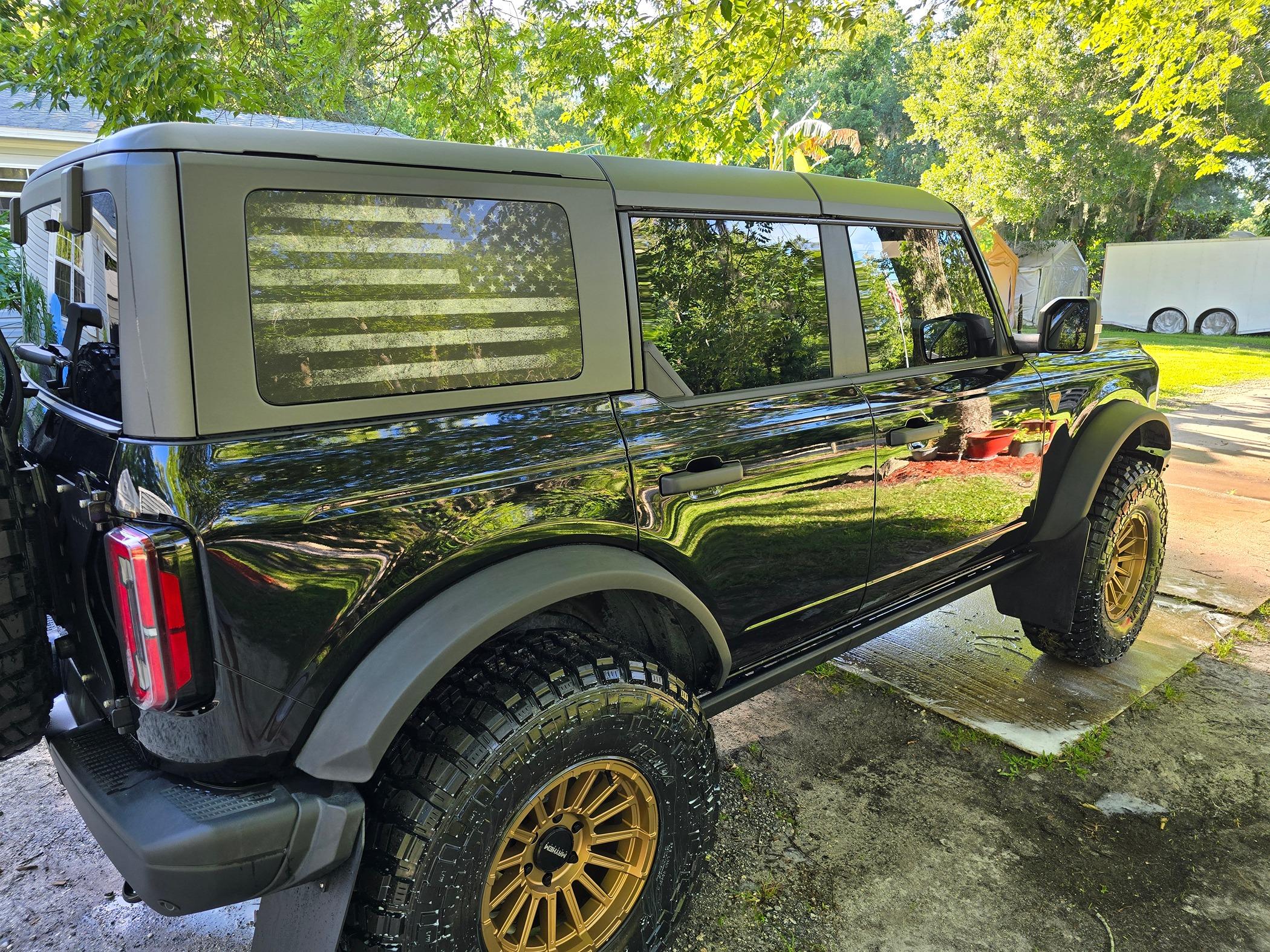

Method 703
17 x 8.5
+30mm
35 x 11.5 - 17
standard flares

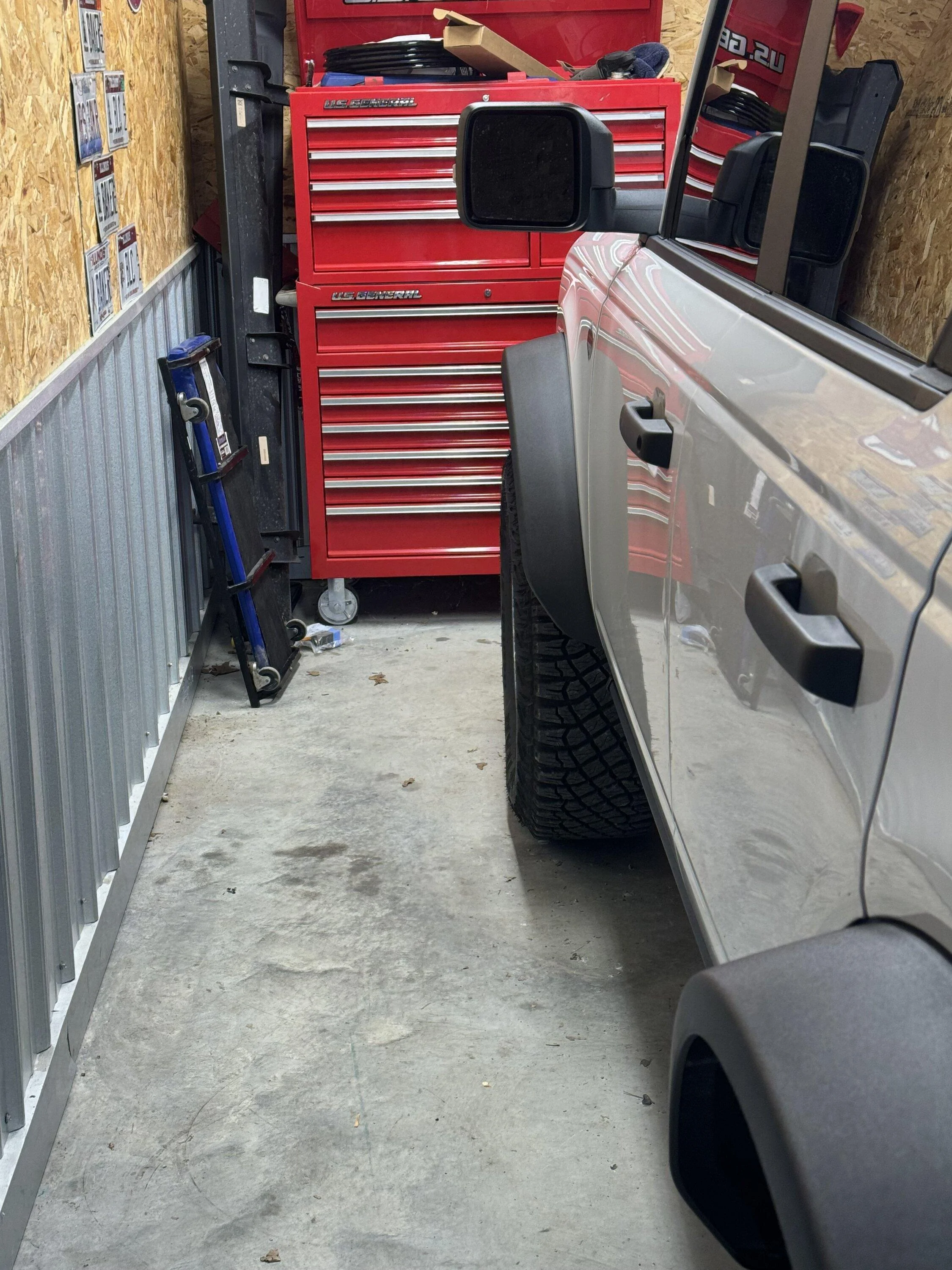

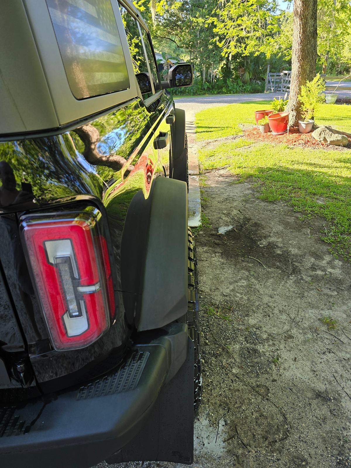

This is on a Badlands with SAS , so larger fenders .
I am running 37x12.5x17 Kenda Klevers on a Zero offset 8.5" wheel

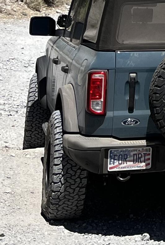

8.5 with +12 for Squatch fenders... Zero has a small amount of poke. You can also do +25 if you want them to stay slightly under the Squatch fender.
